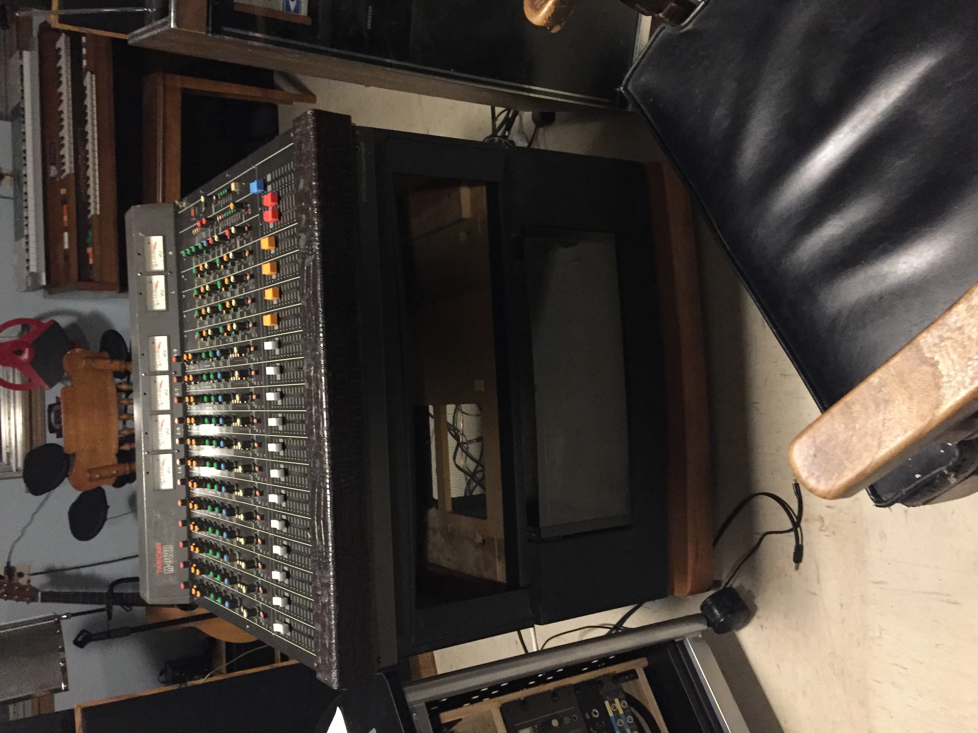

alright..... The last few days have been putting the mixer back together and starting to run it through its paces, and working a bit on its desk...... along with household chores I was supposed to do long ago..... (....man these man caves are awesome!!!!).
I thought I'd mention the desk a little bit. Being a solo act, I was having a hard time trying to figure out where I could record, and check the levels and do the adjustments etc..in my new <gasp... I hate to use the word..... > "studio" layout...... then along came this $2 beauty..... on rollers!!!!.

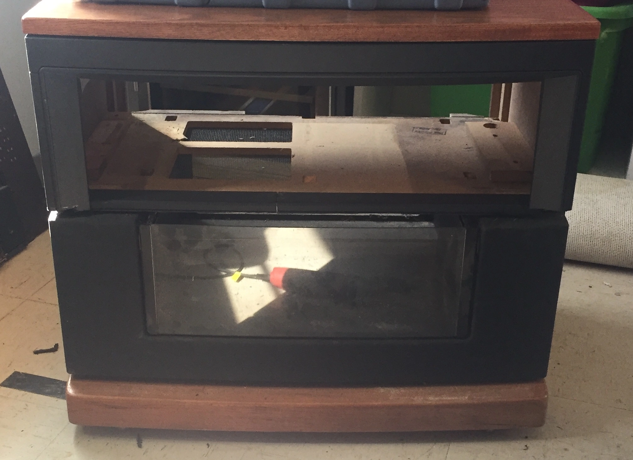

...well a little implosion exercise and surgical work with the circular and oscillating saw and I ended up with this:

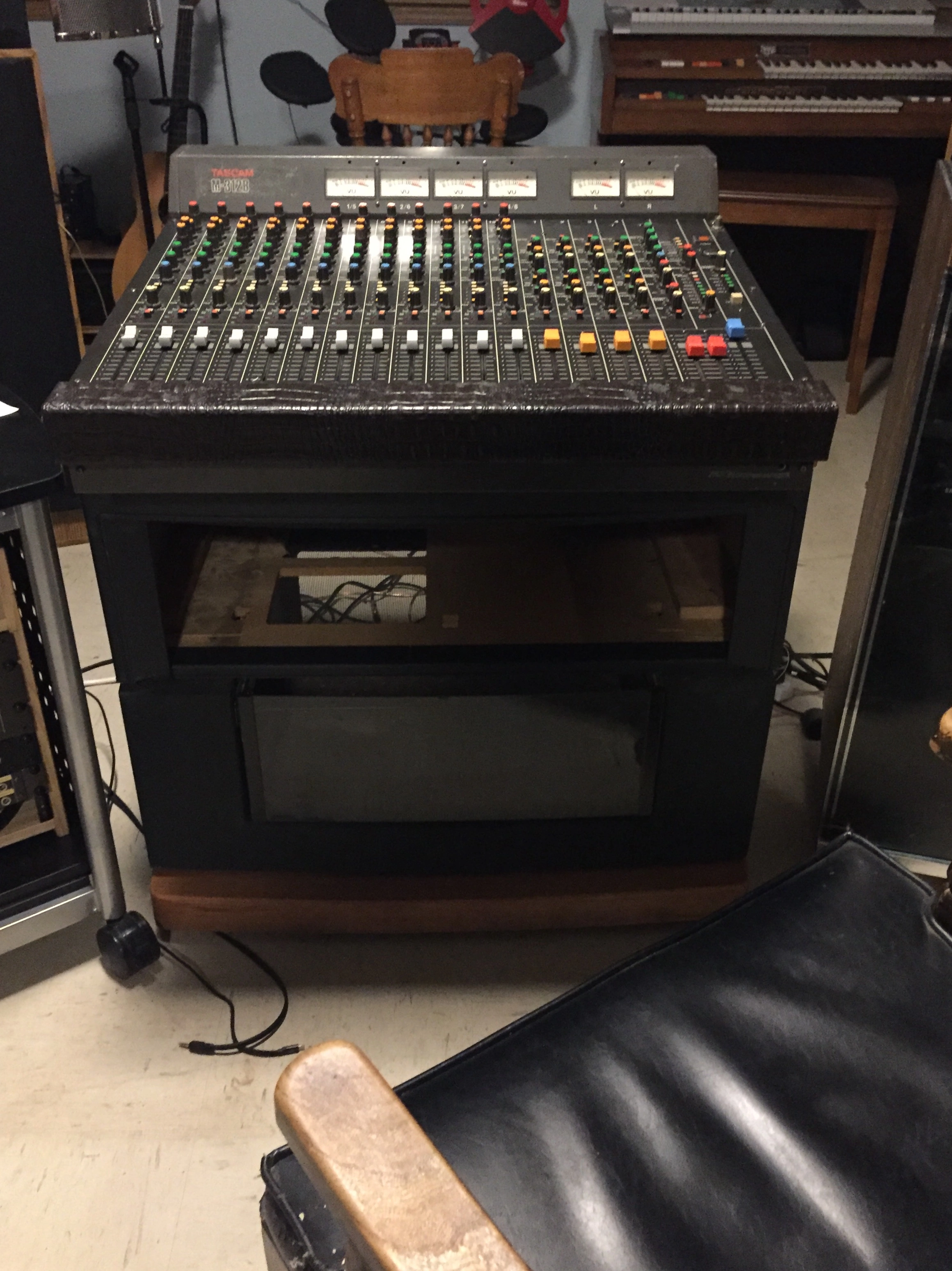

It actually will have more rack space than what I have now..... kinda a "going mobile" on steroids. Here is the finished version (I still have to install the rack...maybe tomorrow since the temp is supposed to be 48F with 40 mph winds.....)
The beauty about this is all I have to do is unplug the monitor outputs and everything else will be contained in the desk. I can wheel it over to my recording area and get levels and adjust as needed.
I'm thinking about adding a trailer hitch and starting a new "going mobile" thread :D
