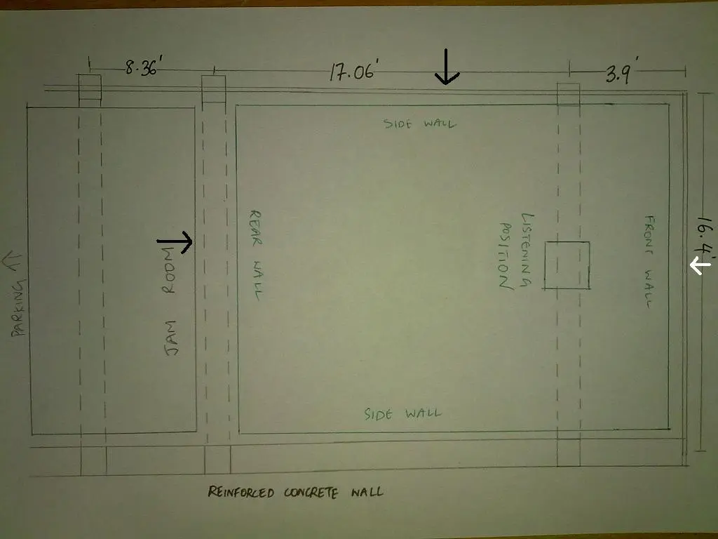

please have a look at this:
the door could go on either of the two walls marked by the black arrows.
and i am hoping to maybe place a window on the wall marked by the white arrow, thats the direction the sun comes up in the morning.
would it work?
thank you:)
Can you get into the Jam room through the side wall as well??
If you loose the door at the rear of the CR, you could have a window in the front. ;)
cheers,
John
yes, entering into the jam room isn't really a problem.
okay so the door on side wall of CR, where exactly plz?
and window, of glass or wood?? how big could it be?
also would facing towards east help minimize reflections due to the beam??
or would it be better to face the other way?

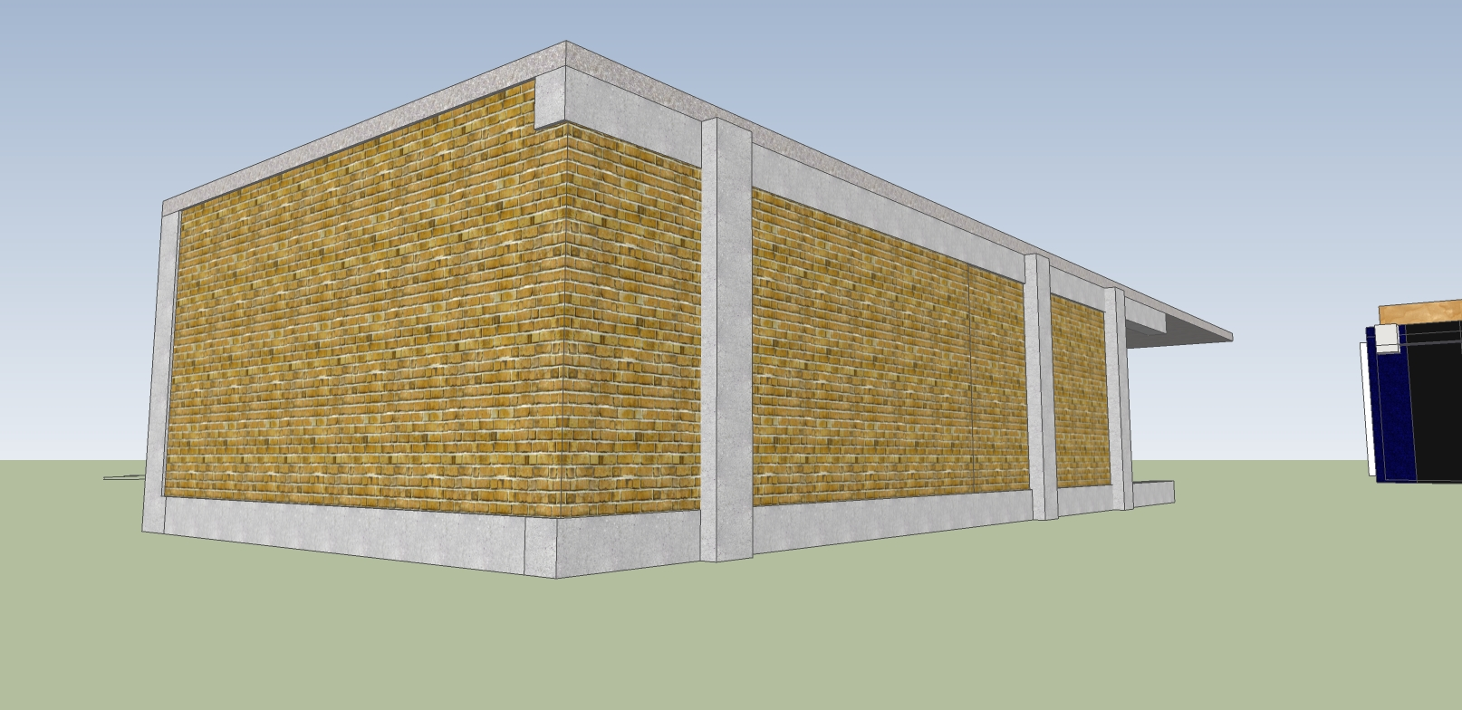

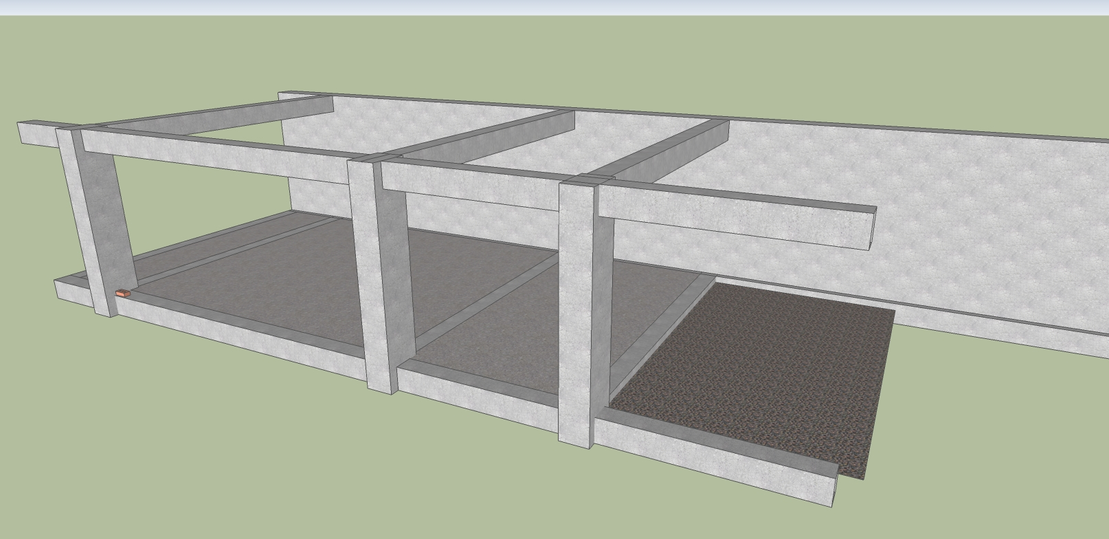

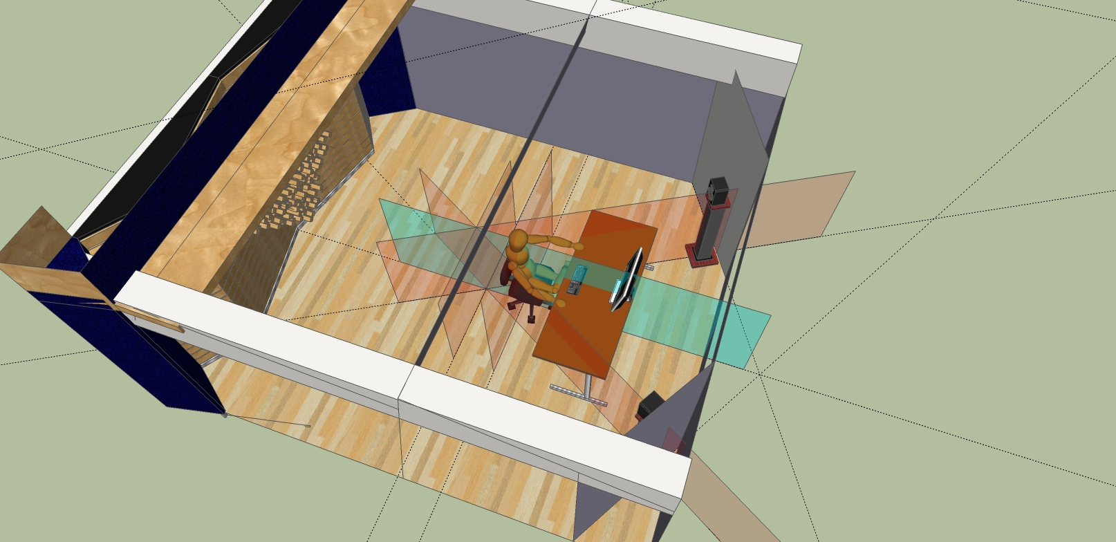

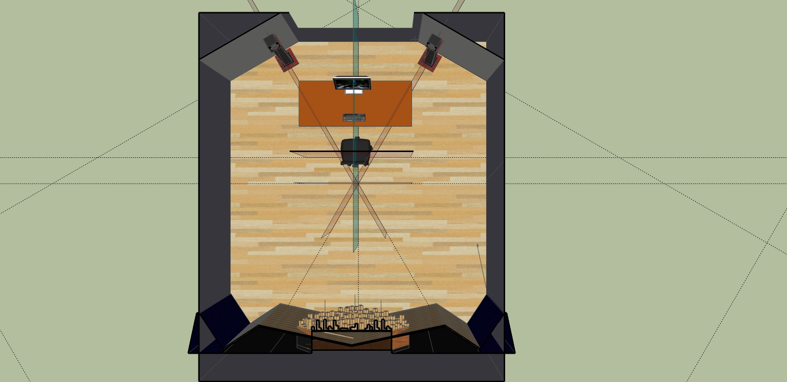

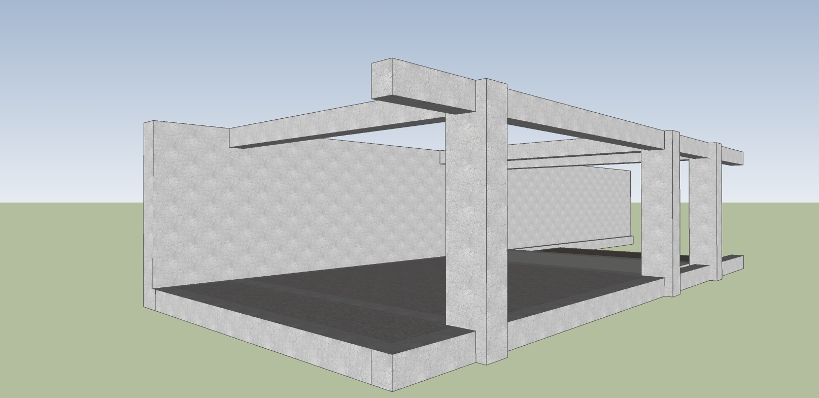

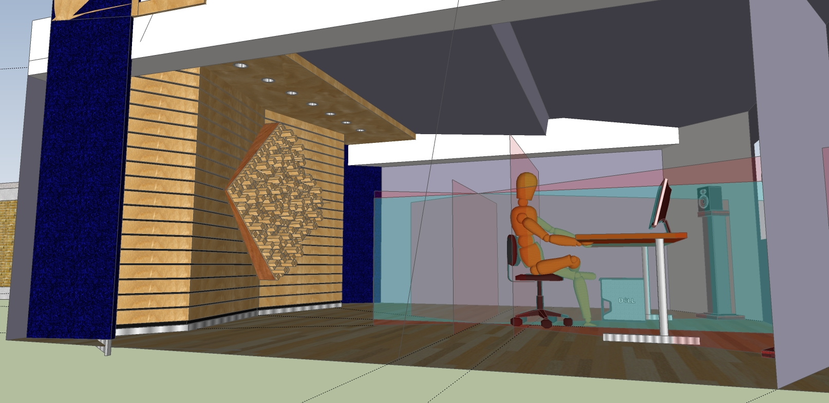

At the risk of wasting my time, the wrath of experts notwithstanding, I have no clients, and I have the time. Hence, let's get this ball rolling.
After all, what have I got to loose.:D
btw, these are preliminary design studies. That is all. But there is a ton more. Lots to consider. In the meantime..let's play.;) oh, forgive the size. My editing program is broken at the moment.
