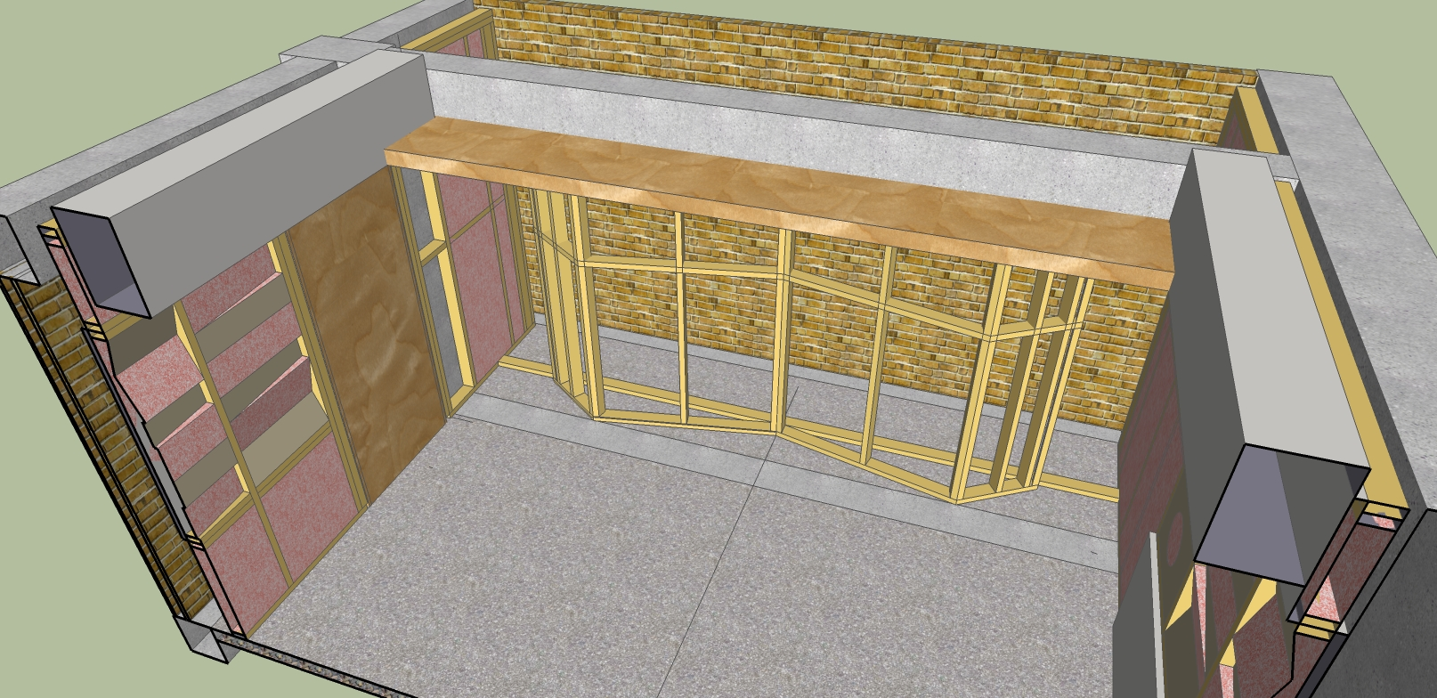

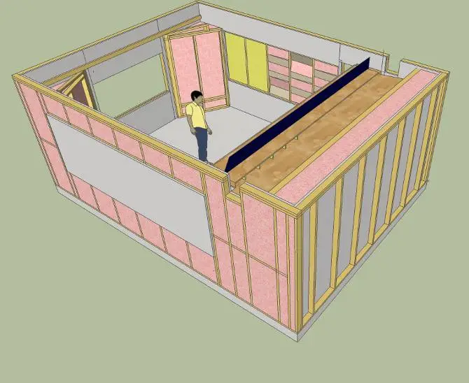

We're not giving up on you. But you NEED a solid plan BEFORE you start building anything. That's like a fisherman without a hook. ok?
Draw up some plans of what you propose, post them and we will critique.

and mr. Chronicle, i don't even know how to thank you for these 3d representations.
sorry if i was impatient or unreasonable, its good to know you guys are here:thumbs up:
No problem. I do it for drill.:p Unfortunately, it takes time, which I have some, but not a lot. The file isn't finished either. Lots of details that take time to lay out. And please, this is mostly for information as the axiom says..one pic=1k words. In reality, only you know what you are really dealing with here. Especially your budget. Local materials, codes, skill sets..etc, all have a bearing on what you can do. In that regard, John is absolutely correct. You need a plan. However, one thing I was wondering about is what you plan on using for HVAC?

Nice Rick!
But I wouldn't put the horizontal slats in the rear.. it needs to be fully absorbent - therefore, I'd make it at least 20 cm deep and he's going to need some limp membrane traps for LF control below 100 Hz. - And just make the ceiling FLAT to the bottom of the beams with full absorption - preferably 25 mm rock wool (60kg/m3) with light-weight fiberglass on top to fill the rest of the ceiling cavity. Front and side walls need serious consideration as well. Remember - cement bunker.
Yes, cement bunker.:laughings:
Ok John. As to the rear wall, yes, I knew it should be fully absorbent. Unfortunately, it takes time to do the Sketchups and I get ants in my pants to post the jpgs.:facepalm::o But I have a question. As to the slat/slot wall, this has been a "standard" element of John Sayers for a couple of decades, no? Now, in the first set of jpgs I hadn't had the time to insert 703, within the stud framing of that "fixture". Nor had I the time to manipulate the slats/slots into random widths and really didn't know what depth they should be. Nor did I know if that wall should be "sealed on the back side. My reasoning is this.

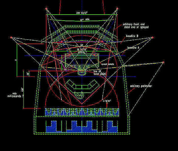

A long time ago, in the first edition of Alton Everest's Handbook of Acoustics, he had an illustration of a LEDE CR, whereby the rear wall, actually was TWO rear walls. The envelope rear wall, which had a "low frequency" QRD between the two, , and a "fixture" rear wall in front of the real rear wall LF QRD, which also had a series of mid/hi QRD's as well. However, at each end of the "mid/hi QRD fixture" wall, was an opening to allow LF's to ..well, I think he explained it as "pressurize" that area between the two walls. Not having access to that book anymore..here is an approximation of what it looked like....
Anyway, that is what I had in mind..ie... the "fixture" is a freestanding "diffuser"/scatterer/slot absorber with openings at each end for either just fabric, or superchunks, or VPR's or what ever. Just hadn't got that far. However, I also hadn't had time to show the whole area behind it filled with Rockwool or whatever. Also, I had thought about VPR's, but after reading your reply, well, I have a question in regards to this:

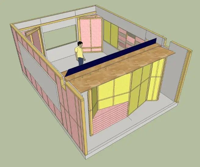

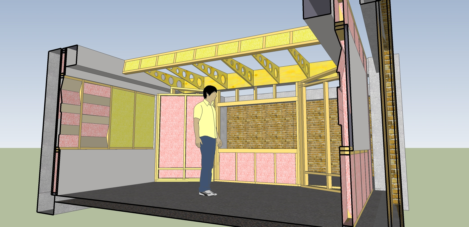

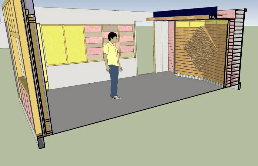

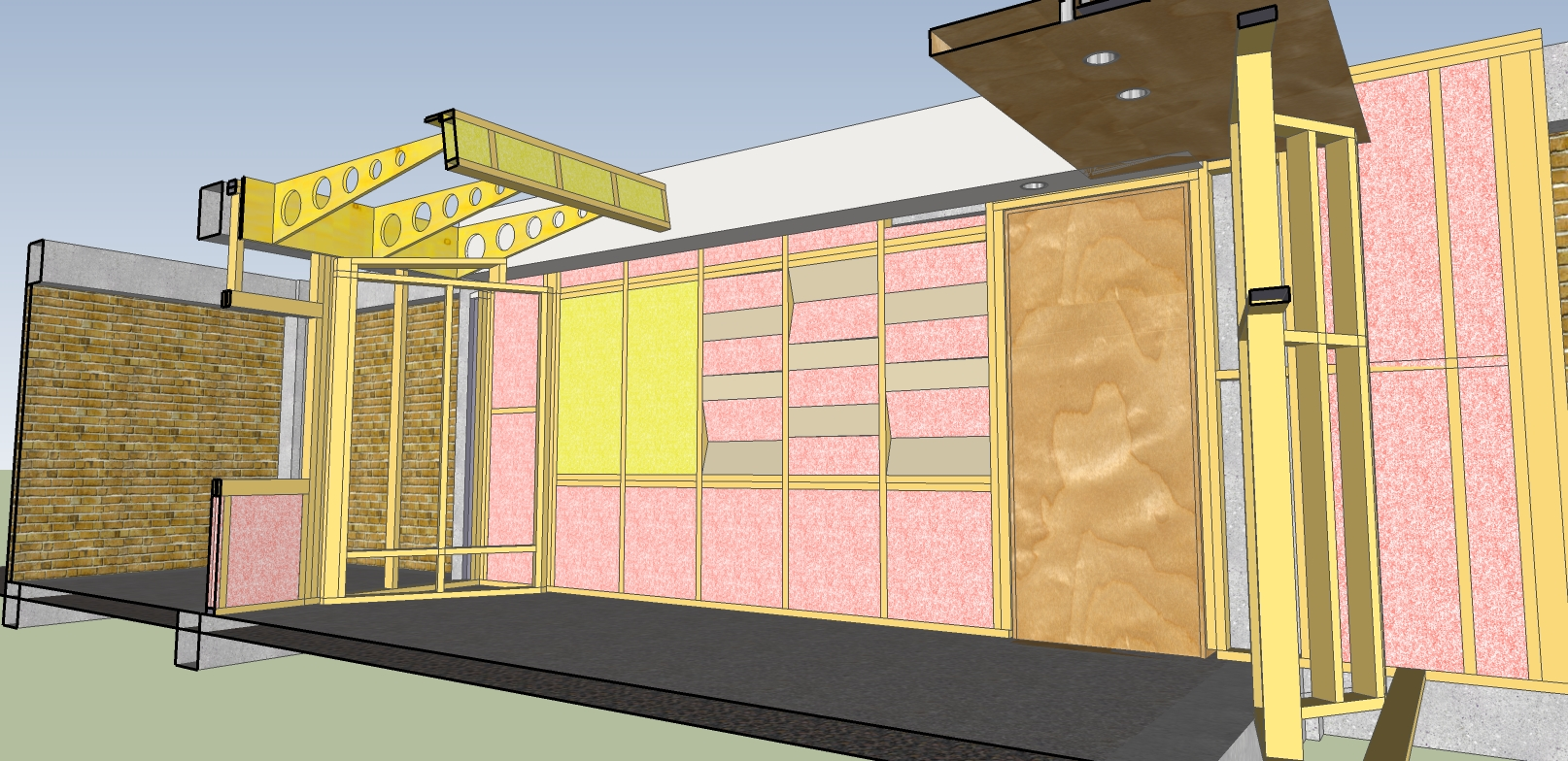

btw, here is what I had in mind...just for reference:
And yeah, I know, I haven't got to the "ceiling" yet.

the virtual studio is coming together really nicely:thumbs up:
thank you:)
i.e 12" of insulation. so i was wondering what if i were to build a suspended ceiling at 8ft with gypsum board: above it airgap, and below it absorption. please tell me what you think.
BINGO! Exactly what I was thinking. But without knowing what your budget is like..I didn't mention it yet. And here is where a few other things come into play as well. The whole idea of "my" design is based on the premise of what YOU said...ie..

Ok, here is the real deal as far as "my design" is concerned. In reality, you could simply close this space up, and use it. Or.. Put up some absorption panels and bass traps and be done with it. However, you end up with what ever transmission you have. PERIOD. My design is an effort to do what you said...down the road make it into a "pro" studio, with a small tracking space. In that regard, YOU could, if need be, simply put up a wall between the two spaces, window or not, and be done with it. AGAIN..you end up with what ever transmission FLANKING PATHS you have..ie..concrete structural transmission. Even into your upper neighbors space, especially drum impact transmission. My idea is to minimize all transmission paths by virtue of 2 rooms within the concrete envelope. Of course, you will need to address impact transmission through the floor as well. A whole nuther animal to deal with. But doable.
As to the ceiling, here are some options...take a look and then tell us as soon as you can what you think. Remember though, any choice is relative to other elements such as walls, and have their own idiosynchrisies, like time, skills, money, availability etc.

7. Suspended Light Duty dropped drywall ceiling SYSTEM-one layer drywall.(With or without insulation between furring and or below(need supports and or framing for fabric.
8. Suspended Heavy Duty dropped ceiling SYSTEM-SEE ARMSTRONG
2 layers 5/8" drywall, fill insulation above, absorption below.
9. What ever you have in mind.
10. My DIY ceiling support with 2 layers drywall, inside out construction, insulation below with fabric
Note these could also be used in conjunction with a room within a room design too. But, weak link syndrome dictates a similar ceiling system TL rating selection.
Ok, I'm outta time here but John will be back . Oh, you still haven't told us what your intent is with HVAC? Oh, and you mentioned a bathroom too. GAK!
Oh, btw...my disclaimer is in FULL FORCE. ...ie...I never claimed to be an expert in any way here. If someone sees something I've said or drawn, that is in your opinion, wrong, say so and I'll be happy to address it.
I'll be back. But please keep us informed of any decisions. That way I can update anything that needs it. Like the ceiling.:p
PS....I completely forgot. Due to the weight of some of those ceiling systems, you might want to check with your local building inspection people regarding hanging. Or, a structural engineer for that matter. That is why I have a disclaimer. In fact, now that I think about it...are you or do you have to obtain a building permit? I would think so in an urban area, with a concrete structure building in progress. But I don't know about India.
