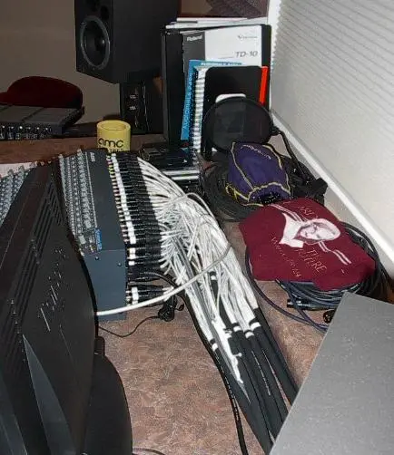

You also asked the question: what input and outputs go to the patchbay? The short answer: *all* of them. This photo shows the back of my board- I haven't built the monitor bridge yet. You can see all those multipair cables: *every* input and output on the board is occupied, and is routed over to the patchbay. That way, I can get access to e.g. "insert 14" without having to dig in the back.
Same thing applies to all the fixed outboard gear: all inputs and outputs show up at the patch field. Once I finish installing a piece of gear, I never want to see its backside again.
So: board direct out 1 goes to the patch bay, where it is normalled to multitrack in 1. Multitrack out 1 goes to the bay, where it is normalled to the board's tape monitor in 1. The mics and lines are normalled to their sources around the room. The master outs are normalled to the 2-track ins, the monitor outs are normalled to the playing-position distribution amp. Aux out 3/4 are normalled to the main reverb in left and right. Its outputs are normalled back on the board's aux return A left and right. And so on, yadda yadda. Everything is connected where it needs to go, *by default*: and then, any desired exception can be made by just sticking in a patch cable.
But *first*, you need a very solid idea of where everything needs to go for your desired working style. Which takes some time, planning, and a few hard knocks.
And that red tee-shirt is my "I heard the future" Ampex ATR124 shirt: from 1980... Damned if the future didn't get here, and it's one hell of a lot different than I expected...

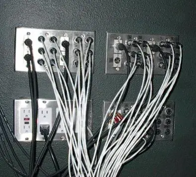

Here's the wall directly behind/under the board, where all that stuff pops up from all the playing positions. I custom-fabricated those plates from Hubbell 4-gang stainless blanks. Power comes in along the footer plate from the lower left, all signal connections come in from upper right...

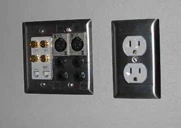

Last picture: the wallplate from the living room, which is essentially underneath the piano. This varies from the downstairs plates, because I also ran foldback speaker lines up (the little Sampson power amp right below the patchbay is used for this foldback). Works great for using the living room for piano/vox and the downstairs just as a separate control room...
It's nice, because it take 5 mintues to completely strip all the recording stuff out of the living room, and you'd never know about its alternate life!
I also ran 2 runs of Cat5 into that box, in case I someday needed Ethernet direct to the studio, and there's als a run of RG6 coax in place as well (but not terminated- just curled up in the box on each end). Look at it this way: wire is _cheap_ when the walls are open. Once you seal them up, wire gets very expensive indeed...
Standard disclaimer: There are a lot of folks here who know more about building studios than I do. I've put this stuff up, not to show "how it should be done", but rather to illustrate one way that it _can_ be done. Your mileage will certainly vary, just as your working style, your musical needs, and your room will vary from mine...
A lot of the things I do might not work for you: take what you want, and leave the rest...
