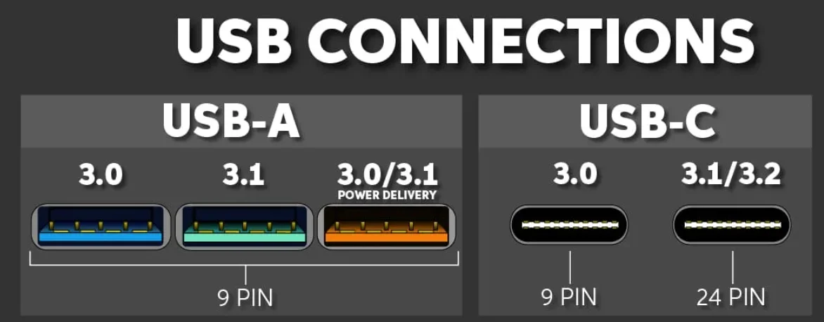

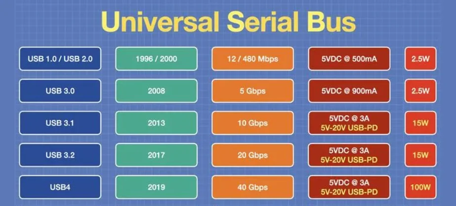

The problems I've read about come from the fact that USB has so many different data rates and power capacities. USB 2 is 480 MB/s, USB4 can be up to 40 GB/s. That's 80x faster, and it has to handle much more power. That means the shielding and internal cable geometry needs to be different.
Remember, USB-C is the connector, not cable capacity.
Its confusing, the USB 1 connector can do USB 3.X speed and on, with Type C mainly the "new one" and does higher power, high speeds, but so does USB 1 connector, while USB 2 connector and all the others seemed to be less popular.
I would like faster but my problem is mainly power with the ZenGo type C connector, but USB 2.0 (USB 1 connector) isn't enough power at all 500ma, and Antelope has problems with even 3.0 900ma, when it seems they state at times, the unit actually is best at 5V/3A to be confident. They really didn't make this clear at all. I notice all the AA units being dumped and sold due to frustrations and I wonder if its common the under power issue?
I've found WallCharger 5v/3A plugged into its B-port. The cable is working 2 weeks +. The Unit luckily offers two ports and one can be Power- the other Transfer.
The USB PD is a new one too, Its going to 5A right? a long way from 500ma.

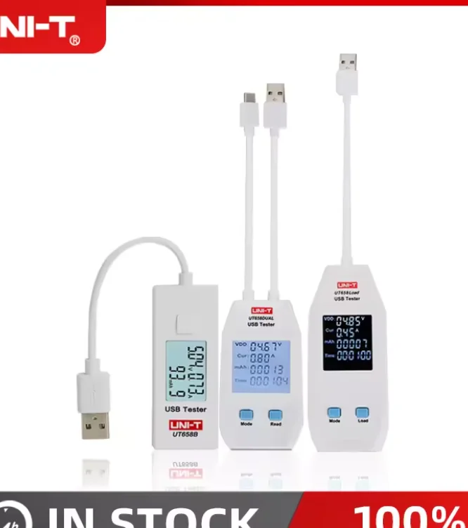

this USB power test/meter showed up.
It measured 5v with .6A ~.7A, on the USBA (PC jack) to C(interface) - 3.0 speed/power outlet port powering the interface. Its - "blue"USBA plug type and is rated for up to 900ma. The Antelope interface is drawing around .7A aka 700ma, meaning it requires USB3.0 power, (and USB 2.0 power 500ma max, will not work for the Antelope and probably caused a lot of the problems and their literature was wrong in some posts saying 2.0 500ma will work. aarggg )
thumbs-up for the measuring device!
I paid $26 for one, but Aliexpress has 3 of them for $16. It answered the mystery of the interface power problem.
Rich, I get what you are saying the USB plug types and the USB speed/power are not related. confusing as they keep changing and adding more.
I have the old PC, tower, with all USB-A types, but two are 3.0 (900ma) "blue" , all the others are 2.0 (500ma) "white".
Wish I had a newer PC with 3.1 USB-A or C connector 5v/3amps.
Toms Hardware site mentioned beware cheap USB cables too. Having thousand dollar rig and a cheap cables causing issues.
So who makes good USB cables?

Thats more effort but good video of data. Makes sense they all worked and passed power and data, $4 or so....pick one you like. I have many cables fail from the Dollar Store, so not sold on Super Cheap anymore... it is noted he mentioned "maybe they're all made in the same factory" sounds like microphones.

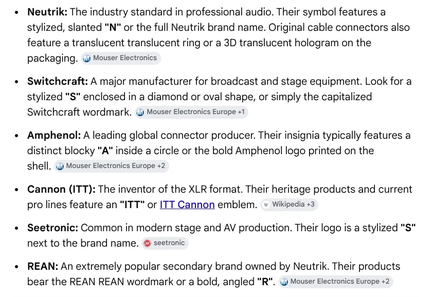

Physically looking at the gear I have, with a magnifying lens, better yet HD phone pic magnified!! I looked into what my gear had for gearheads fun.
Mics-
1) 1973 SM7 has Switchcraft, gold pins XLR and still works fine and the gold is still intact. (not Neutrik)
2) KSM32 1st version is stamped SHURE XLR. (AI says they used Neutrik on KSM series, maybe stamped on the barrel?)
3) AKG 414, 420 nothing stamped so will assume its Neutrik as AI stated. (maybe stamped on the barrel?)
Preamps-
4) Ted Fletcher Joe Meeks- VC1Q - Switchcraft full name-stamped
5) KT 1176- Neutrik stamped
6) Antelope Audio Zen Go - Neutrik per literature
7) Mystery solved! Line6 UX8 using Switchcraft per the S symbol in triangle
8) Mystery was a APHEX 207 stamped with a "C" but AI says this is a Neutrik logo too?
deep in the Male socket was the Neutrik full name stamp! so will assume the female is Neutrik.
9) Grace Design, stamped Neutrik XLR
note: The "Liechtenstein" Inscription
: Genuine Neutrik inserts usually have the country of origin, "Liechtenstein", crisp and deeply molded into the plastic body or outer barrel interior. Fake connectors often omit this or have fuzzy lettering.

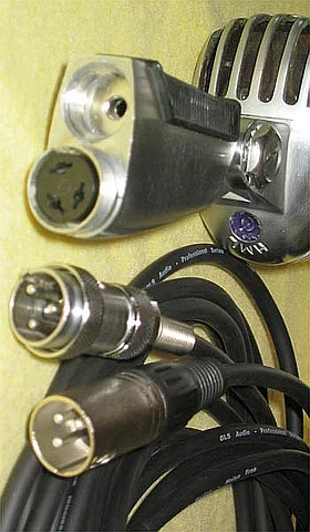

I never heard about Neutrik connectors in my younger days.
I remember old Amphenol connectors on a few mics that I had from the 50s that my Dad bought used when I was a kid. My Shure 55 no longer works. It was ruined when the basement flooded. It was my vocal mic when I first started playing into a Bogen PA.
Switchcraft seems to be the manufacturer of choice for guitar players. Everyone seems to specify Switchcraft jacks and switches, and the promo department puts that in the ads to promote their quality.
I remember Cannon connectors. When I bought parts at PI Burkes in the 60s-70s you didn't have import connectors. It was Cannon, Switchcraft and Amphenol. And they were expensive... you would pay $.75 to $1.25 a piece.

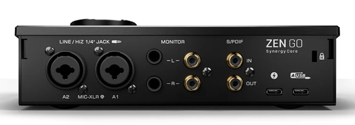

Then the Power USB , the Antelope Audio offers to have a Wall Charger/ USB PD to better power their product but they don't send one or a cable with the unit, leaving the customer to possibly under power the unit which crashes the firmware or whatever. 500 ma , 900ma, or 1A or 3 A or why not 5A!!! over engineer the power plant! lol
So adding the Meter it showed 700 ma, which would crash at 500ma, and work ok with 900ma, but again a Great Wall Charger aka USB PD is $20, why not?
I noticed a lot of interfaces in the lower end have no power supply but some are offering USB wall-charger type plugs to better power the interface.
So a good wall charger and a cable for higher V and I wont hurt , splurge $28. ?
The lightening bolt is a USB PD power plug, (not thunderbolt speed) and the odd A-USB port is the actual Bi-Directional Speed port.
