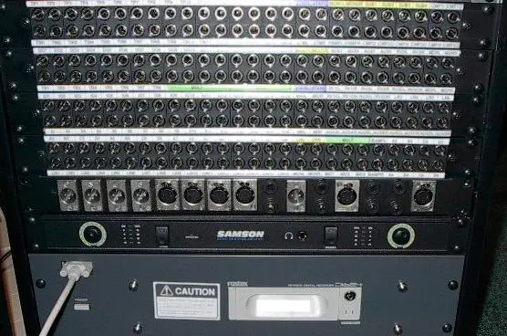

In case anybody is still interested in this thread- I finally finished up my mic/access patch strip and got it back in the rack.
What shows up on it are, from left to right: the 4 loose mic lines (the secondary mic lines to each of the 4 downstairs playing positions) on the 4 male XLRS, mic inputs for channels 8-11 at the board on the four female XLRs, and three access/multing points: one male XLR and two female XLRS that are multed to 2 or 4 regular 1/4" TRS connectors, so that people don't feel obligated to stuff their regular 1/4" plugs into my telephone-type patch strips...
A more elaborate or larger studio might do well to have a larger two-unit bay for this (or more): 4 pairs of XLRs for mic patching won't work unless you have most of your mic runs permanently dedicated to input channels, as I do (the fewer connections in the signal path, the better). My old room had 2 rows of 12 male and female XLRs for mic patching, and a separate 1-unit strip with a bunch of 1/4" TRS, RCA, MIDI, and other connectors cobbled onto it... But remember: XLRs do not have switching contacts for normalling, so any patching will require a cable.
Pix of my current (vastly simplified!) setup below.

Skippy, is that picture of the front or back of your patch bay?

That's the front (operator) side. The back of the bay consists entirely of cables terminated directly on solder lugs- there was a picture of the back side posted over on page 2 of this thread.
Some low-cost bays do have jacks both front and back: so you'd get a couple of 1/4" TRS to 1/4" TRS cables to get a signal from the source to the bay, and from the bay to the destination, and they'd plug in to the "back" jacks. Then any patching you'd do would occur in the "front" jacks- and you can set up a normal, or default, connection between the source and the destination so that no actual patch cable needs to be plugged in on the front to make it work. That photo shows my bay stripped down to the default: there are no patch cables in the front (no exceptions to the default connections), andt it's ready to track.
I don't believe in those "jacks-front-and-back" bays, but they are great for entry level setup and for working out your preferred bay arrangement: reconfiguring them means just unplugging this, and then plugging in that, on the back side. No soldering required.
I'm a traditionalist. All my patch stuff is wire-direct-to-jack on the back side, so that I cut the number of plug/jack connections by a factor of two. And that also allows me to cut the cables that go from my signal sources to my bay, and from my bay to my signal destinations, to exactly the right length, and terminate them with the right flavor and sex of connector (TRS, XLR, whatever).
