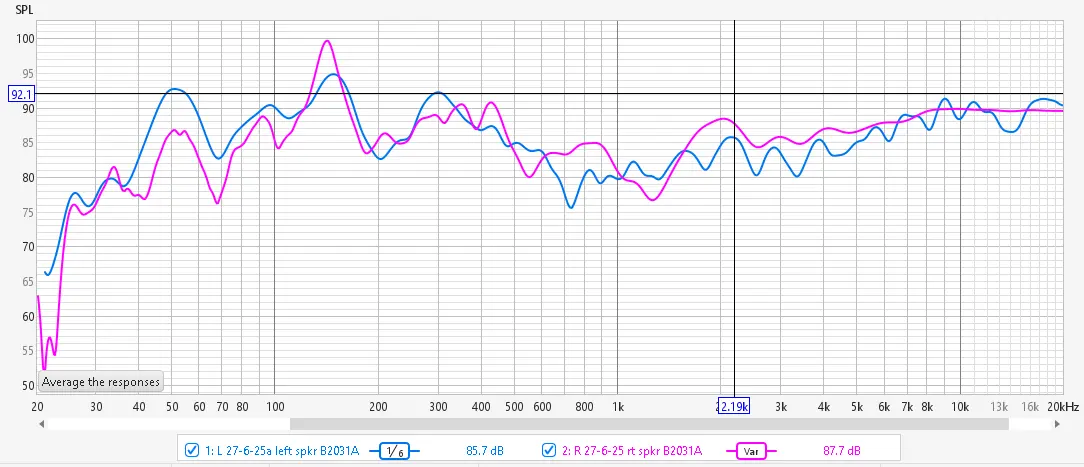

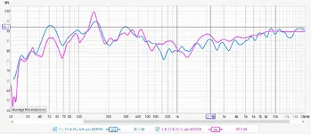

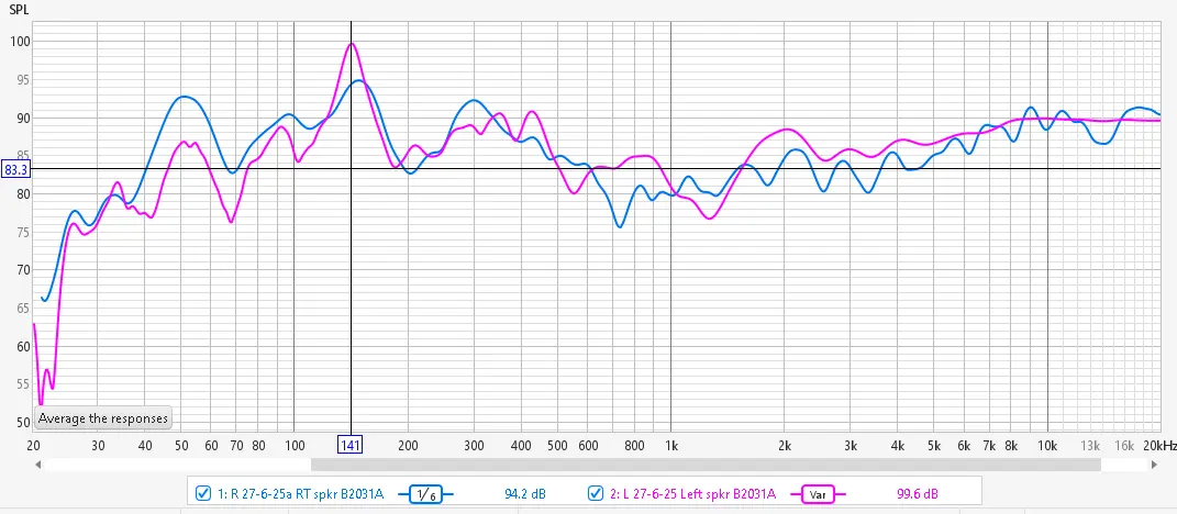

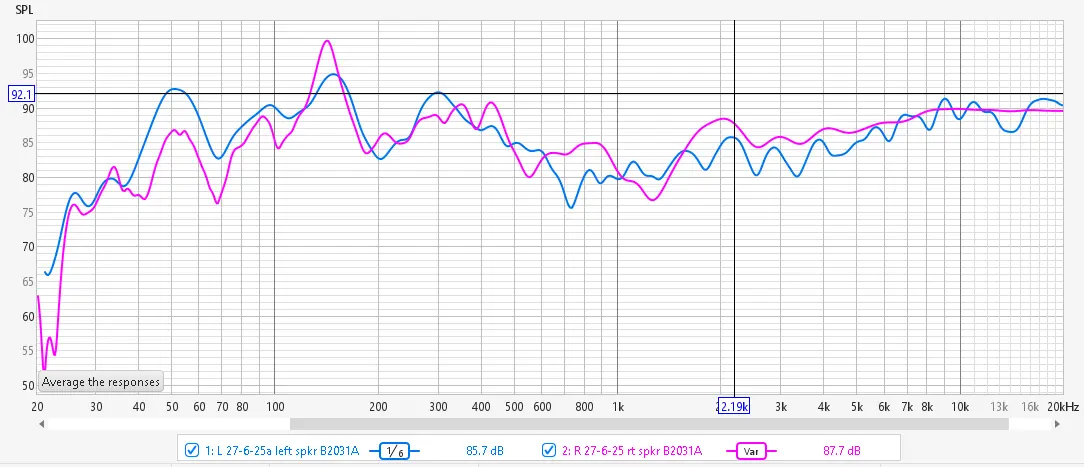

Hi folks. I just acquired a pair of used Behringer Truth B2031A monitors, as I wanted something with 8" woofers (and also front-ported, as I need to have them backed up against the wall of my small home studio). Here is my initial measurement graph (1/6 smoothing), showing the left and right speakers. I thought the Truth B2031A was supposed to have a pretty flat frequency response, but this is not reflected in my readings of today (see graph). I think the high peak at around 140Hz is a room resonance between ceiling and floor (it has shown up when measuring other speakers in the same room) but I'm surprised to see such a wildly un-flat curve throughout the frequency range. Measurement mic placement was near-field (same as my usual listening position). Can anyone offer any insights, from looking at the graph? Thank you!

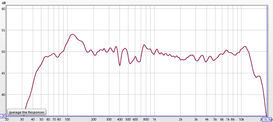

Is your room balanced? - but I would say that the Behringers are not flat - see the response curve below - if you’re handy with a soldering iron and can do micro work you can get the Truths to be relatively flat with this set of Mods: Behringer Truth B2031A - how truthful is it?
Thanks for the reply. That curve (I've seen before, at noaudiophile.com) was reportedly done outdoors. Most of it (apart from the prominent bass peak) falls roughly within about a 5dB band, which I would call pretty good. My curves, on the other hand, sit roughly within a 15dB band, which is drastically less flat. Yes, my test was done indoors, but the result is still much less flat than vastly cheaper speakers I've tested in the same room, such as Edifier MR4 and Moukey M20-3. I'm not sure why. But at least they are flatter than my old passive Tannoy Reveals from 2003.
Thanks for the reply. Where did you find the above curve? Does it represent a Truth B2301A, and was the measurement done in a room or outdoors? Most of this curve (apart from the prominent bass peak) falls roughly within about a 6dB band, which I would call reasonably good. My curves, on the other hand, mostlly sit roughly within a 15dB band, which is drastically worse, and much worse than vastly cheaper monitors I've tested in the same room, such as Edifier MR4 and Moukey M20-3.
I got it from Behringer - you REW sample looks close to the Behringer Frequency sample.
Thanks. It's the same image I've seen at noaudiophile.com. That curve looks visually similar to mine... but when taking the dB scale (y axis) into consideration, mine is actually much worse (like about 3x worse). I'm not sure why. Maybe it's due to room resonances. However, I've tested vastly cheaper speakers in the same room, such as Edifier MR4 and Moukey M20-3, which both showed up as much flatter. Only my old 2003 passive Tannoy Reveals looked worse. The book 'Mixing Secrets' by Mike Senior shows the Truth B2031A curve as being exceptionally flat.
Maybe they are flat - but everyone I know who has/had them says the same thing - which is they aren’t flat at all - and emphasize bass too much.
What mic are you using?
The 50 Hz peak and the 68 Hz dip look like possible room effects.

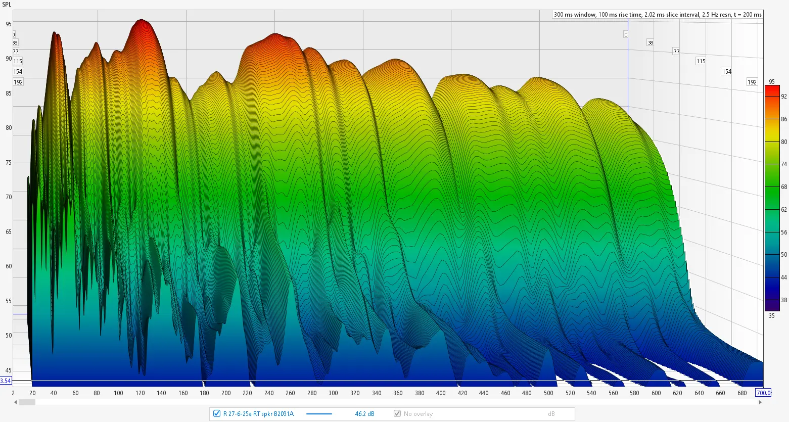

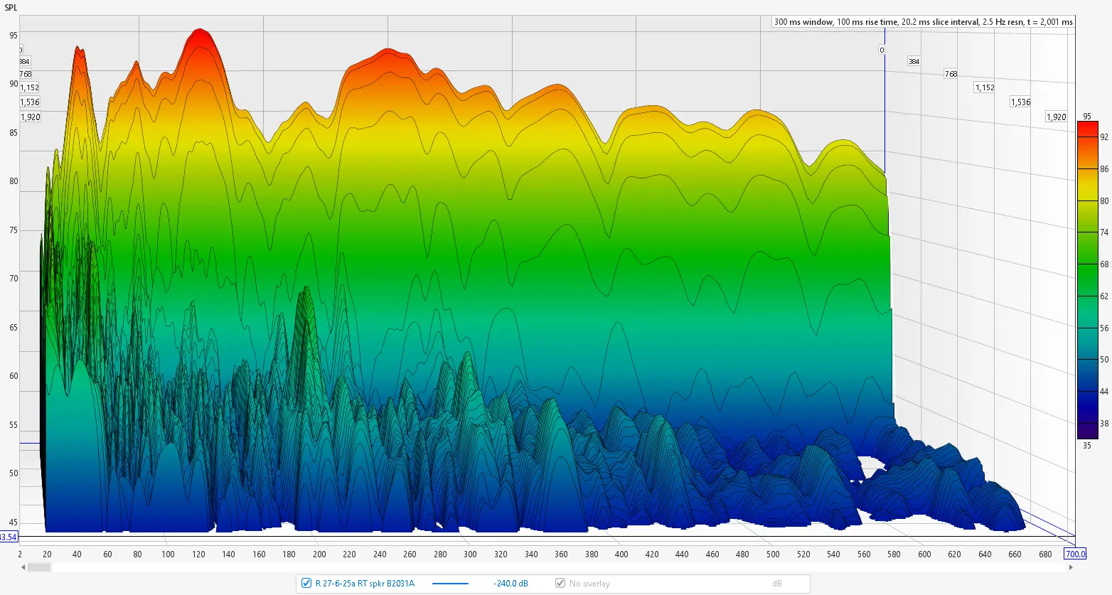

The waterfall display might tell us more about what's happening. The frequency response alone lacks all time information.
That's certainly true in my room. I haven't tried changing the room EQ switches on the amps yet. If that doesn't fix it, my 31-band hardware equalizer probably will, when it arrives. To my ears, the higher frequencies could be more pronouced, but the graph doesn't say the same, so it must be my old ears!
Take the speakers outside and repeat the test - I bet you get pretty much the factory published curve. In my studio (which I think sounds nice. spikey response curves are absolutely normal. I have an app on my phone and playing pink noise, I expected a pretty even display. Moving the phone around is amazingly strange when you see what a small movement does to the display. If you use the EQ, you will often make it worse. Unless the room is flat - the EQ will be a bit over-enthusiastic, and when you get it flat, mixes produced using that curve will sound very odd elsewhere. If you have some good headphones, repeat the test with them, with the mic sealed into the headphone cavity. That will be different.
On-third octave equalizers are very blunt instruments. You'd be better off with two or three bands of fully parametric eq than 30 bands of fixed-width, fixed-frequency filters. And eqs aren't really suited to fixing room issues. At best, they can mitigate some problems at one very precise listening position. The proper way to address room problems is with acoustic treatment.
Thank you for your input, B. The measurement mic is a Behringer ECM8000. I'm not too familiar with waterfall analysis, so I hope I have set up the following graph suitably for analysis purposes. It shows up to 700Hz (right speaker only). If you want me to change the graph settings, or post the left speaker result, please let me know!

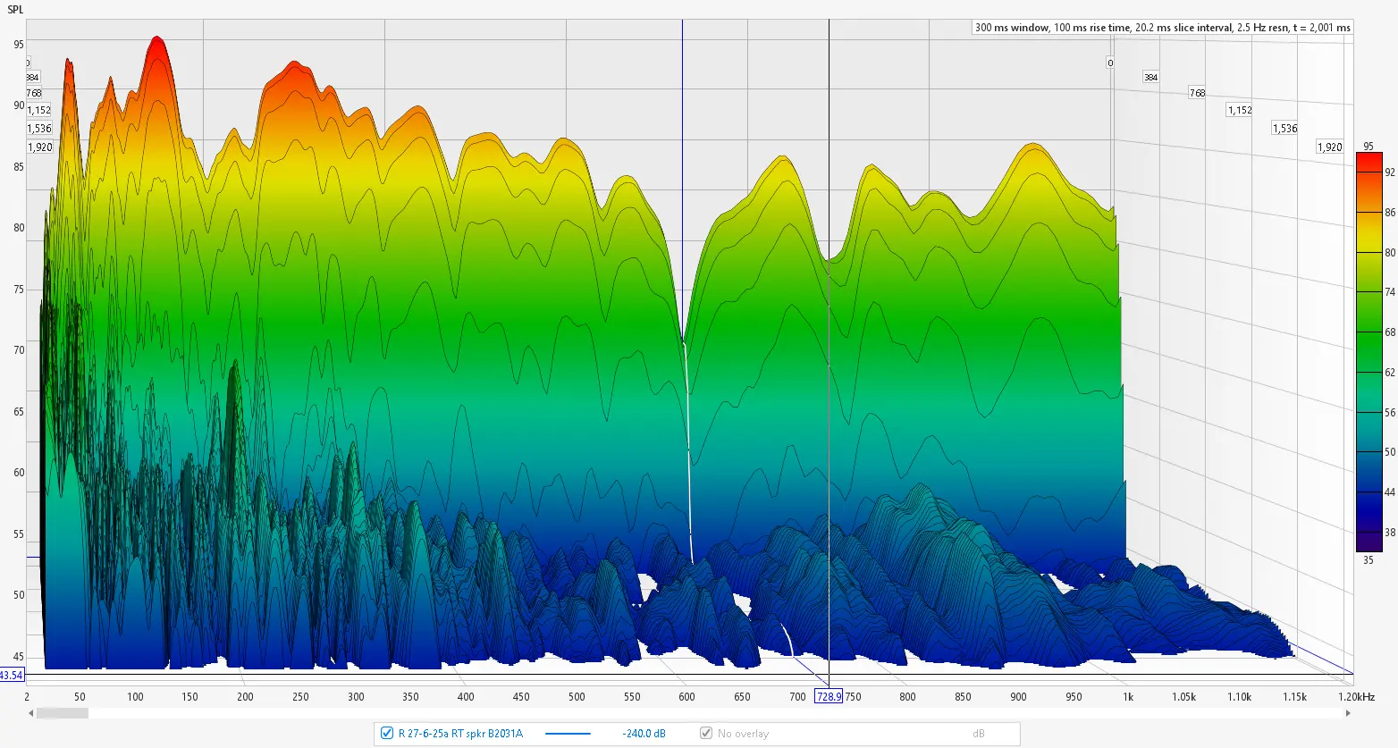

Narrow down the time frame from 2 seconds (2001 ms) to about 200 ms. Most of what we're seeing in that graph is steady state noise in your room that has nothing to do with the output of your speakers.

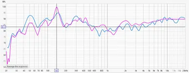

Ah, I see. Here it is to 200ms - thanks:
I see what might be a resonance around 265, but otherwise not much resonance. I think the cases where it transitions sharply from a downward slope to a horizontal ridge are more likely room noise. I suspect that the main thing that's happening is boundary effect, a boost in LF due to being placed against a wall (see diagram on back of speakers). You might also be getting reflections off ceiling, wall or desk surfaces that are adding to or subtracting from (depending on timing) certain frequencies. Treating first reflection points may flatten things out in those areas. Running the tests outdoors on a tallish stand would tell us more, but that can run into issues with wind or extraneous noise.

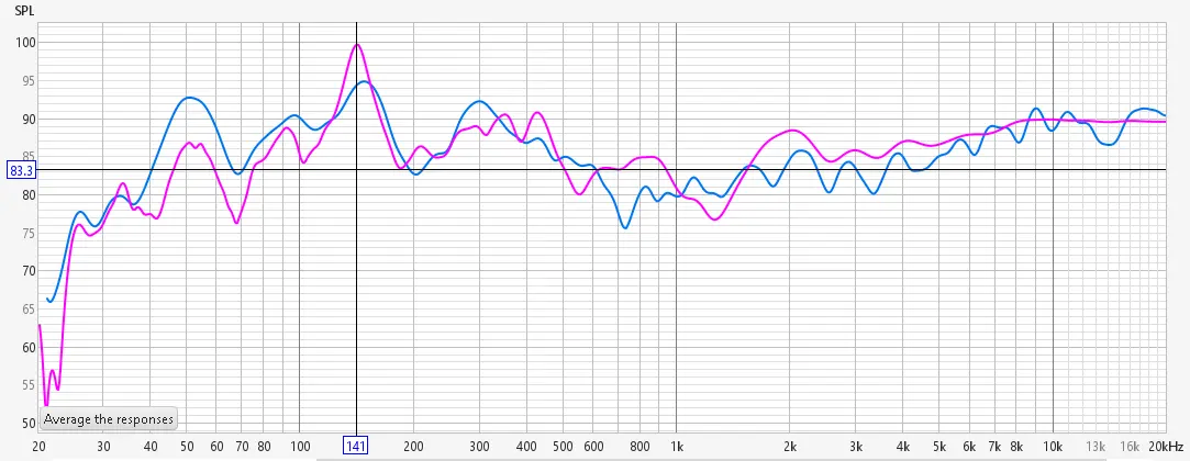

If I run a sine wave sweep through my monitors, from my sitting position, there are audible dips centered around 225Hz and 390Hz, and the most audible hump is at around 150Hz.

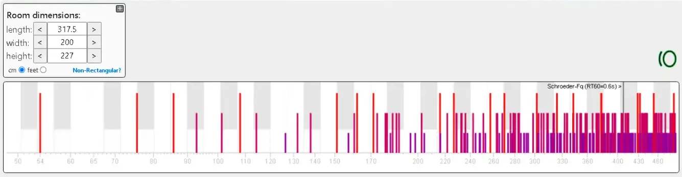

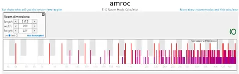

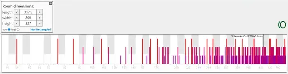

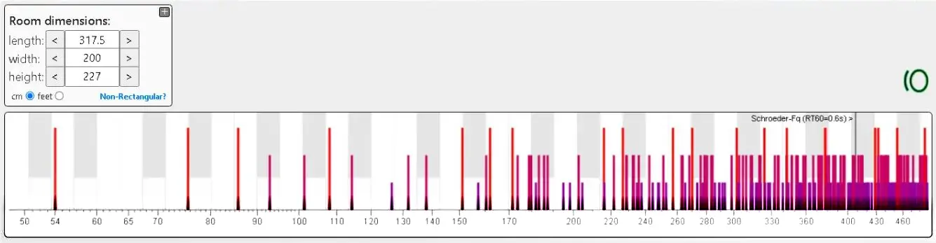

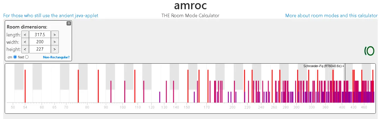

For what it's worth, here are the resonances predicted by the amroc room mode calculator, based on my room dimensions:
