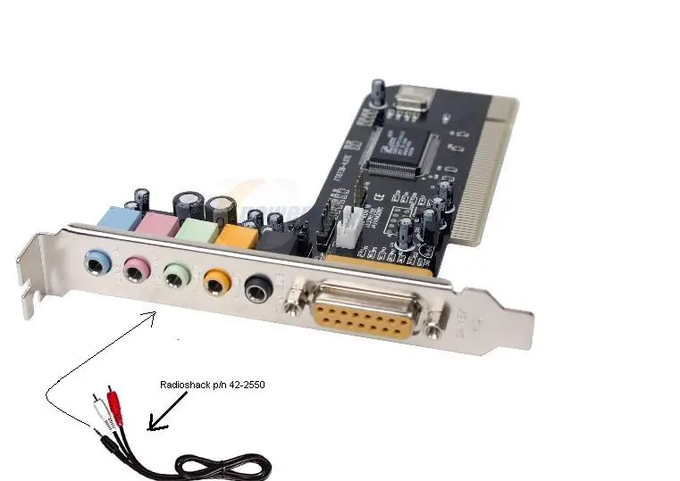

I think you're confusing your Y cables. An 1/8" Y Stereo plug has three conductors: tip, ring and sleeve. Sleeve is ground while tip and ring are discrete left and right channels. Your recording does not become "dual mono" with this approach. Mono 1/8" Y plugs exist but can easily be distinguished from the stereo plugs by virtue of only having a tip and a sleeve - no ring.
Standard "line-in inputs" on sound cards and motherboard provisioned sound are made to accept the stereo plug as I describe. You must be able to visually distinguish however, the "line-in" from the microphone input, which has a different impedence and is not stereo. Most sound cards or motherboard provisioned inputs have the line-in as green or blue female inputs. Mic is almost always red.

Look at the picture to see what I mean here. The RCA plugs at the other end of the Y cable obviously go to your phono Preamp outputs.

bennychico11 said:
if your using the phono out of the turntables, you'll need to get a phono preamp still...not a simple a mic pre.
He gave the distinct impression from an earlier post that he has a pre-amp. I assumed it was a phono preamp. Certainly if he doesn't have one of those, then there's definitely an additional issue here, I concur.
I just wanted to clarify to him that there is a difference between a phono preamp and a mic preamp. He just stated "I have a preamp" which people usually mean to be a mic preamp.
