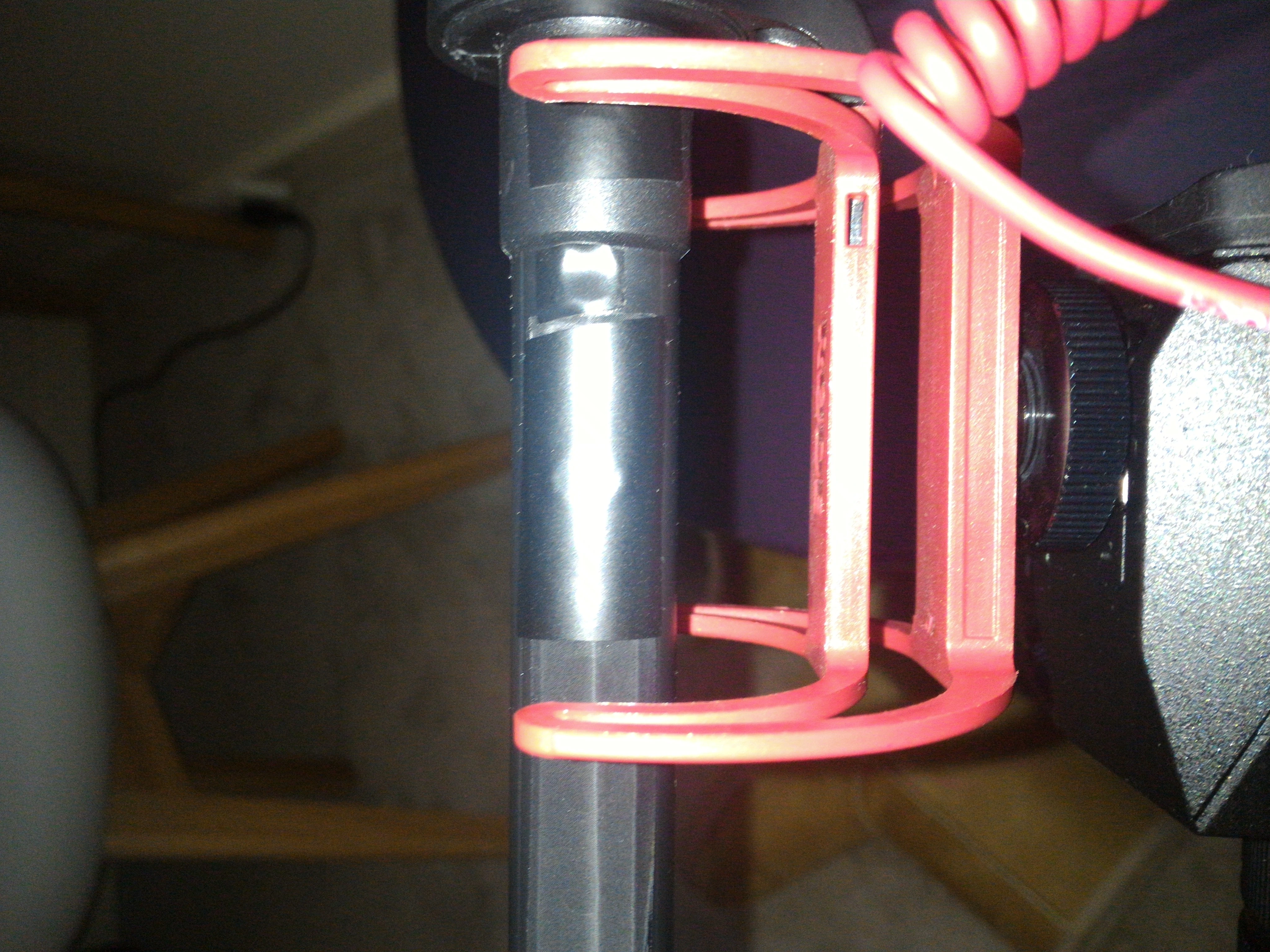

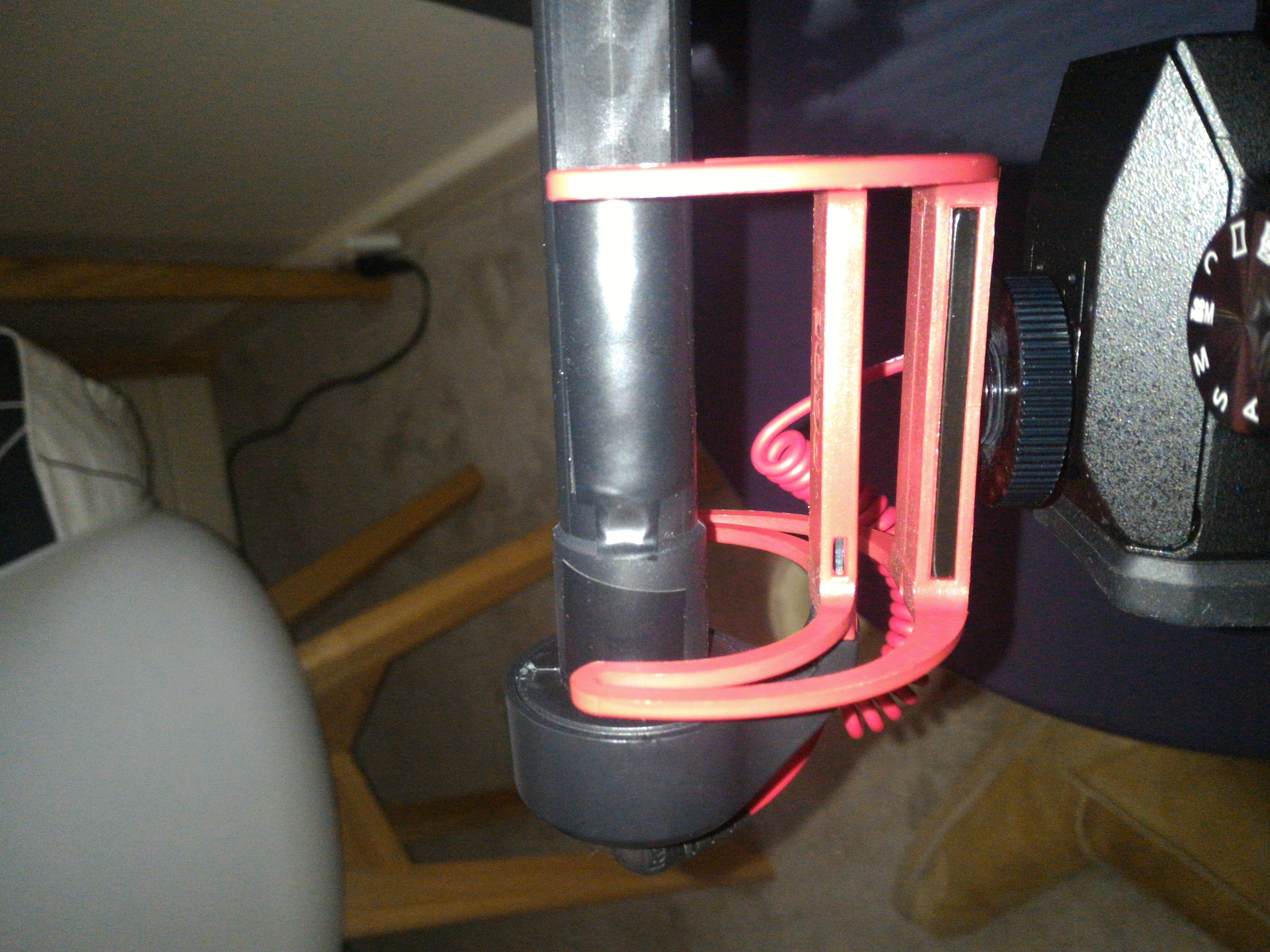

I had the exact same problem what i did to fix it was to cover up the holes in the back of the mic, and now i can shake the camera like a mad man and still no crackling noise just wind. IMG_20160130_075507.webpIMG_20160130_075522.webp
Covering up the holes is an interesting solution. However, those holes are there not without reason . . . they help shape the pick-up pattern of the mike.
