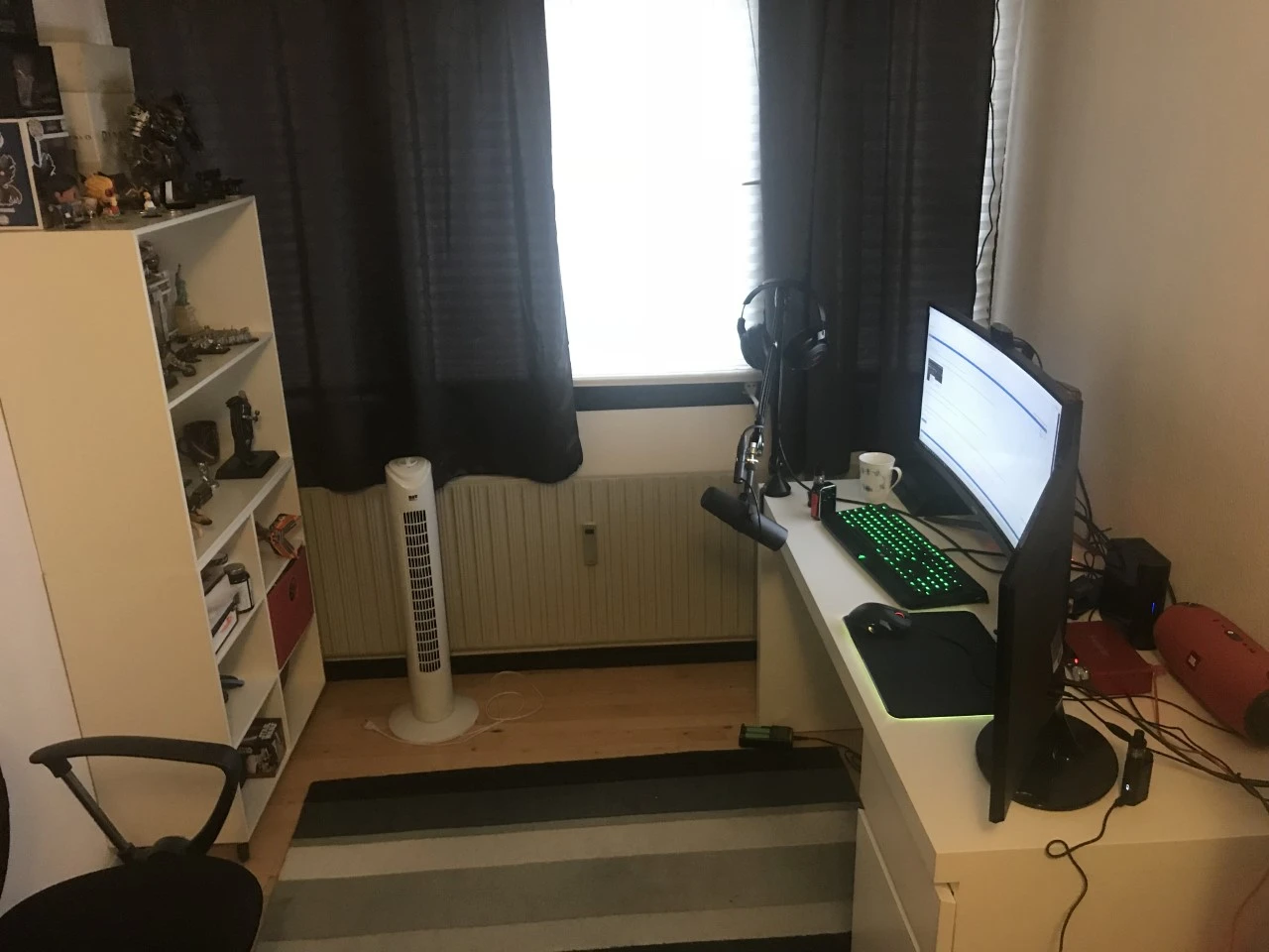

I can do better than that and take a picture :) give me a min :)!
Don't judge the cable managment pls :D

Your best option is to speak in the direction of the curtains after you close them and hang something behind you to absorb some room reflection. Room treatment is a science within its self. The nice thing about trying this is that its free and if it sounds better to you, then we can talk about that issue in another post.
Thanks for that suggestion, only issue would be that I'm using the video infront of me to record when i do voice over :D
But I just don't understand, how so many streamers and so on can have a static free sound, and their room is similar to mine without anything behind them and so on.
They are using a condenser mic, and it picks up more static noise as I've read, but I might be misinformed.
That nowhere near as bad as I expected.
The majority of that background noise sounds like acoustic noise in the room, rather than interference or whatever.
It's most likely the computer fans - If not, something similar.
The first approach here is to eliminate the noise by turning off or moving whatever is making it. Not always possible, I know.
Second thing I'd try is getting as close to the mic as is possible, so that the ratio of voice to ambience is greater.
How close were you for that test?
My computer is beside the desk, i would say about 2M away.
