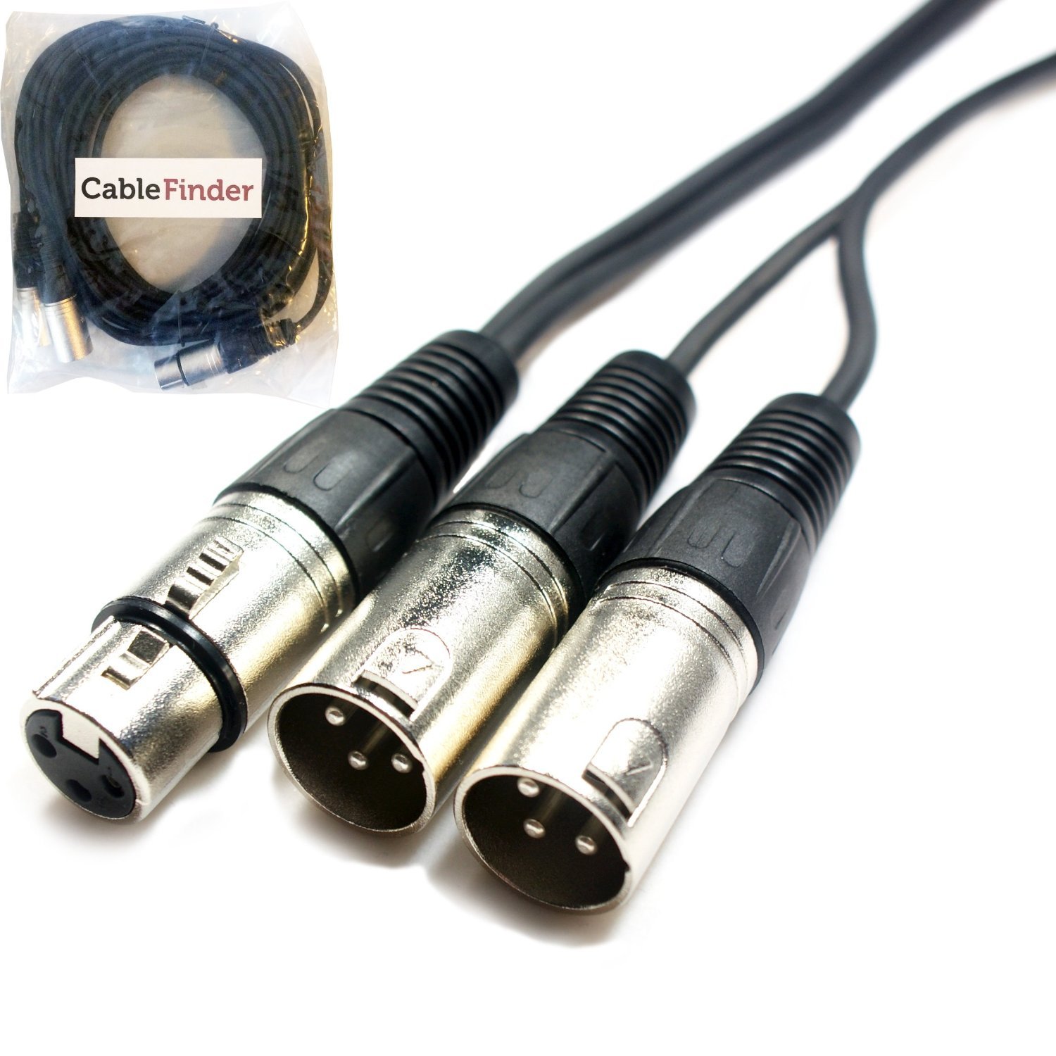

https://images-na.ssl-images-amazon.com/images/I/71mqtXZQFpL._SL1500_.jpg
That will get the signal into both mic inputs. (I could hardly buy the bits for that)
