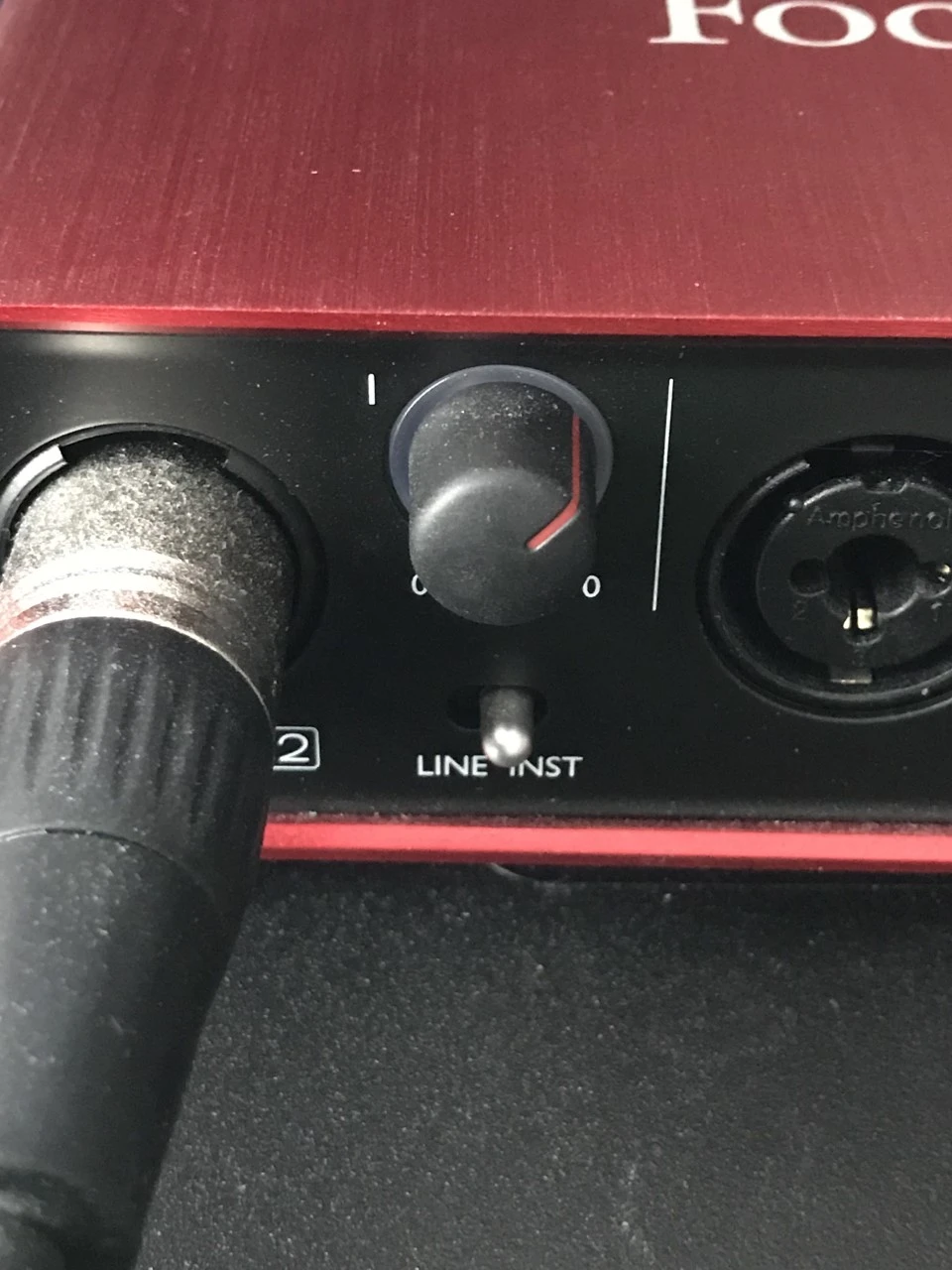

Here is a pic of the xlr to xlr.
The input gain will show up in your DAW, not your interface. Inside your DAW, the meter needs to show between a -12 and -18dbs as you are recording. You will use the gain control on your interface to reach these levels.
I just checked and it is XLR to XLR.

Cool. The video is easy to understand. Also, make sure your line/instrument button is set to "line" on your interface.

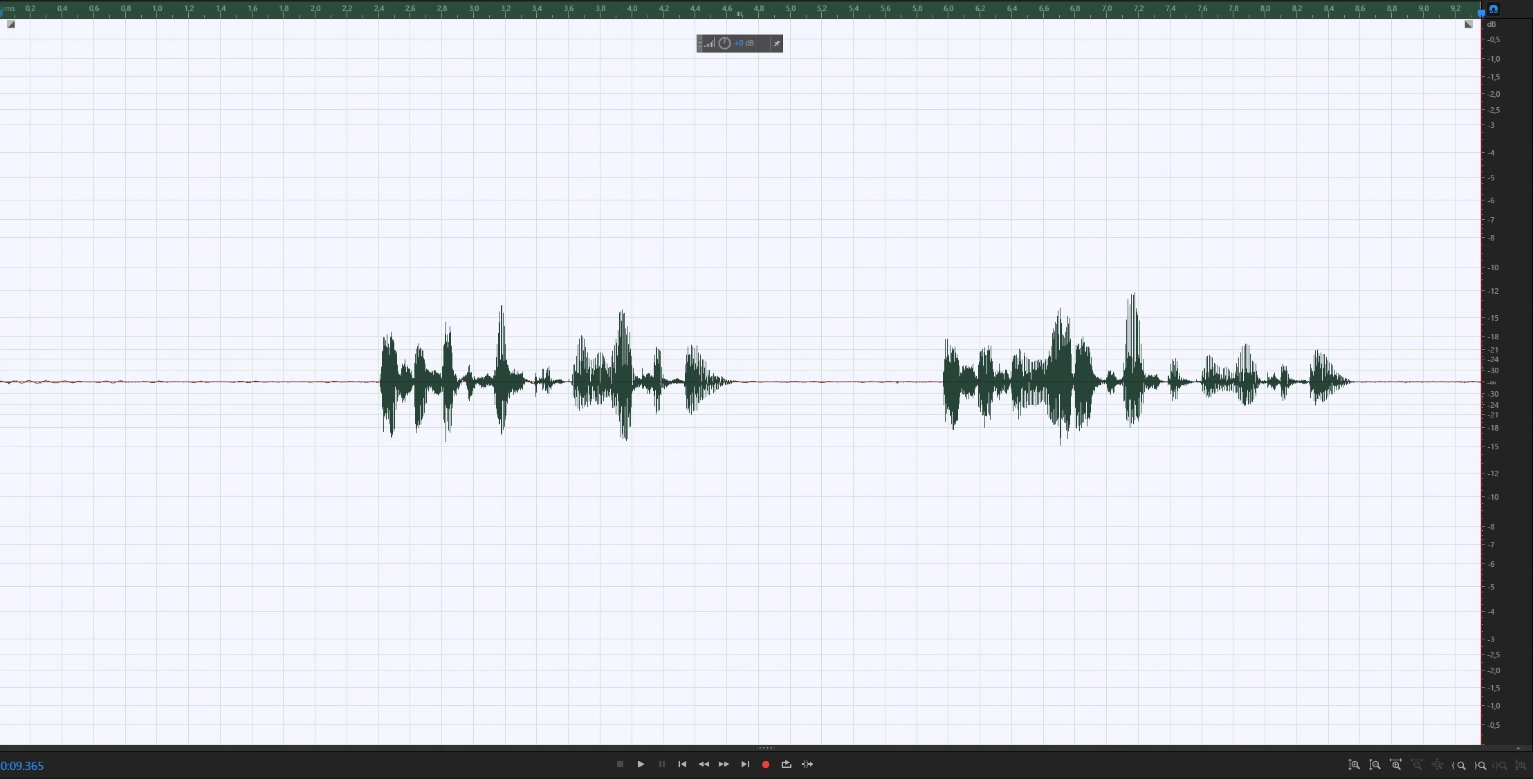

Looking at post #83 and the attached clip, I guess you have your input level sorted?
That clip sounds healthy to me - There's room for it to be louder, but it's not mega quiet.
I hear mild background noise/hiss, and room echo on your voice but...apart from that it sounds OK.
You said about 10cm before - It sounds like you're farther away than that....?
What about it, specifically, didn't sound good?
That clip sounds healthy to me.
