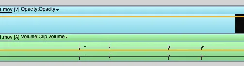

Let's see if it's a problem on the way in or the way out.
When you record, do you see audio on both sides of centre (on the green track), like this?
I have premiere elements but never use it.
I just fired it up and hit record with one microphone plugged into channel one of my interface.
The above image is the result and it played out both speakers.
If you only see wave form on the top/bottom side, then it sounds like gianluca68 has the answer.

Thanks for posting the picture - This makes sense.
I can only assume premiere pro has more advanced audio options than elements, so look for that fill option that gianluca68 described.

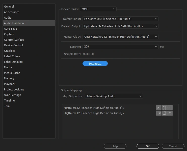

If you didn't hear it before and you don't hear it through audition, it's most likely software related.
In your Premiere Pro settings under 'Audio Hardware', what is 'I/O buffer size' set to?
I just tested it out, it also has static without the filler, but when i go inside of Audition, the presets I have does clean up the static. But I did lower the gain on the Focusrite and the static did go away.
But not sure why the mic has static, or is that my interface?
