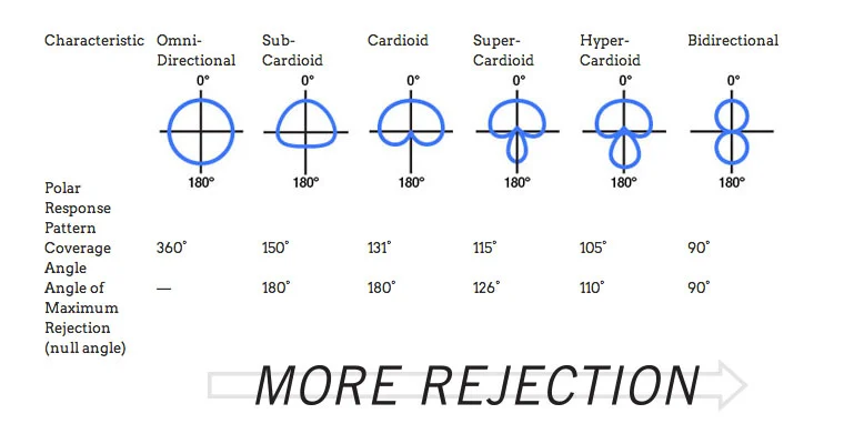

Might have been asked already.... how close are you to the mic? The further away you are the more gain you need and this increased gain may tend to make the mic more prone to picking up ambient sounds in the room such as the keyboard. A lot of people that are using video want the mic out of view which puts the mic further from the speaker and more susceptible to room sounds.
The Samson R11 appears to be a hypercardioid mic and its pattern may pickup a bit of sound behind it, which possibly could be where the keyboard is positioned(?). A cardioid patterned mic might be a better choice.
