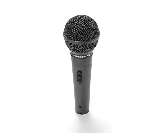

Hi guys and girls! I have a small problem. When i connect my SAMSON R11 directly to my computer it's dead. It's not picking up any sound what so ever.

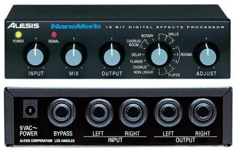

But if i connect my SAMSON R11 through my NanoVerb, it works just fine. Why is that?
I've read that condenser microphones need phantom power, but this is a dynamic microphone, and those doesn't need phantom power, right? So what's wrong?

And right now i'm using the same XLR to 6.3 mm cable to my NanoVerb, and then a 6.3 mm to 3.5 mm adapter and a 3.5 mm cable from my NanoVerb to my computer. That works just fine.

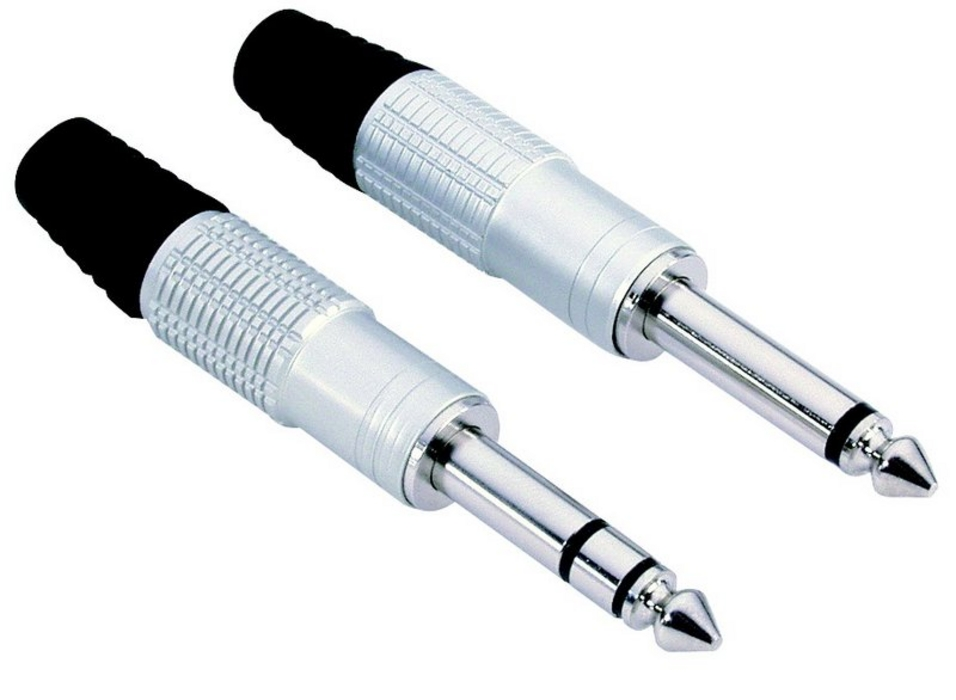

Is the 6.3 to 3.5 balanced or unbalanced? If you're not sure, does it have two black (or whatever colour) bands or one?
It looks kind of like this. So two bands.
But the 3.5 mm cable i'm using between the nanoverb and my computer is also a stereo cable (two bands).

Best guess is the computer expects to see the signal over tip and sleeve, which is exactly what the alesis left mono output would give it,
whereas the microphone conductors when plugged in directly are over tip and ring, with sleeve being the mic body.
The Alesis input expects mono unbalanced and most likely ties ring to sleeve on the way in whereas, I guess, the computer does not do this?
Maybe because it's a stereo input...maybe it's a balanced input. Maybe it's a combo line/mic jack? I don't know.
If you tried using the alesis but took your output from right, rather than left, it shouldn't work and would support my idea, I think...?

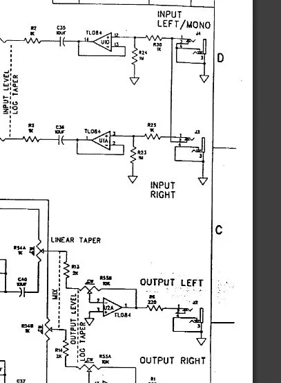

The Nanoverbs jacks are designed to accept either balanced TRS or unbalanced TS plugs and the jack is wired to make balanced into unbalanced which make your mic work OK.. The schematic below shows the jacks in the Nanoverb and the ring of a TRS when plugged in would be made common to the sleeve and ground.
Nanoverb Service Manual
Without actually understanding much of that schematic, i think i understand that the problem is that the channel that is on the mid ring on my adapter actually gets connected to the ground of the microphone cable when i use my adapter? And since computers do have both left and right channels for microphones, one of the channels is connected to the ground, and therefore cancel out the sound? Do i understand this kind of right?
