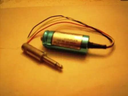

not unless you have a "step down transformer" device. I built one in the early 80's.
see attachment
