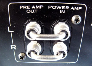

...anyone else who might know. I know Jeff worked selling hi-fi equipment a while back so thought maybe he'd know. But, I have a Pioneer reciever from the 70s and in back it's got two pair of stereo rca jacks that are connected with a removable bridge, they are labled "Pre Out" and "Main in". Just wondering if you knew what functions these served. Maybe they could be useful for something.
HI Steve,
I am attaching photo-cut from a different receiver of the same bunch with "better naming" of those jacks :)

You can get a silver face pioneer equalizer and replace those jumpers with it for more pleasures :) Or what ever you may think of, connect pre outs to a different power amp for example.
here's the photo:

These are jacks that connect the preamp from the power amp section to allow you to insert outboard signal processing equipment. Stand alone EQ, decoders of various sorts, and everything else under the sun. You can pick up for a mono sub here too.
An easy test is to remove the jumpers and see if you get anyting from the power amp.
Hey Mike, Daniel and Ethan, thanks for the replies. Ethan what do you mean by "pick up for a mono sub"?

sub woofer
There were/are sub woofer amps that have 2 inputs (for the left and right channels). They do a low pass filter and mix the 2 channels together than send it to the single sub woofer amp and speaker..
Ok, I see what you're saying. Thanks!
