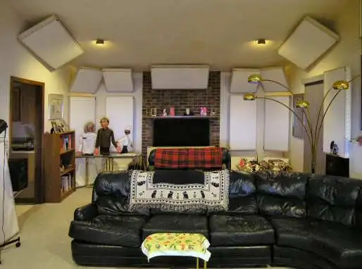

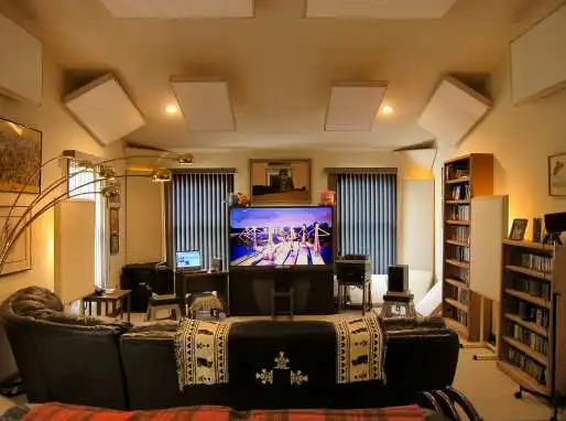

No kidding. The attached photos show all 39 traps in my living room. :D
--Ethan
