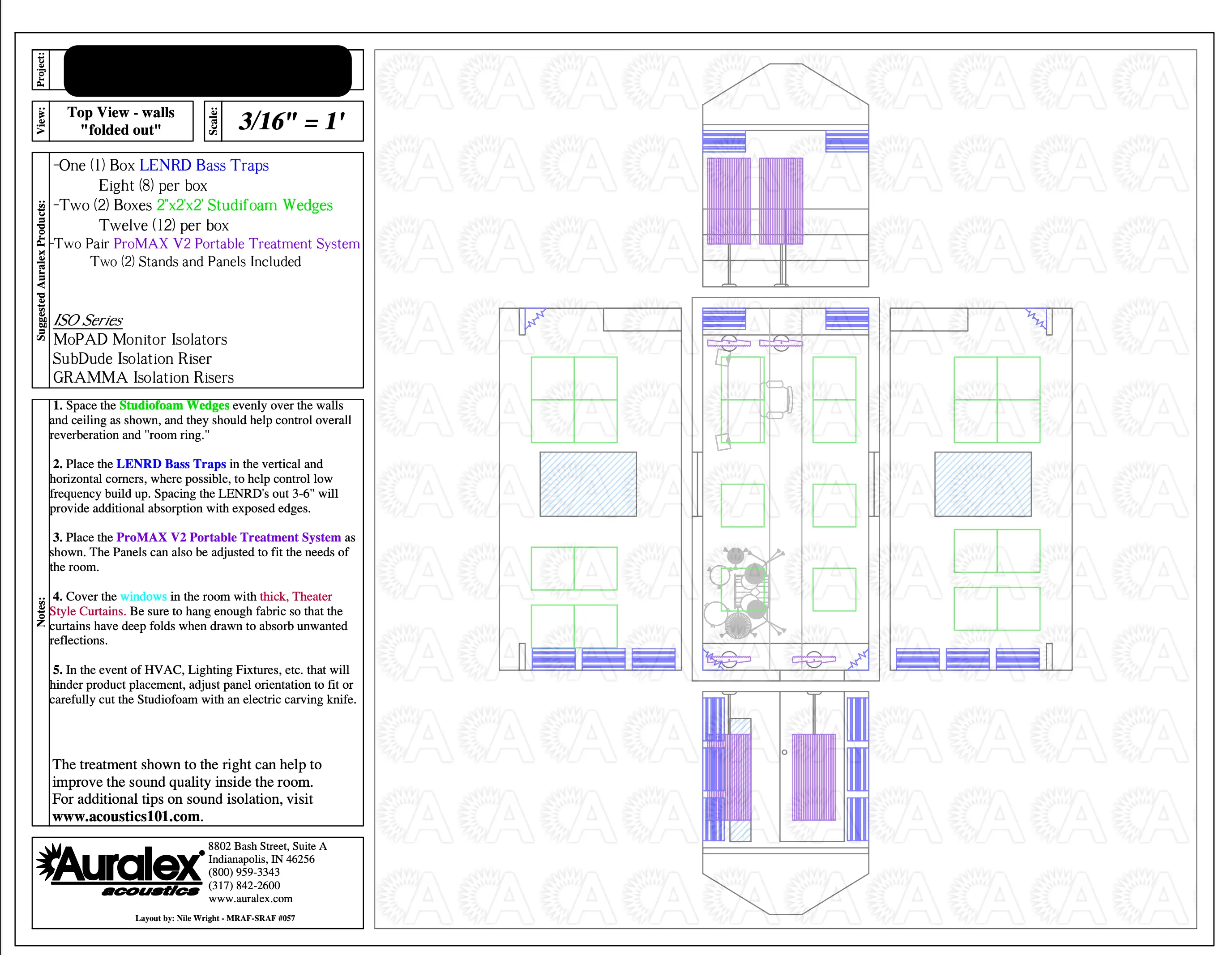

Here's an image from Sweetwater with the rough dimensions of my space and their recommended Auralex solution. Seemed way over-priced, which is why I'm looking elsewhere. But this gives you a sense of the space.
I built my own 4" thick traps, and have one corner wiht a door next to it, so I just pput the traps flat against the corner wall - which is better than nothing. As you have a little room to work with (9"), you use the 4" trap at a slight angle, and stuff the area behind it with more rockwool.
