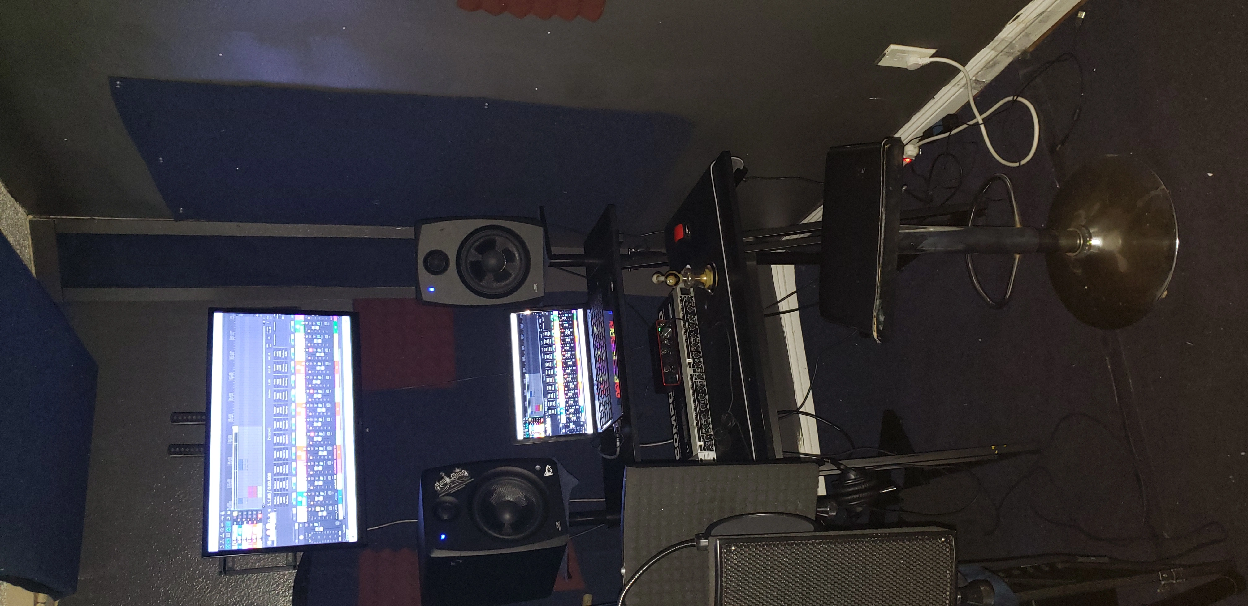

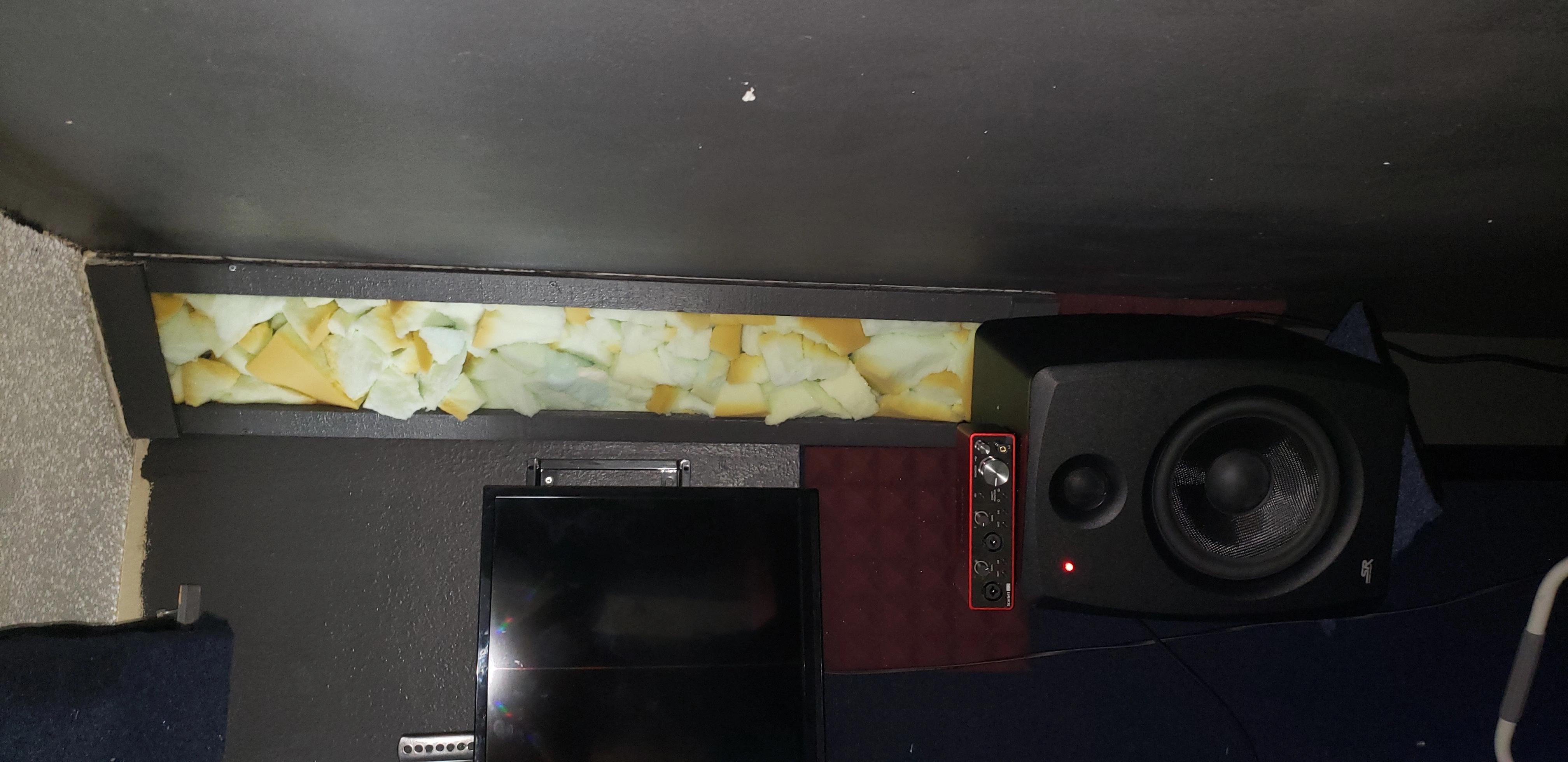

Yes do some d.i.y base traps cheap and easy to build and they work great! Check one out.
