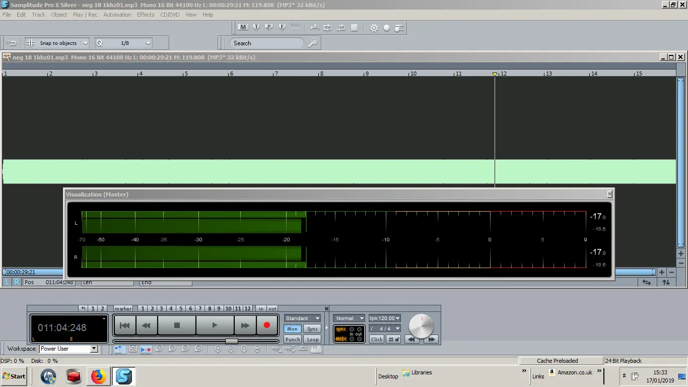

Attached is neg 18 at 1kHz. Was 16 bits 44.1kHz but I forgot I can't attach .wavs...Not even a second of them! GRRR! I have not therefore re checked that level but will do next in Samplitude. So, stuff that MP3 into PT and find the meter that reads -18dBfs.
Yus, the MP3 also comes out bang on -18.
