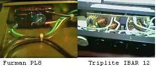

I tried to post the internal picture I did...but got bumped?
here's a second shot.

Why would you want to buy it?
All there is to it is standard receptacles with the blue "mov" across the terminals?
I guess the rack mount case and power switch is cool.
Its pretty damn empty inside the box. there's the lights
