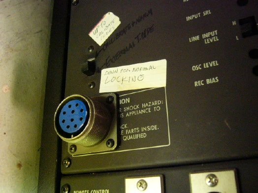

Here's a pic of a modification on the back as well. Maybe it's something. :o
