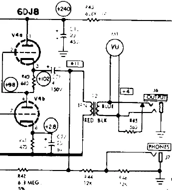

Shure M67 info is: HERE (pdf)
here's ampex 602 output (cut from schematics) (pic attached)
(you can find some ampex schematics HERE )

reelconfused said:
I have an assortment of old mic pres and mixers, a shure m67, a valley people dyna-mic, an input module from an ampex 602, and all of them have unbalanced 1/4" outs.
DrZee's diligent and free research would indicate that your units should be balanced units yet you claim all of them are not?
Do you have special versions of these units or have you just assumed they are not balanced outs?
Cheers! :)
Well, you know what assuming leads to...
Thanks to both of you for the replies. For some reason i thought balanced trs 1/4" outs was a relatively new trend aside from stereo and send/return. I figured I was going to have to find manuals if I modified the output, but never dreamed they would present such a simple solution.
