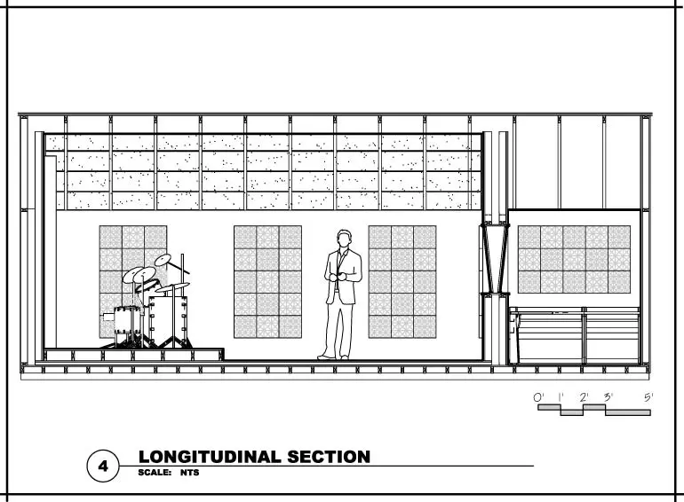

Longitudinal Section
OK.. Here's the last section for Scheme I.
Now I'm going to work on Scheme II, which will be an "All In One" Space
Thanks again to everyone for their participation thus far. It come greatly appreciated.

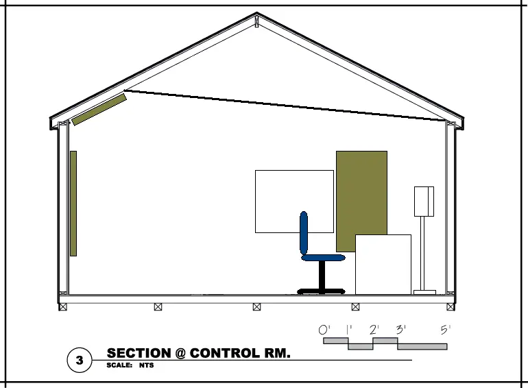

With that design, I would leave the ceiling open like in the Live Room.
HVAC is still up in the air at this point. A forced air system would probably be too expensive and overkill for a space this small, and I would have to add a fuel tank of some type. I'm thinking (2) separate AC Units (The Thru-Wall Type) and electric baseboard or other Electric Type for heat.
I figured the sound in the control room would not be as intense as the sound in the Live Room, so I figured I could get away w/ a window in there. The window is not a "Must" though and can be deleted if it's going to be a problem.
I agree, the sound won't be as intense, so i think the window should be fine.
Get a single glaze for outside, and inside, as far away as possible, instead of a double glazed window. You don't need to angle them either. The only benefits of angling, are that you can see better through window, light reflections are aimed to the ground, and an acoustic benefit of having it non parallel with the opposite wall/window. However, it reduces the effectiveness of isolation.
If you are going to angle, make it very slight, and towards the back of the control room, IMO.
How will the ceiling be angled if left open? If angled towards the back of the control room, that's great, anything else won't be good.
edit: the roof is pitched. Leaving it open isn't such a good idea. You want the sound to be aimed towards the back, which will happen for the first half, but then the 2nd will reflect back towards you, screwing the sound. So unless you're gonna add absorption on the back half of the ceiling, then I'd suggest having a flat ceiling, or angling the ceiling towards the back, like so: (although this may not be practical)
