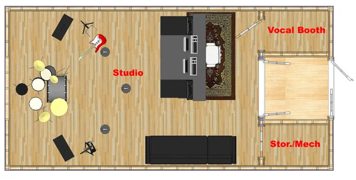

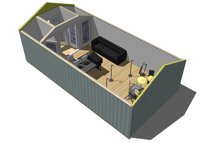

Scheme II

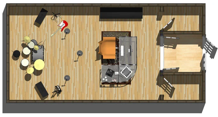

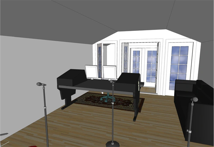

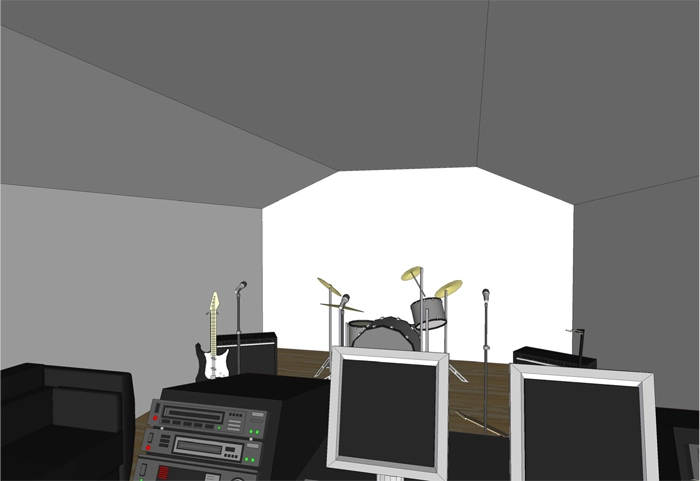

Ok.. here is Scheme II
This is More a "All In One" approach.
As the space is more a rehearsal space w/ the added benefit of being able to record. There is a Vestibule to allow light into the space and control the escaping sound. I've allowed for a dedicated vocal booth & a room for Storage & any Mech. Equipment.
I have not modeled any of the acoustical treatment yet (Eg. Slot Resonators, Panel Absorbers, Diffusion, etc..)
Honestly, I'm hoping for advice as to what I need and where to put it as I'm not real sure (From a scientific perspective)
I would be happy to email the skp to anybody who wants it.
Thanks in Advance.

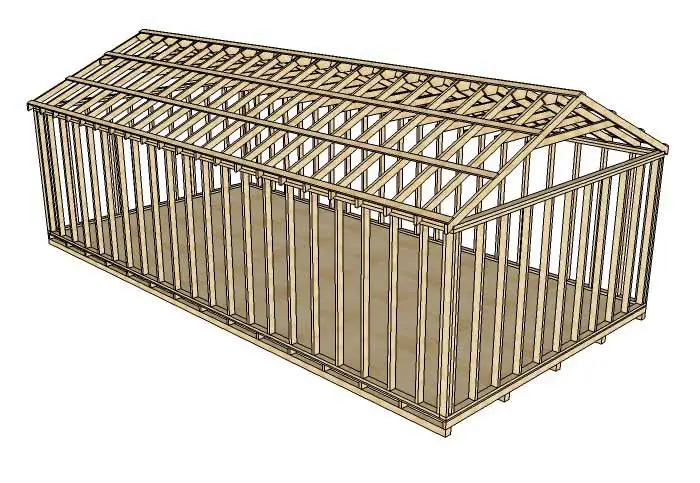

The mixing position should be centred along the shortest wall, firing down the longest, like shown below. It needs to be centred to have a good stereo image. Being closer to one wall, as you can imagine, will mean quicker and louder reflections on that side, which will certainly screw your stereo imaging.

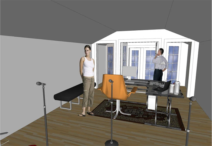

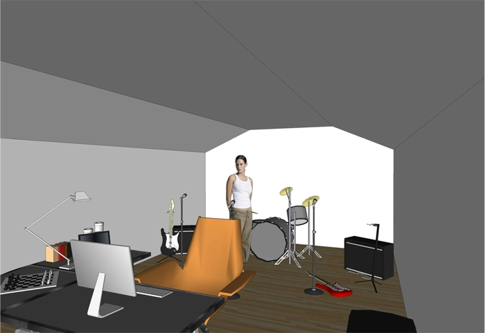

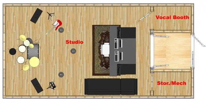

New Rendition
New Renditions

Looks good, what about monitors and gear?
My Next renderings will start to address those issues & acoustical treatments.
All the recording gear will fit on the desk shown (Thats a real desk, by the way, it came sold in the West Elm Catalog called the "cadman workstation""
Ill be going w/ an all digital set up (See my first post) so it won't be taking up a whole lot of room.
I'm going to try and mount the monitors to the wall in front, above the doors. We'll see though, they may have to be ceiling mounted.
That looks pretty cool. I'd hate to loose that much space for a vestibule though. You only need about a 6" air gap to help with sound transmission. Although it might make a good, extra iso booth.
Maybe its a stupid idea, but you could always run a wire to your house and have your control room in your current computer room? You could cover some absorbers in canvas with nice pictures on it and no one would be any the wiser :)

Hmm, not sure if this is a good idea. You generally want your monitors around ear height.
