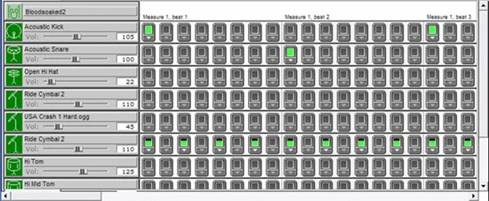

Metalhead see the picture below.
Hey Metalhead,
For the most part I can understand what your trying to explain but not sure how to program the drum for what you mean. See the picture above for a portion of a screen shot I took of my drum machine software. You can see the ride, snare and kick, I am hoping you can see how I have it programed and then tell me how/what you mean regarding to it.
As you can see it is like this:
K------------------K--------------------K
R-R-R-R-R-R-R-R-R-R-R-R-R-R-R-R-R-R-R-R
---------S--------------------S----------
How are you talking to program it?
Peter
metalhead28 said:
Right now in your song you can count that guitar riff like this:
1-2-3-1-2-3-1-2-3-1-2-3
Your ride cymbal counts like this
1-2-3-4-1-2-3-4-1-2-3-4-1-2-3-4
That would be straight 16th notes.
I am still fucking lost, god damn it!!! I can see what your talking about.....do you want something like this?
I was trying to type it out but I can't, frigging lost!!!
Peter
Ah, I see that for each beat, it is subdivided into 8 parts. In order to program the triplets corectly, it would need to be subdivided evenly into 6 parts per beat. Can you control that in the software? You're right, with the way it is now you could not program triplets.
