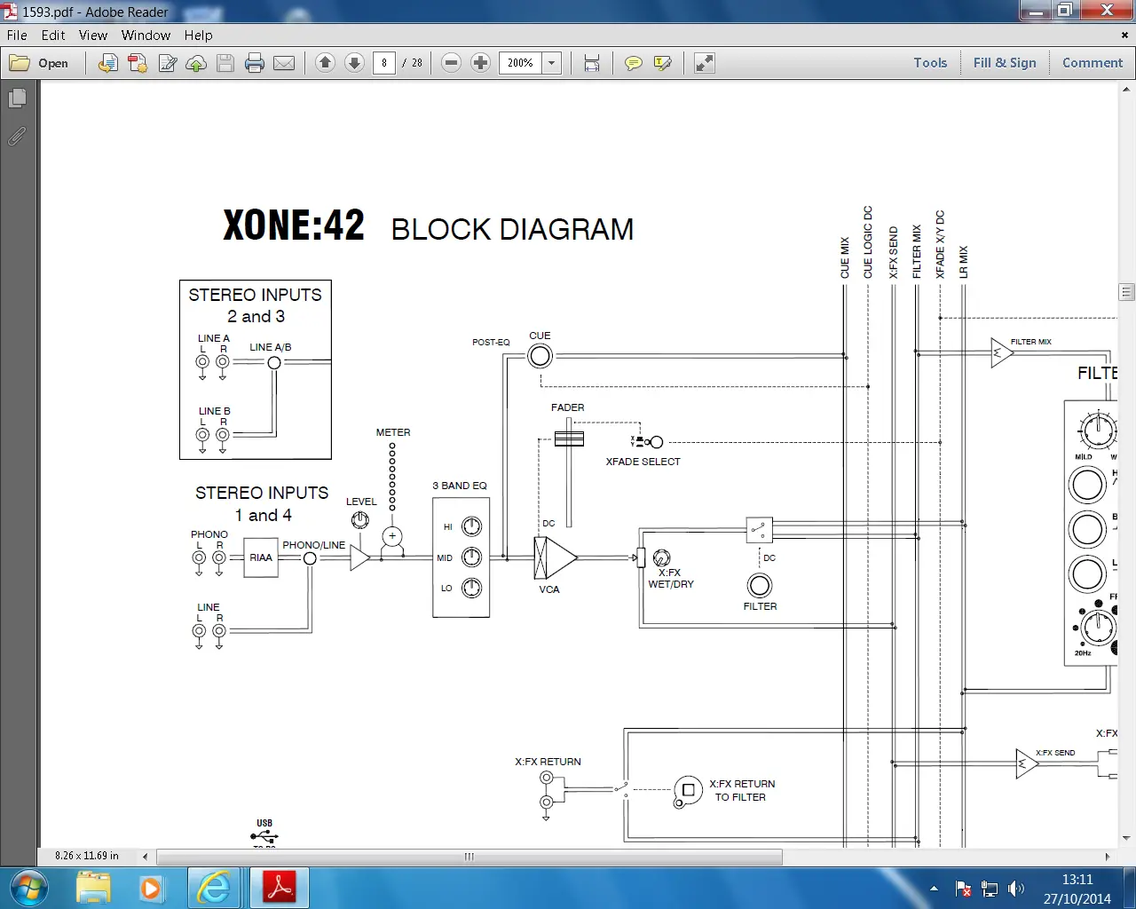

Unless those turntables have phono preamps built in, I doubt plugging them into any of the inputs on the two mixers is going to give a strong signal.
Hi Mike,
The A&H mixer is fitted with pickup inputs....
Hi Mike,
I should have looked it up! First time I have ever heard of a mixer with phono preamp, must be made for the DJs.
Well, not everyone is such a specifications geek as me! Tis indeed a DJ mixer (hence the crossfade control) but there have been conventional mixers with RIAA inputs (beer into water electronically if you already have a mic amp!) One notable one was the Soundcraft Compact 10 (the C4 might have had then as well?) .
Even the odd tape machine! The Revox A77 had phono inputs proving perhaps that it was more "semi" than a semi "pro" machine?
On the other hand, I jumped to the conclusion that the record decks had line outs--most DJ oriented turntables do these days.
If not, my suggested wiring would have to be turntables into A&H inputs 1 and 4 with the Media players in 2 and 3 (for the same reasons as before).
