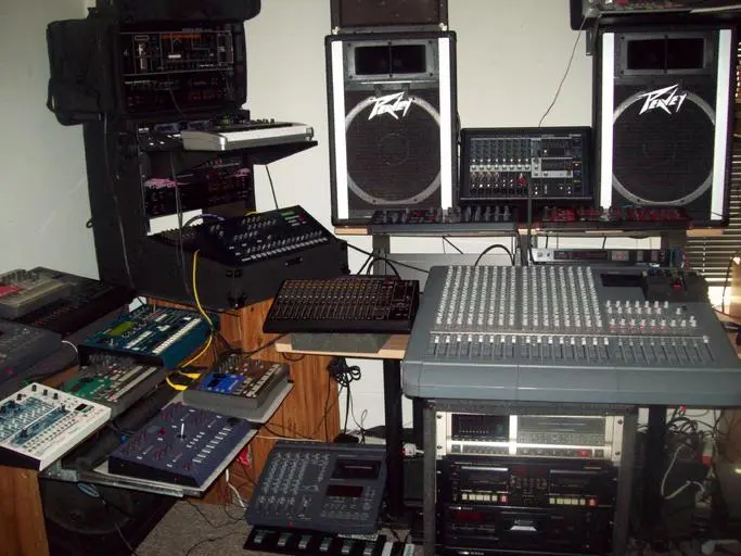

I own a good chunk of recording gear that I use mainly in my "bedroom studio".
I record mostly everything direct into my analog board (Tascam M-2600).
I currently do not have any "near field monitors", and I'm using what I have, which is a couple Peavey 15 inch stage monitors (mids), and a couple Peavey floor monitors on top of them...(saving up for a good pair of N.F.M.).
I do own a Yamaha O2R,..but it is currently getting serviced.

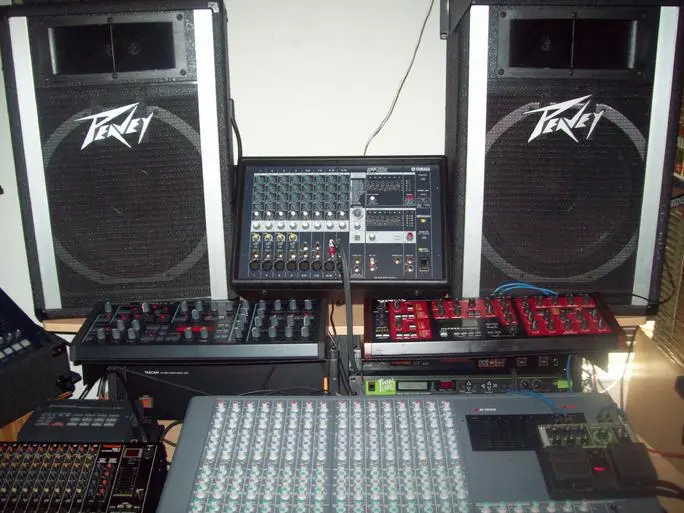

Here is my dilemma:
Me and my girl are putting a benefit show / fundraiser together for a friend that has landed on some very hard times. We are going to have raffles / face painting (for the kids), and about 6 or 7 bands play at a nearby park.
Well without trying to spend any out of pocket cash,..I would like to do the sound for the bands (instead of them playing raw)..and would also like to capture the moment of the fest on tape, disc, minidisc, dat, adat, or hard drive.(I despise the latter)
This is not a professional setting,..but I would like to get it as close as possible to sounding really good,..especially for the musicians donating their time and talent. I believe I have the means (gear) to do it,..so, I'm willing to put forth my best effort.
I do have some experience in sound (like I said,..not a pro) and I believe I have what it takes to make this day sound good.

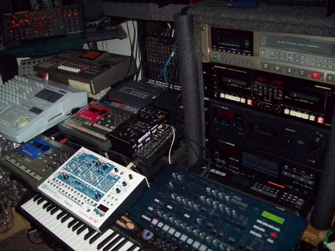

I've played the drums for 20 somethin' years in a few bands, and every concert I go to,..you can find be somewhere by the board checking things out.
Well with that outta the way,..Here's my question..
Like I said before I have a recording console (M-2600) w/ P.S. (PS-2600)
and I also have a Yamaha EMX 312sc P.A.(has effects and compression) along with several outboard effects / compressors/ synths / and e.q.'s.
Can anyone out there give me the best advice on how to set up what I have,.. mainly for the best possible live rig. I know how to connect my outboard gear to my mixers,..But what I'd like to do is use my M-2600 recording console as a "live stage mixer" and then record from my stereo outs.
The PS-2600 power supply does not have any "outs" or "ins" on it (for speakers/monitors), as it is a power supply for a recording mixer.
How can I go about hooking up the M-2600 and the EMX 312sc without blowing anything?
Forgot to mention, that I do have 2 more floor monitors, 2 mids (12's), and 2 floor subs (15's) at my practice spot that I will be using for the event (all connected to the EMX 312sc 300 watts).
Can someone kindly direct me in the best possible setup with this gear, so I can have an excellent sound?..I'll worry about the recording after the sound is properly setup, as it is secondary, and I would just like to capture the moment along with having the bands sound their best. Attached are a couple pics of "some" of the gear I own.
Thanks in advance.

Thanks for the reply
No,..The monitors are not powered...and yes, the 312sc powers them.
The way that you just described is the EXACT way that I have it set up in my bedroom, effects and all.
What I'm tryin' to find out is,..Will it be o.k. to turn it up without blowin anything? I've never pushed it past 2 or 3 being it is in my bedroom, and there are neighbors.
The stereo outs of my M-2600 go to a channel on the 312sc and then the stereo outs of the 312sc go into whatever recording device chosen from there.
I mean...Is this o.k. to do? Should I be connecting a huge power supply w/ recording mixer into a P.A. system? Will it blow anything when I do decide to turn it up? Maybe this is a dummy question,..but I just don't want to ruin my gear. I work way to hard for the toys that I purchase.
Also,..I do have two Tascam MM-1 keyboard mixers (wall wart power supply)
with 20 ins and outs on 'em for a total of 40.
Any suggestions,..To add them into the "live" setup? (still lookin' for the manual if anyone has it - MM-1)
As of now, the direct channel outs of my M-2600 are being fed into my MM-1's for recording.
I'd be willing to take any suggestions anyone else out there might have too.

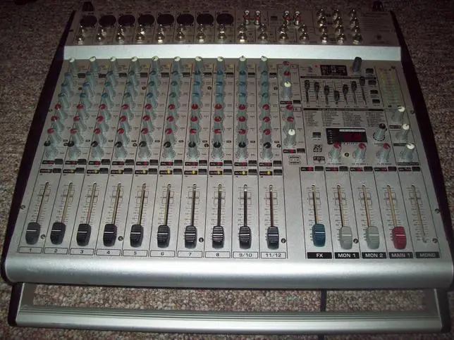

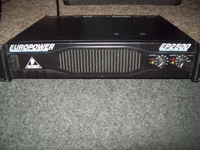

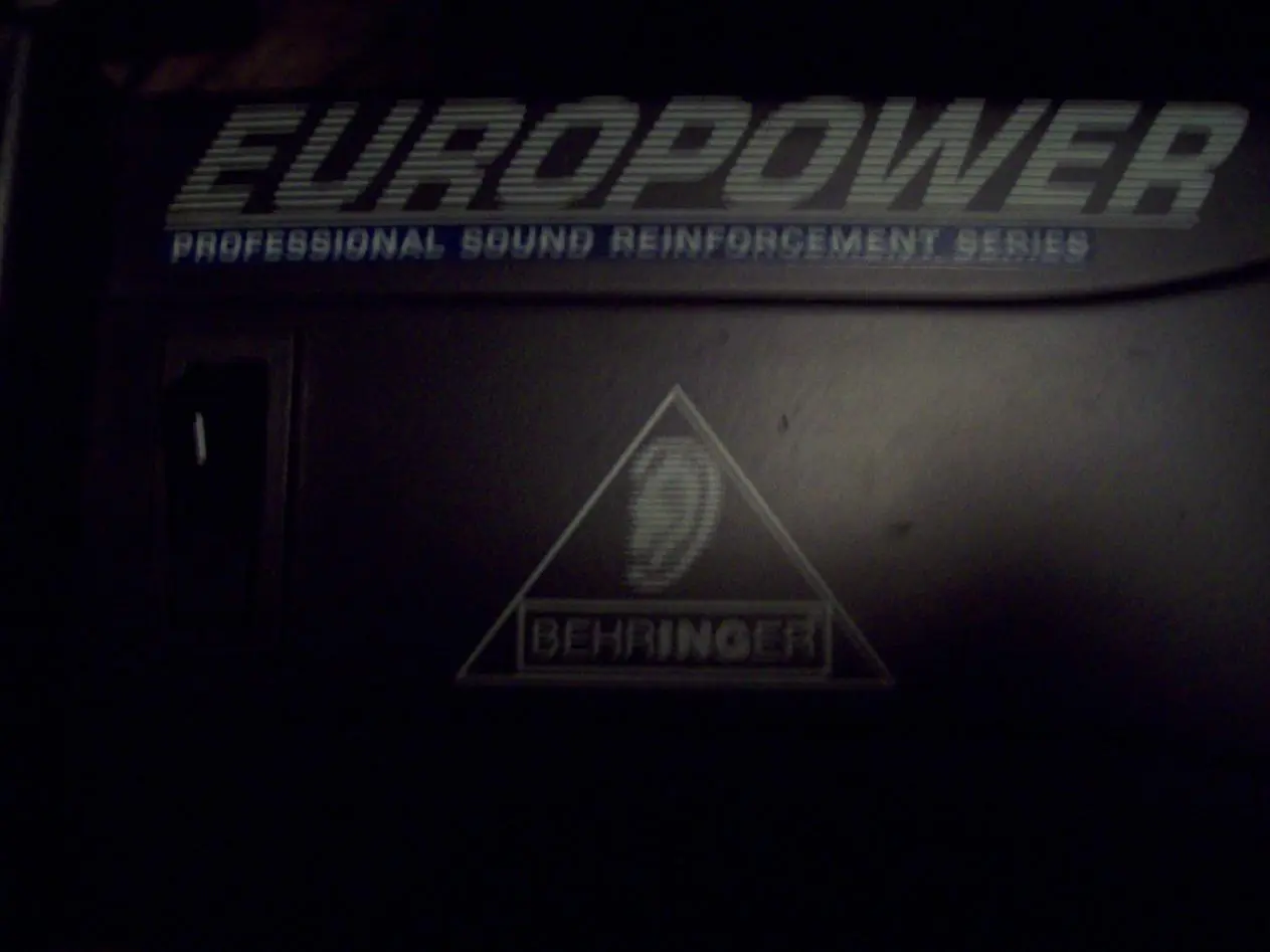

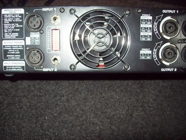

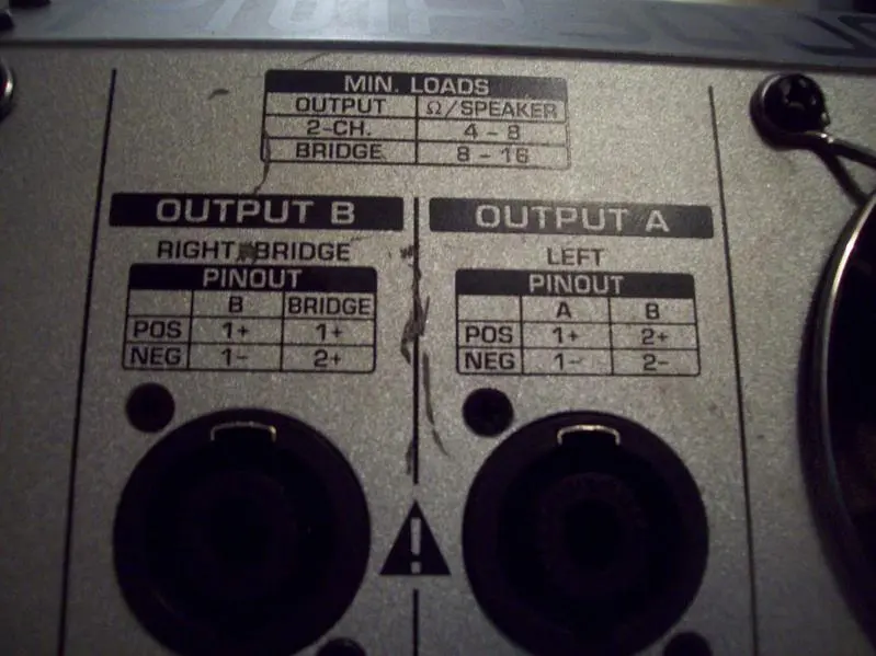

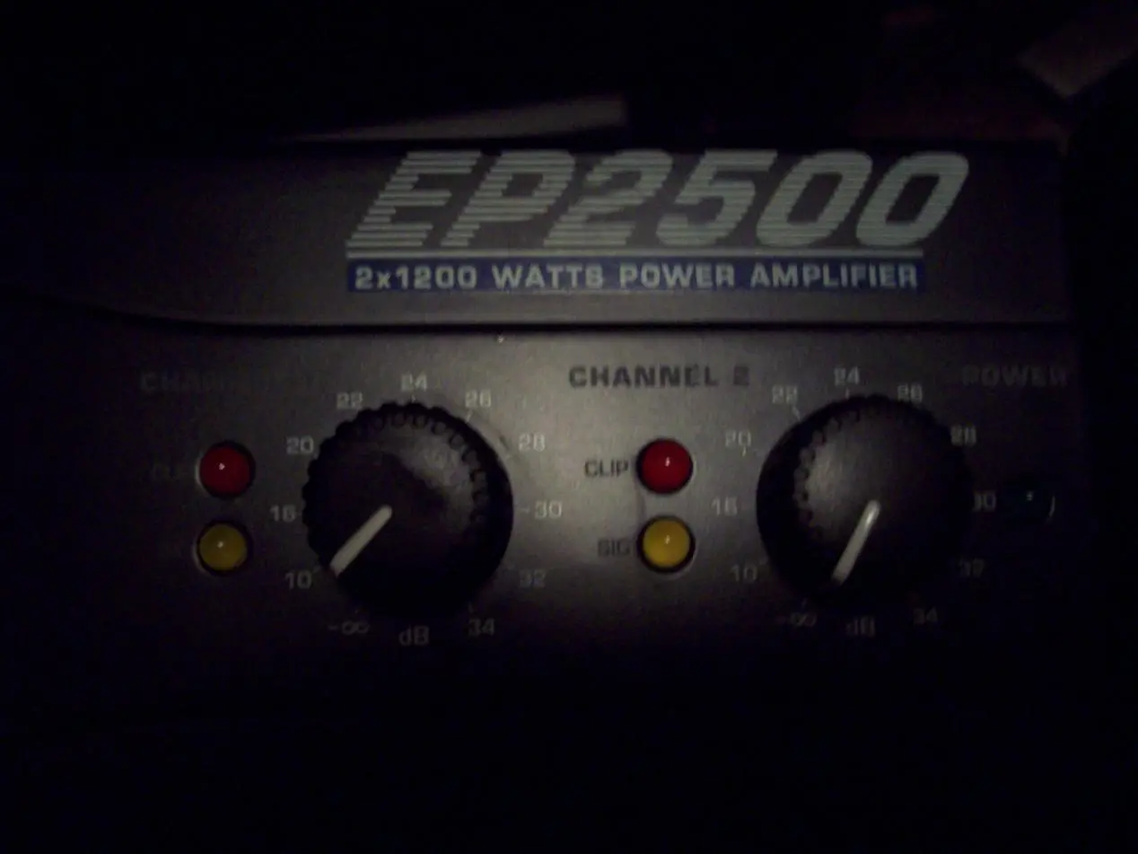

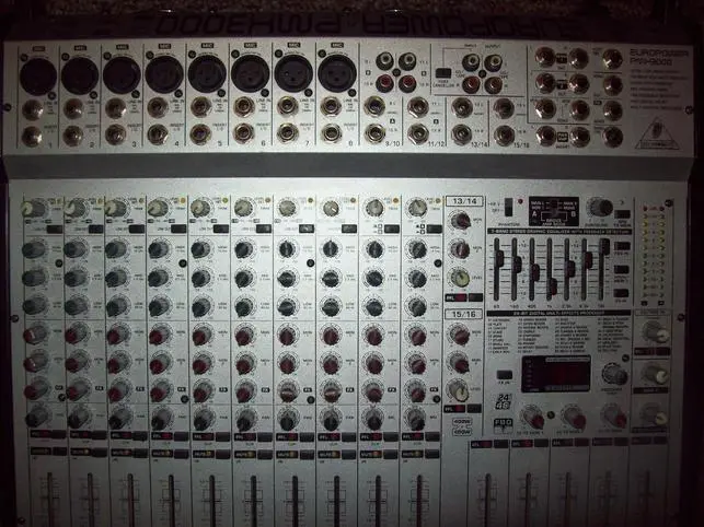

Alrighty,..This just in:
I got a loaner P.A. mixer and Powered Amplifier from a friend.
Not a big fan of Behringer products,..but beggers can't be choosers,..right?
I am grateful.

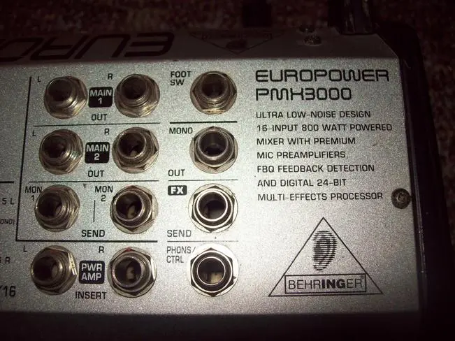

Now the new question is,...
What would be the best possible routing with the stuff mentioned above, for a live setup with recording possibilities?
Tascam M-2600 w/ P.S. , Behringer PMH 3000 16 input 800 watt powered mixer and Behringer Professional EP2500 2 x 1200 powered amplifier with 4 floor monitors, 2 mids, and 2 subs. Also, still have the 312sc and MM-1's to throw in the mix,..but I don't think I'll be needing those now,..unless someone tells me a better way to use them in the recording mix.
I do have ALL the proper cables/connectors and some.
I attached a couple pics with some specs available. Might have to add another reply for more pics, seein' as I'm only able to attach 4 at a time.
I'd appreciate anyones advice on the best possible way to set this up for a live show with recording.
Thanks

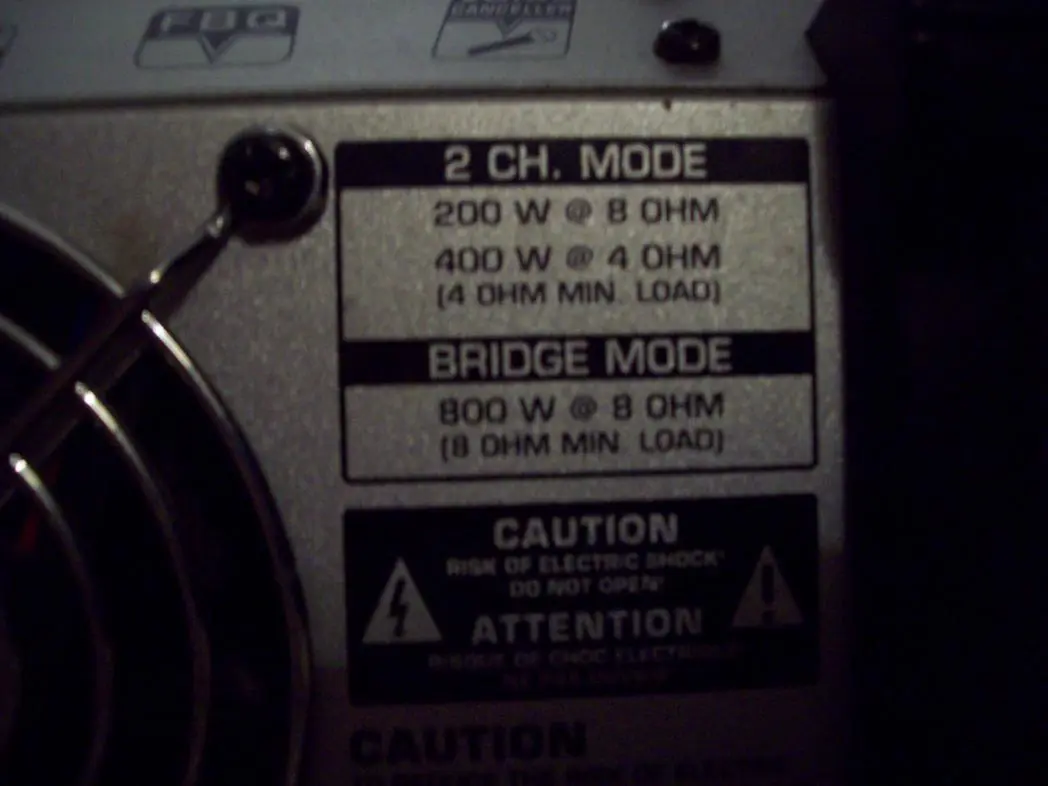

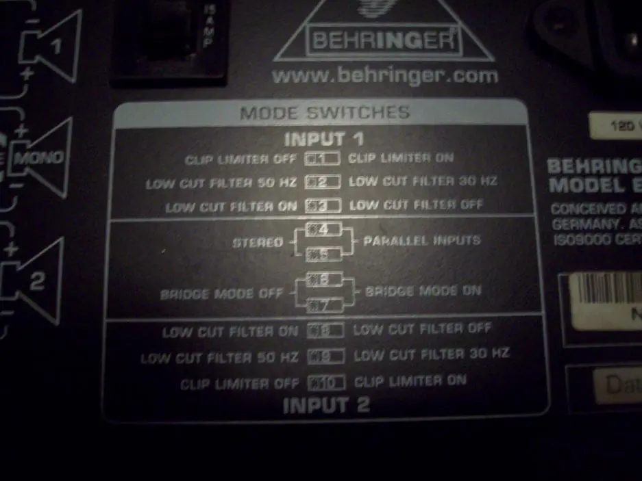

Here are some more pics.

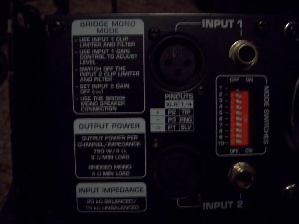

Also,..If anyone can tell me what the mode switches do on the back of the powered amplifier EP2500, I'm curious to know their function.

some more pics
And a couple more...
I hope someone can help me out..with the new stuff I aquired last night.
Just tryin' to get the best possible sound. and recording with what I have now. Oh yeah, I figured out what the "mode switches" are for..but, if someone could kindly tell me how I should set them, along with a good routing
possibility for the new P.A. ,..I would be extremely grateful.
