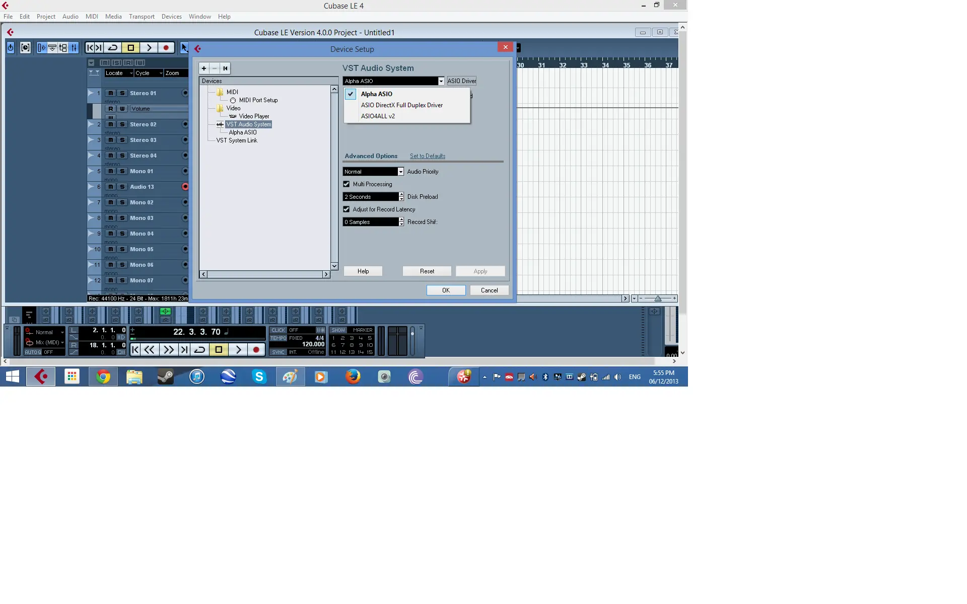

Do you mean by Lexicon Alpha Driver as in Alpha ASIO?

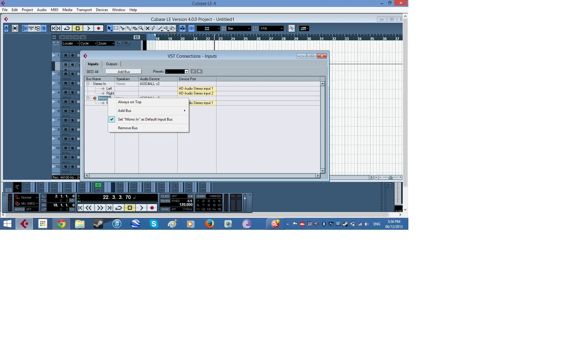

As for the VST I added a Mono bus. When I click on what it should connect to it will just have the option of 'Not connected' and then Stereo 1 & 2.

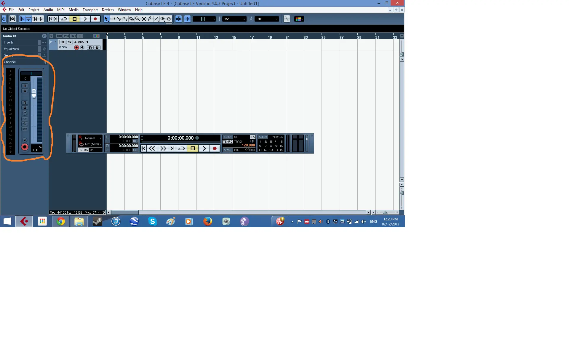

Lastly, the channel. I am unsure about what to click as I only have the option to click the middle 4, 3, 2 or 1.

Yes, the ALPHA ASIO.
Your VST Connections window is showing the wrong ASIO Device. Select the Alpha as you showed from your first screenshot. Then go to VST Connections. Create a 'Mono' input bus and select an input from your Alpha. The default output should be fine.
Right above where you have circled on your screenshot of the Inspector window, click on 'Audio 1' above. That will open the correct page of the Inspector to select your input bus/output for the track. Looks like >] 'input', [> 'output'.
Then arm your track (red target) and make sure to toggle the monitor button on (looks like a side view of a speaker) right next to the record enable button. Hit record and play well.

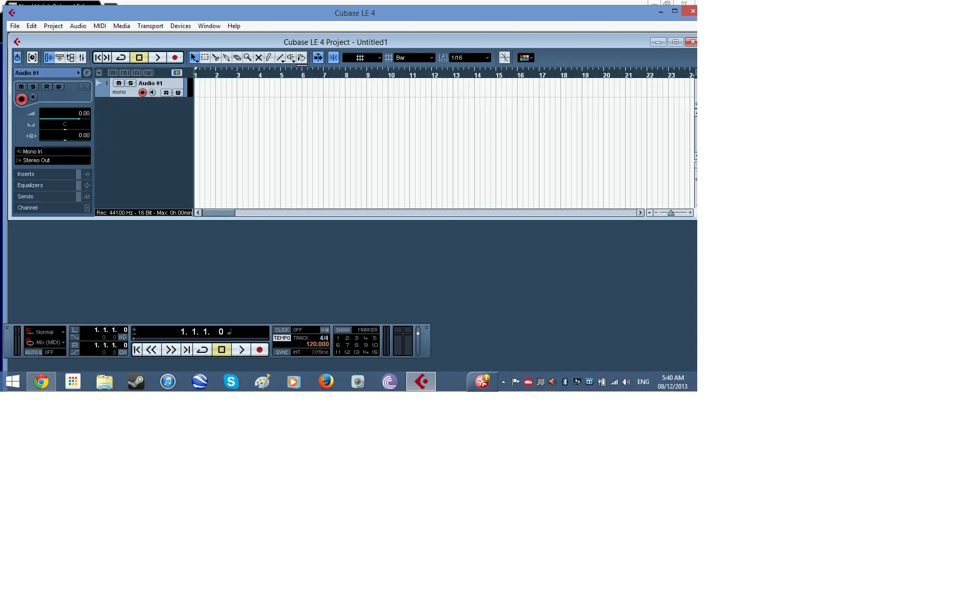

I have figured out the channel and VST problem. Now the main one is still bugging me. I even reinstalled Cubase LE 4 but it still continues to not record anything. I can 100% hear the instrument very clearly yet it seems that Cubase does not pick up the signal between the instrument and the program. I can assure you I've set-up the VST connections correctly but I don't know what to do about this.

Everything looks fine on the last two pictures (Except you don't seem to have any time left to record. See that "Rec: 44100hz 16bit Max 0h00min" ?)
Are you sure you have set up Connections properly? In previous post it seems that you are still using Asio4all and built in soundcard. Or if you have changed anything maybe you could give us updated screenshot of the connections window? :)
Can you play back audio?
