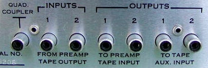

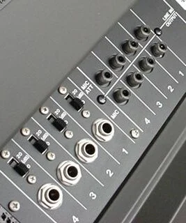

I've enclosed a pict of the back of my reel to reel (34B) and also of the back of the compressor. (The comp doesn't have the usual inputs/outputs you normally see, but it's pretty much a dbx 160VU but at fraction of the price). Thanks ..... Daniel :)
