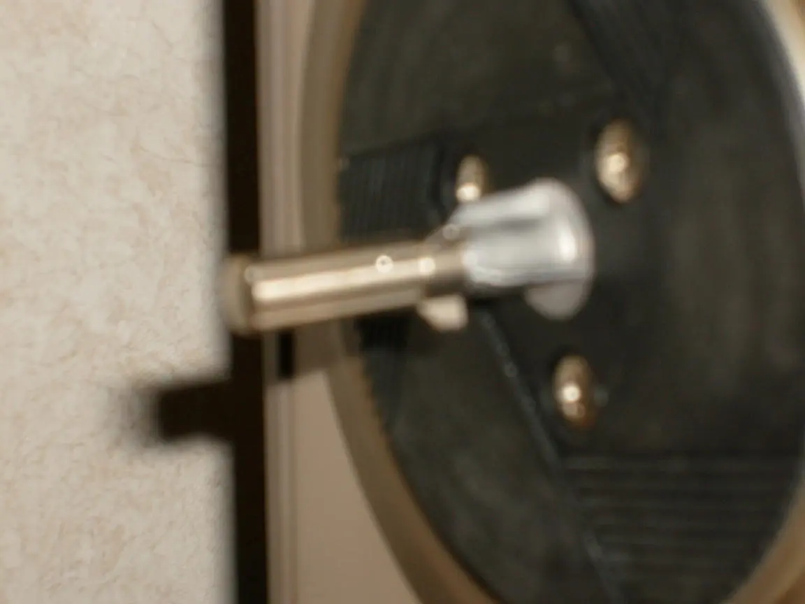

no, not the hub adaptor Cory lol. I'm talking about the actual shaft that holds the hub adaptor or the 7" reel. Looks like the shaft itself is straight, but the locking portion is slightly 'warped' - one sec I will attempt photography.

Ohhhhkay...so you are saying the the trident spindle is tweakered? I, uh, can't tell from the picture... :o:p
Whatever you do, if you attempt to tweaker it back into place, I suggest doing it with the reel table removed from the hub...those motor shafts are surprisingly susceptible to being bent...ANY 1/4" shaft...I'm not picking on Tascam.
Yeah I know better than to try to 'tweak' it while assembled. It doesn't seem to affect the reel rotation at all; it is just annoying to look at when the deck is running lol.

No worries - that part will unscrew all the way out of the shaft, and ther eis indeed a very slight bend. I does NOT affect the reel or the tape path at all fortunately - going to contact TASCAM and see if they have replacement parts for not too much. Oddly while they no longer have parts for many models they seem to still have spares for the 42B.
