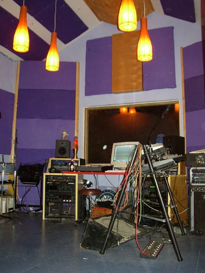

After a year and a half of inhaling sawdust, OC703 fibers, polyurethane and the like, my studio (HUGE sound generation & capture facility) is complete. Well, as complete as any music gear money pit could be.
Check out the enclosed pix...
AirAbove.jpg - this is the view from the entryway/ISO area. It shows the big ceilings and gives you a sense of the basic space.

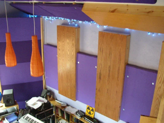

WallTreatments.jpg - this shows the absorptive treatments I have employed. The purple shrouded things are 2" OC703 held off the wall by 2"x2" strips, to lower the effective absorption frequency. The wooden boxes are slightly modified versions of Ethan Weiner's Build a Better Bass Trap. The corner traps (alternating purple shades) are 4" OC703 angled in the corner from floor to nearly the ceiling.

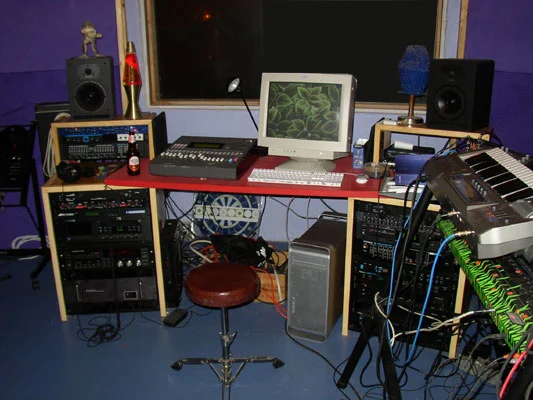

BasicHuge.jpg - My basic work area. Drum throne has worked out well for mobility and fewer cord snags. DAW input gear is in the upper left rack. Older ADAT, DAT, power amps, etc... gear is in lower left rack. MIDI devices are in lower right rack.

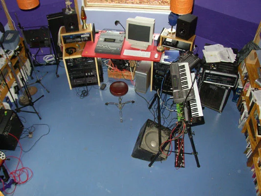

FloorSpace.jpg - the view of the work area from the spousal doghouse loft. Believe it or not, this is my studio when it is clean.
The space is 23' X 16' with a cathedral ceiling that vaults from 10' to 13' at truss peak. Construction is stucco'ed sand-filled cinder block, which provides plenty of isolation from main house and neighbors. I work largely solo, so the idea of a divided space (control, main) was neither cost-effective nor practical. There is a loft at the end opposite the main gear, for when I am sent to the spousal doghouse (not the briar patch!!!). The acoustic treatment was intended to generally control reverberation without losing the bigish room sound (approx 4000 cubic feet). It works really well in that regard.

Very cool. Looks like you have lots of space to work with and a comfortable room.
How does the room sound ?

Vestast - I think the room sounds great, but my aching back and wallet may be influencing my ears to some extent. When it was just a stucco box it sounded absolutely horrible. Now it sounds like it has air, but everything is pretty well controlled. No rumbling bass, lots of clarity. Drums, amps, vocals and my rotating speaker sound great recorded in the middle (not exact middle) of the room.

What is the floor made of? Is that just painted concrete?
Where did you get your 703? I'm in Apex, and I have found some places in Raleigh (I can't remember the name - it's a national outfit with a 3 letter acronym). I wasn't too happy with the quoted price, though (I think it was $1.40 or so an s.f.)

Kevin, I got my stuff from North Brothers in Raleigh. I had to sweet talk the guy and play the weekend warrior card. I ended up buying 60 sheets of it, for about $400, if I recall. I also live real close to the convergence of I-85 and I-40, so I just had a deal with them that when they had a shipment going to Greensboro, Winston Salem or Charlotte, they'd dump it in my front yard. Took about two weeks. I forget the guys name, but he was an older gent and related more to me as a guy with a hammer and saw than a hippie musician, if you catch my drift.
