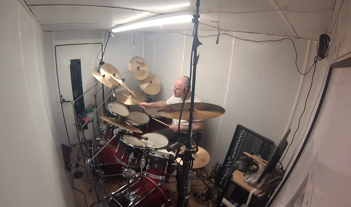

Your space is very similar to my drum room.
I'm no expert on micing, but it is all work in progress, and experimentation.
I have a mic on every drum, using affordable Samson kits, with pencil mics on stands, and hanging from ceiling, aimed at cymbals.

The inside space is actually 2.8m by 2m, which in english is 9'2" by 6'7", so is a tad narrower than Ekimtoor1's space.
It is quite a big kit, but it works.
I could do with a bit more elbow room, when turning to the 18" floor tom.
All the mics feed into a behringer Eurodesk 32:8:2 mixer you see, which has to be vertical.

That’s a lot of kit! Actually an encouragement for my project since I have less kit in about the same space.
Are your walls absorbent ?

It is an 'Esmono' booth. Look them up. The walls contain rockwool, and have perforated steel inner walls.
No extra treatment needed. However, the doors are plain steel, with glass windows, and if situated opposite each
other, can lead to standing waves. I needed two doors, because it doubles as a corridor.
