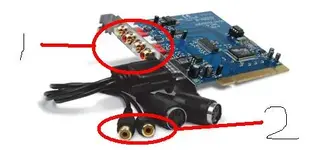

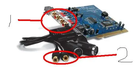

Anyway...posted is a picture of the Audiophile 2496...the card I'm almost positive I'm going to get. I have two sets of jacks circled--labeled 1 and 2. Which set is the RCA jacks? I'm thinking that 1 is the RCA jacks and 2 is the S/PDIF jacks. Having the RCA jacks would be good b/c then I could connect my studio monitors directly to my system. BUT it says in the description that they use RCA and 1/4 inputs...so does that mean you HAVE to use BOTH?...or would you just have to use one or the other (RCA in my case)? And I recall someone saying that 1/4 is better than RCA on monitors, but I'm not sure that this is true. IF it is, tell me, cuz then I'll just get some adapters...but if it doesnt matter, i'll just use the RCAs.
AND ALSO: Should I just make my rack starting w/ the Firepod and add more rack parts later? I think I should get the hang of everything and then move into more parts to make better recordings and such, rather than buy more racks parts up front. This will also be good to just buy the Firepod first b/c it is a rather expensive purchase for me, so I think it'll be better to get more parts later anyway. I was thinking maybe a graphic equalizer b/c u can only do so much in Cubase SE, and w/ a GE, you can get up to 31 bands. That's just what I was thinking, but I'll wait.
I'm very close to making up my mind on my recording studio. I have all the ppl that posted on here to thank. Please keep posting with more info and/or input. AND STOP saying "don't get the Audigy" :eek: ........I GET IT!!!! ;) I'm pretty sure I'm getting the Audiophile.
Thanks again, and keep posting!

1 are indeed the audio input and output RCA connections, and 2 are the S/PDIF connections. As far I know, the Audiophile does not have 1/4 connections. You can just plug the output of a preamp into an RCA input on the soundcard, and you active monitors can go straight from the RCA outputs to the monitors.

As far as the card, atleast go with a audiophile 2496 or one of the Terratec cards (hey! I still use one, the ewx 2496 isnt that bad!)

The sets of jacks you've circled BOTH look like RCA to me. Starting with the Firepod would be a good idea, and I'm still not clear on why you'd want both the Firepod and the Audiophile - the Firepod seems to be able to do everything you want.
RCA cables are usually not as good because the cable is smaller than a 1/4" cable. With cables, usually the bigger the better.
