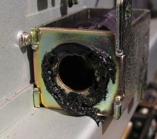

Mine is coming with a brand new on fortunately (pic below). I've had my share of tacky pinch rollers, gooey solenoid cushions (pic below)...the pinch roller and original belts on a Tascam 234 I recently received are the consistency of a cheeseball. Wacky stuff.
