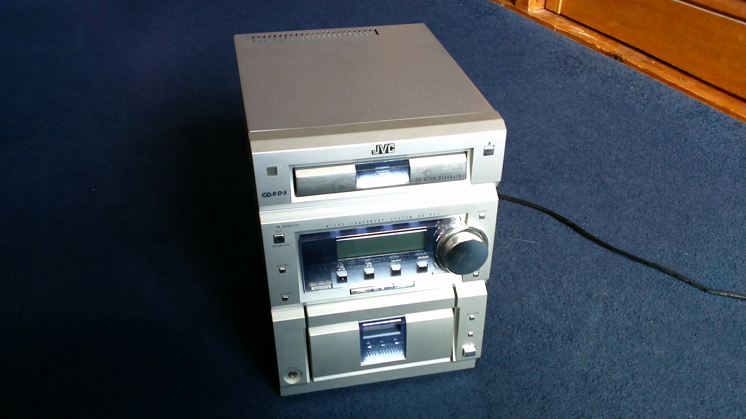

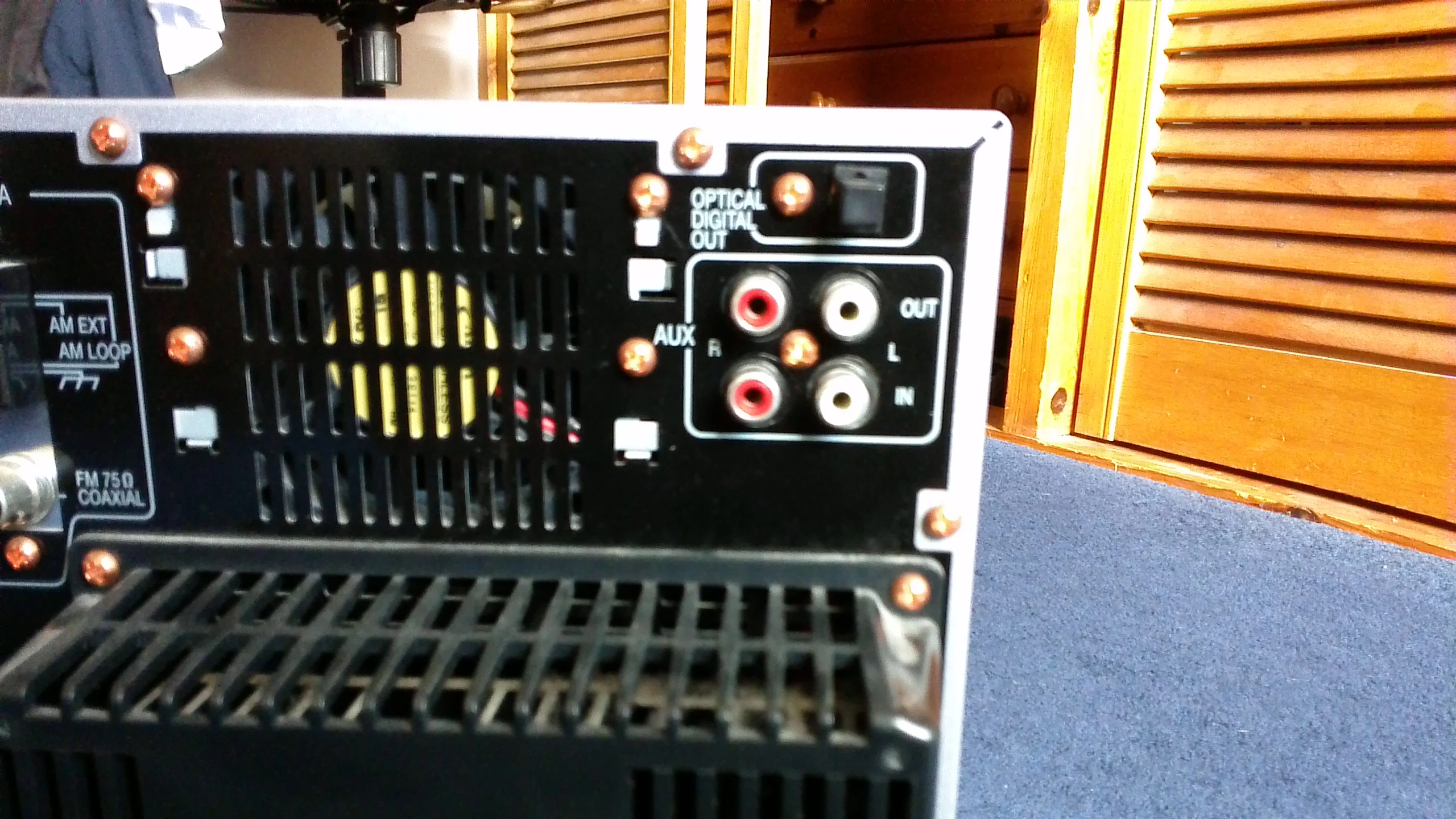

The only thing that's different is that there is also an 'out' phono output on the system I am using. But I dont think that would make any difference.
What has a phono out?

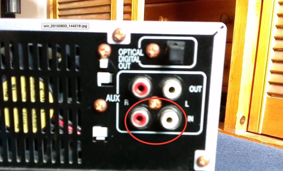

But here is the pic to help you understand.

Here's the image again.
If it doesn't work, for some reason, I've circled the bottom two phono sockets.

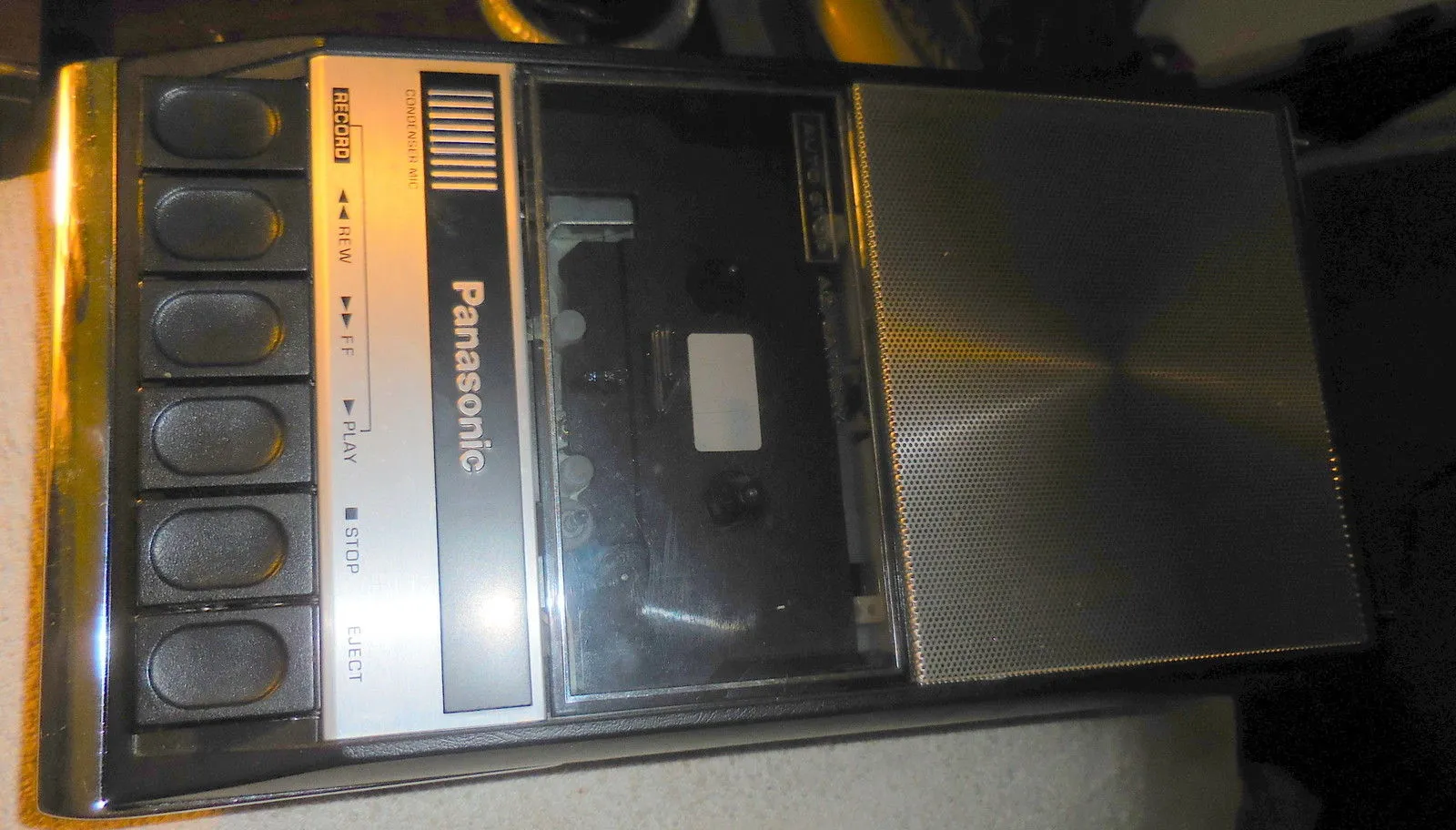

And not all cassette recorders sound crappy! Although, I agree that the vintage portable cassette recorders --- assuming he's talking about something like the attached picture --- probably isn't going to provide stellar audio. :)

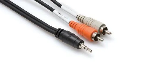

Yes, you should use a cable like the attached photo. Note the single plug end (the 1/8" end) has two black bands on it. This is very important.
Attach the 1/8" end to your computer's headphone out and attach the white (or black or gray) RCA plug to the white jack that Steen circled and attach the red end to the red jack that Steen circled.
If that doesn't work (and your headphones work in your computer), I guess the tape deck is faulty.

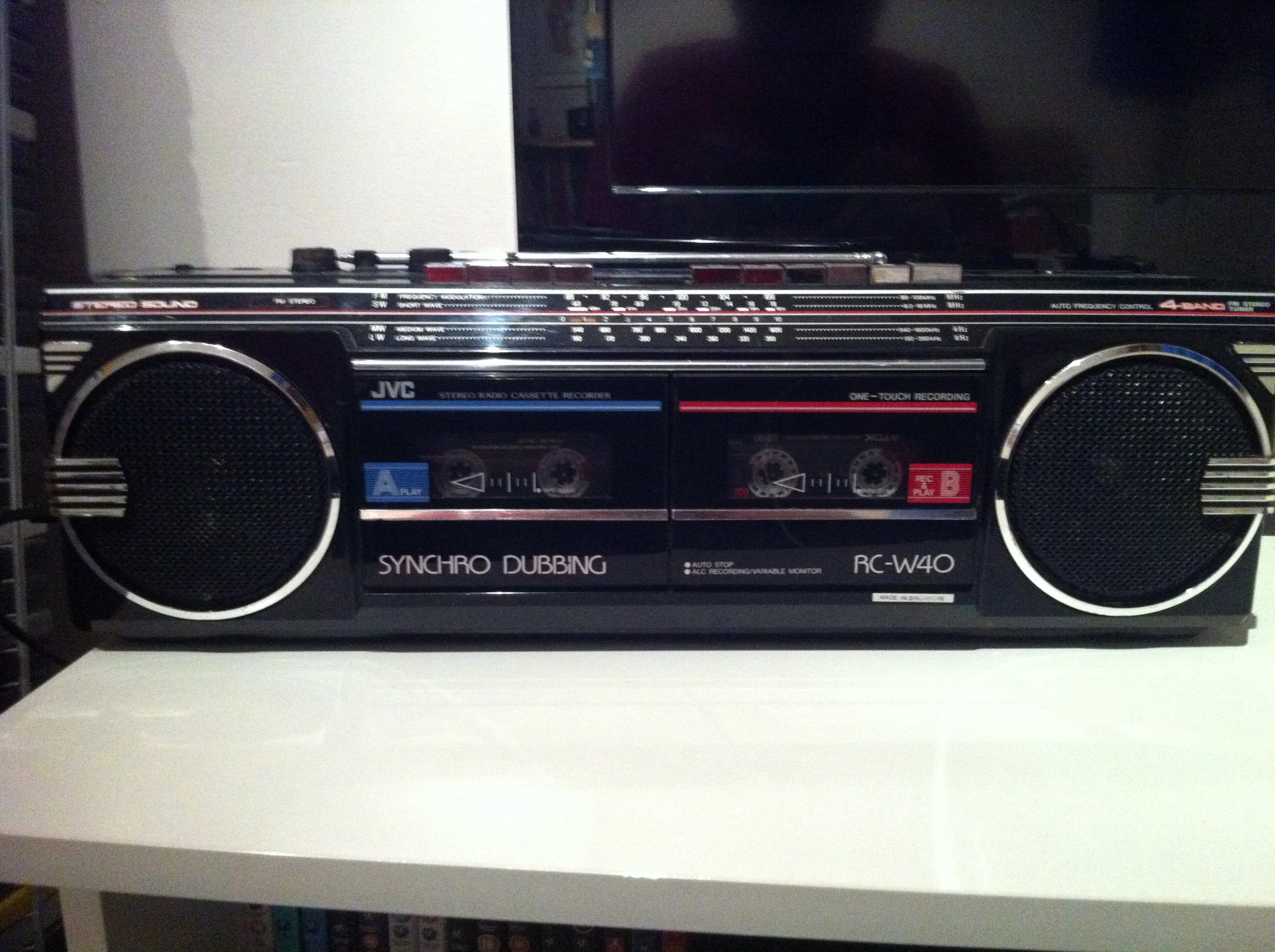

Its funny though that when I went to test the cassette in my ghettoblaster I inserted it into the right cassette slot, I usually use the left one but as their was a cassette already in that slot I thought nothing of it and used the right. The sound came out of both speakers but sounded muffled, I was very disappointed. But after further investigation I have found that the right cassette slot play's back muffled sound while the left one is clear, so in the end the recording was fine just my equipment was the problem haha.
Glad to hear you got it working. It sounds as though your right cassette slot may need to be cleaned and/or demagnetized.
