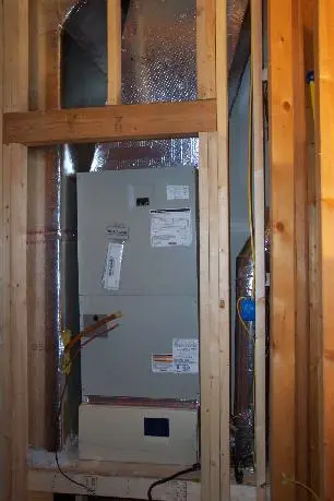

The inside unit gets set in the mech. closet.
(That's a high efficiency HEPA air filter below the unit)

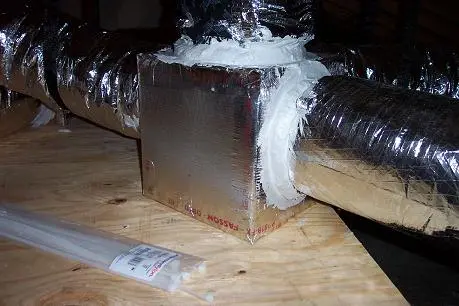

The air distribution boxes are set in the plennum above the bathroom. This is as far away from the air outlets as we could get it. So, all the critical runs are as long as possible.

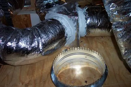

Above the Control Room a series of bends and turns are made for each line that goes to its specific room.

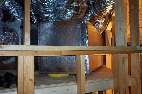

More bends.

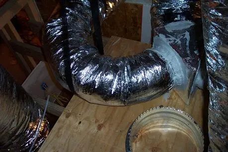

And still... More bends.

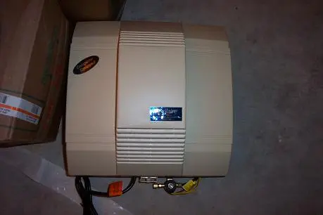

This is an automatic humidifier that still needs to be set.

That air is gonna be tired by the time it gets around all those bends! What's the white stuff on the plenum connections and on the junctions?
Looks great though...
Mike
That white stuff is how they seal it.
Simple duct tape will loose its adhesion after time.
This stuff is like plastic; it'll last for ever.
