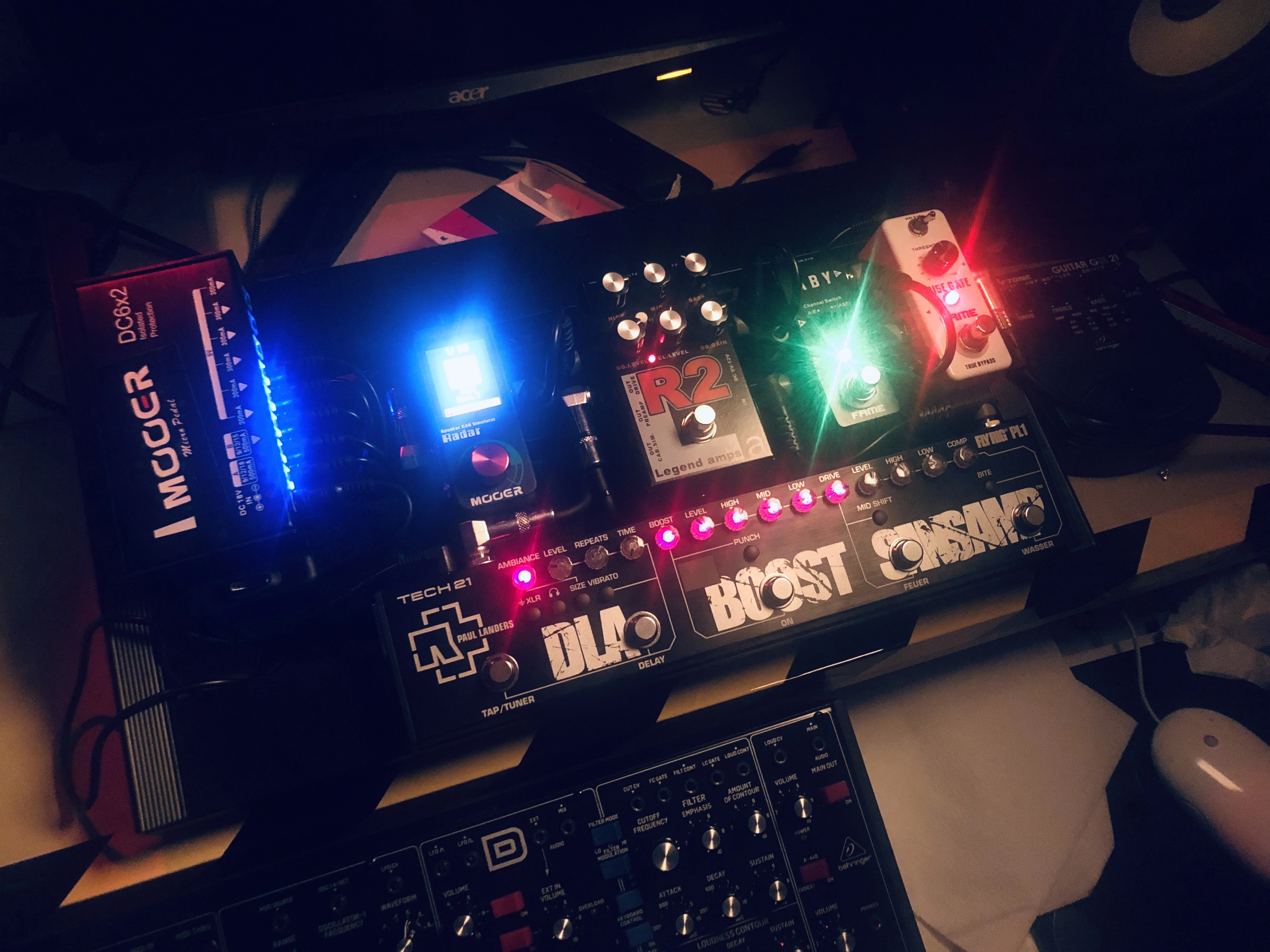

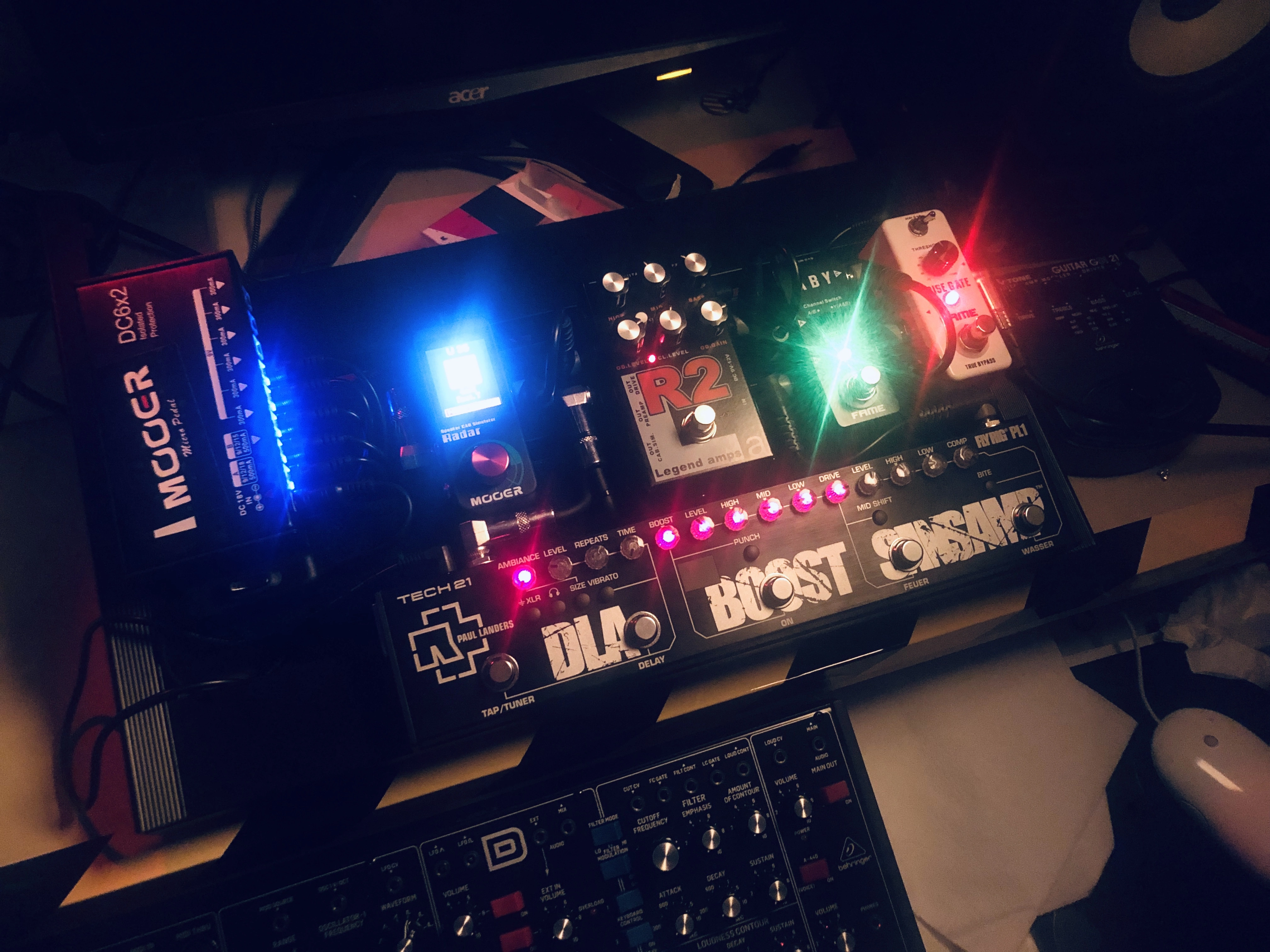

Hello, so this is the sequence:
Ibanez RG with SD JB4 -> Noise gate -> ABY pedal:
ABY output 1 -> Flyrig PL1 -> Motu ultralite input 1.
ABY output 2 -> AMT R2 -> Mooer Radar -> Motu ultralite input 2.

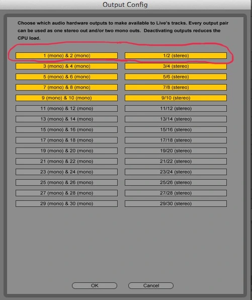

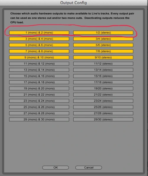

I’ve attached a file with Ableton’s channel configuration, where it’s gives the option to get those two guitar inputs in these two ways:
1 (mono) & 2 (mono) or 1/2 (stereo)
And here is where I’m constantly stuck ? I don’t know which way is the best from a mixing standpoint. I hope it’s a little more clear!

If you do the 1 mono & 2 mono, you can pan the channels anywhere you decide to during the mix. If you do the 1/2 stereo, the two signals are permanently panned wide...which is the same as the two mono tracks panned wide.
Thanks for the input, but for some reason the stereo and the two signals panned wide don’t sound the same ?
There is something goofy in the configuration then. There should be no difference between a stereo file and two mono tracks panned wide.
If you record only one channel to a stereo track, what happens. You should only get sound on one side. If anything else happens, there is a routing/configuration issue.
A stereo track is nothing more than two channels locked together in one file.
