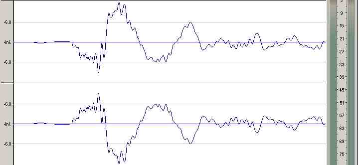

That's not how it works. It's not moving "in and out of cancelation" in the sense of phase induced comb filtering. The only cancelation is between the two versions of the side channel, which is 180° out at all frequencies. The cancelation is the same at all frequencies rather than more or less depending on frequency. When done correctly, the stereo image is purely amplitude based.
It's important to distinguish between phase and polarity, two related but very different phenomena. Phase, in the specific sense, is a product of a time difference between two signals that have content in common. Polarity is the relationship between the positive and negative aspects of the waveform, whether that's pressure, displacement, voltage or whatever. Phase discrepancies will cancel different amounts (and add different amounts) at different frequencies, depending on the amount of delay. Polarity inversion will cancel equally at all frequencies, thus no "phasey" sound. If there's a "phasey" or hollow sound, it's probably from room reflections or some other source. Also, if the mics themselves don't have essentially identical phase response, that could be a problem.

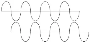

I don't usually bother with the "er, well, achsully it's polarity, not phase" but it is important in this context because one of the main benefits of M/S is that it's impossible to have phase issues.
Phase issues are the result of sound arriving at different microphones at different times and are with reference to a particular frequency.
With two mics unequal distances from the source you can move one of them back and forth slightly, altering the frequency at which they're out of phase.
With polarity (180 degree, anyway), it's either in or it's out.
The reason you hear anything at all with your wide panned opposite polarity tracks from your fig-8 mic is just because of the differences introduced from your speakers, their positioning, the room, the asymmetry and uneven density of your head (not an insult 😂 ), etc.
As you move around in your room, the degree of perceived cancellation will change, so that's the phenomenon you're hearing,

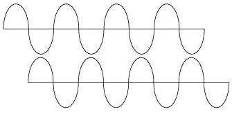

That image ^ is an example of waves out of phase - Not opposite polarity.
Notice they start at different times. That's because they arrived at the microphone (in our world) at different times. I.E. One mic was farther away than the other.
There's theoretical perfect cancellation there except for right at the start and right at the end, when one track is flying solo.
Consistent cancellation in this example only works because it's an unchanging frequency.
Once you do it with real audio you'll have cancellation at that ^ frequency but the majority of the audio will be fine. (look up comb filtering?)
