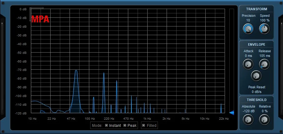

My first comment is that all of the ART preamps had 60cycle hum which got progressively worse as you went through the selections. All the the preamps start out with noise levels between -110 and -120dB.
So I looked at the last 8 seconds of each preamp. That's where the total system noise is most apparent.
The MPA 2 had lower hiss than the DMP in all cases. What isn't known is the available gain. If the DMP gets 20dB more gain, then it would offset much of the advantage.

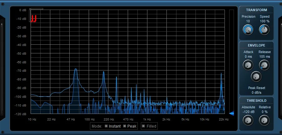

RE the tubes themselves, I rate them 6, 4, 3, 5.. Which would be JJ, TngS, RCA, TF. The JJ and TungSol both had similar levels of apparent "hum". The Telefunken had lots of buzz with lots of higher order harmonics which makes it even more intrusive.

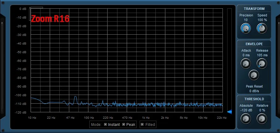

The Zoom preamps were pretty much consistently at -110dB across the spectrum with little if any 60cycle hum.
Here are four spectrum captures. The MPA is the first sample. Then the JJ and Telefunken tubes in the DMP (best and worst), and finally the R-16.
Again, these numbers are a bit meaningless unless you can compare the amount of gain this represents. If the Zoom does 40dB of gain and the DMP does 80dB, then that hum drops from -70 to -110dB in direct comparison. However, of the tubes, I would be choosing the JJ. The Telefunken has roughly 10-12dB more harmonic at 240Hz and 4 or 5dB more at 180Hz. Those harmonics are very apparent where the 60 cycle might be masked by speakers with bass roll off although all would be apparent with a sub.
