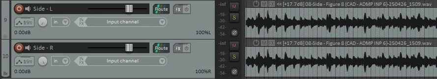

The problem that has cropped up is that Tracks #2 and #3 together are producing complete silence! I assume this is because they are cancelling each other out due to the identical content and opposing polarities. But it was not happening before. Does anyone have a idea what I might be doing wrong? Please let me know if I need to provide any more detail or upload the WAV files.

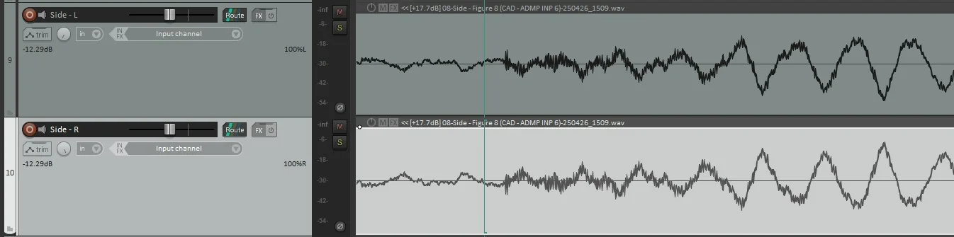

Did you look at the two tracks and confirm that they are indeed inverted? Simply zoom into the wave from and you'll see if things are flipped immediately. If so, then your issue has to be somewhere in your routing. Are you trying to combine the two side channels to a single channel to control the M and S balancing? Are your sends hard panned L and R?

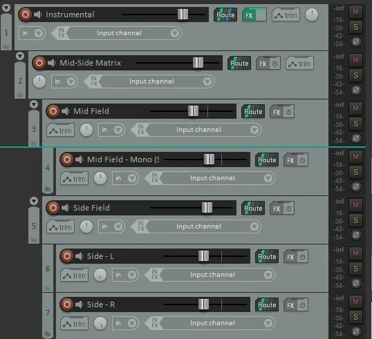

Hi TalismanRich:
Track #3 is, indeed, phase inverted (see attached). In the case pictured, I am using the item property "Invert Phase" rather than the UI button on the track control since it provides the inverted waveform image. But either method produces the same sonic result.
I do have the mid-side tracks grouped in a hierarchy: The top level is "Instrumental", then "Mid-Side Matrix" and finally "Mid- Field and Side Field (see attached). As you can see, the pans are hard left (Track #2) and hard right (Track #3). There are no signal routings except from the "Vocal" group (not pictured) to the "Instrumental" group.
