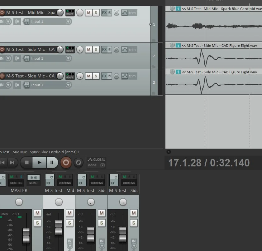

I took the same files and put them in Reaper and got the same result. Here's my mix, and the setting in Reaper. I inverted the file by going to Track Properties, and phase invert. This suggests that it's not a problem with the recording, but something in the mix. BTW, I grouped the two side channels so that they move as one for volume to adjust the image.

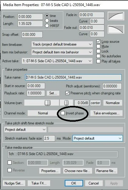

Thanks again for you efforts :-) You mention "Track Properties". I have looked everywhere in my version of Reaper, and I do not see track properties. Are you referring to the "Invert Phase" checkbox in the Item Properties? (see attached) Or do you actually have a "Track Properties" option? If so, how do you access it? Please let me know. Thanks!
Sorry, that's where it is. That way I could confirm that the waveform was inverted, which shows in the picture. I shouldn't try to do things by memory! :unsure:
I don’t understand - the CAD file is Mono - how did you get a stereo track out of the mono file?
That's the trick with M/S. The CAD is in figure 8 mode, and you copy the file to a second channel and invert it. Look at the picture of the Reaper setup I put above. You can see the two "side channel" tracks are inverted. Those are both the same file.
If you talk into the right side, the "left" side signal is effectively cancelled out by the inverted "left" side of the other track. The "right" side predominates. By itself, it sounds really hollow in the middle, though, so you had a cardioid mic to provide the center. You actually end up with a stereo image.
