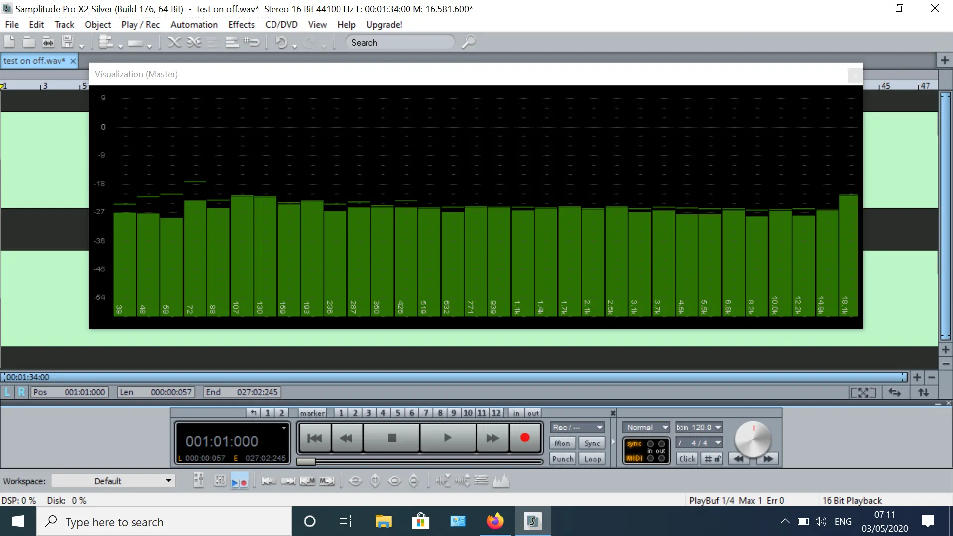

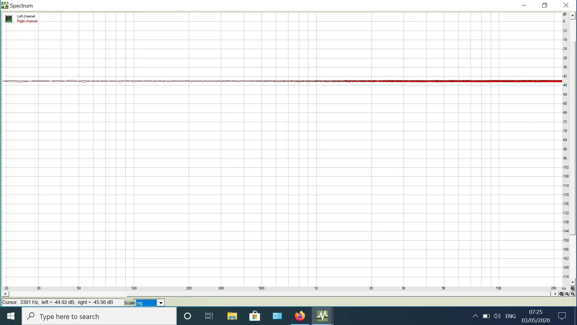

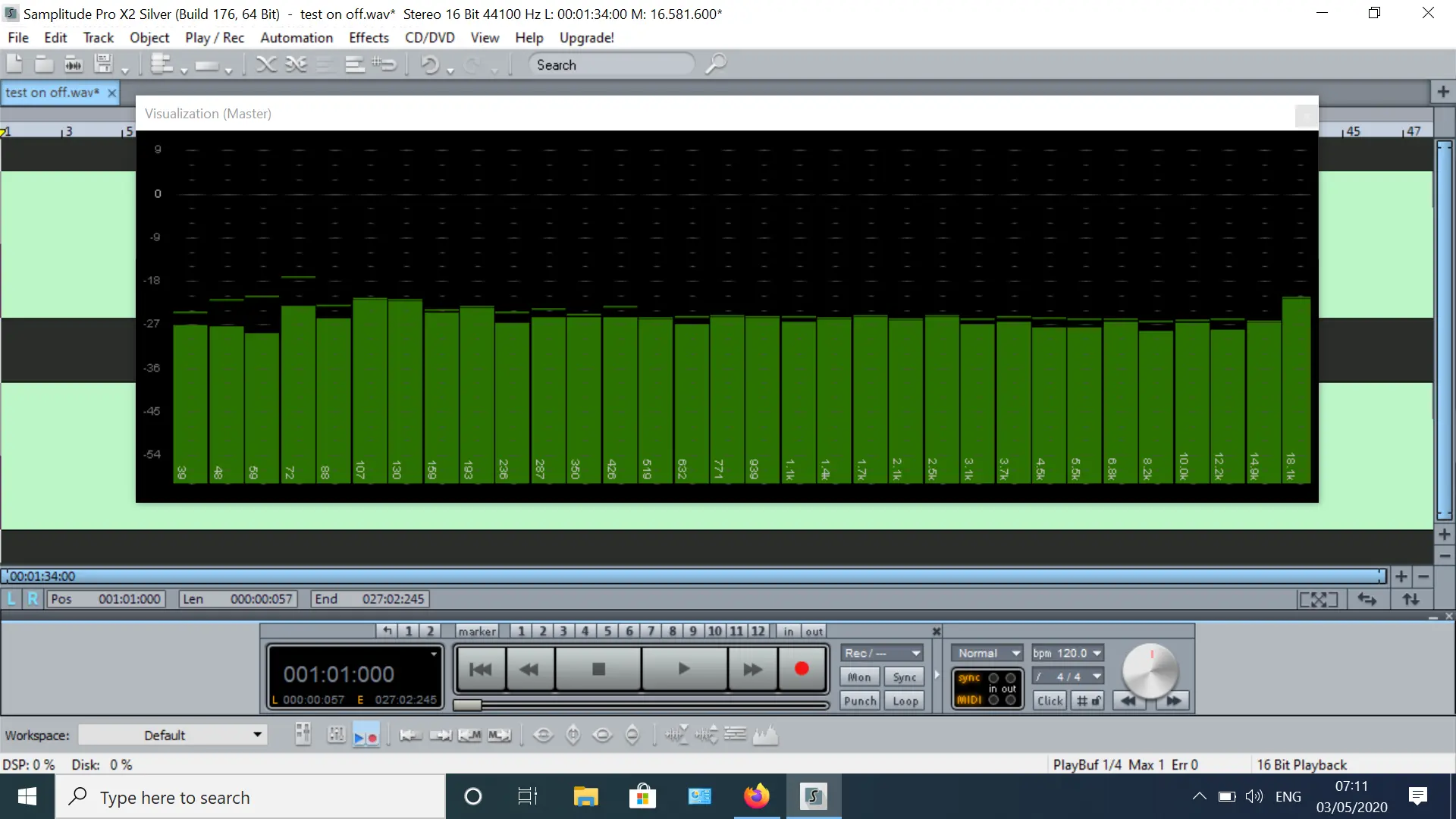

I normalized the clip to -3dB fs but still just got white noise. The screen shots are of an instantaneous 'grab' of Samplitude's spectroscope and a spectrum from Right Mark of the whole thing. Again, pure white noise.
*Now, yes I AM clinically deaf in both lugs. 30dB down on normal at 2kHz and off a cliff thereafter...BUT I can hear sub 200Hz as well as normal people!
Dave. (BTW. How did you use WeTransfer? I thought you could only send FROM email TO email addresses?)
