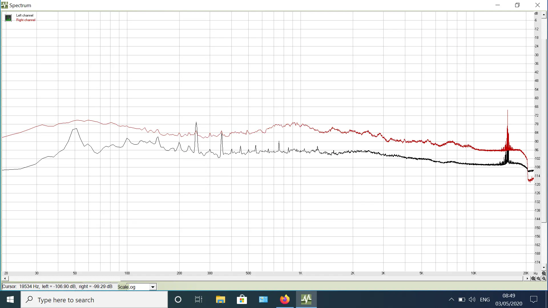

Attached is a clip of very early morning in my garden. The crash is a hedge hog flipping a plastic bowel.
You can see from the spectrum (pre crash) that although the noise follows a 'white' spectrum is has curves due to the response of the mics. There are also odd noises off that you will always hear on a high gain mic recording. Note also the 50Hz hum? That is due to lack of WD-40 which the mic conns' need once a month or so!
WTGR I suspect your recordings are just electronic noise?

Err? Not quite! I am saying you are not picking up the 'room' at all otherwise there would be a response curve and odd clicks.
The mic gains on that clip are practically wide open (a Behringer X802) have to be to capture hog snuffles but if a pigeon lands too close to a mic even wing flaps push things to 0dBfs. I actually have a recording of a sonic boom of a year or so back. That went well over!

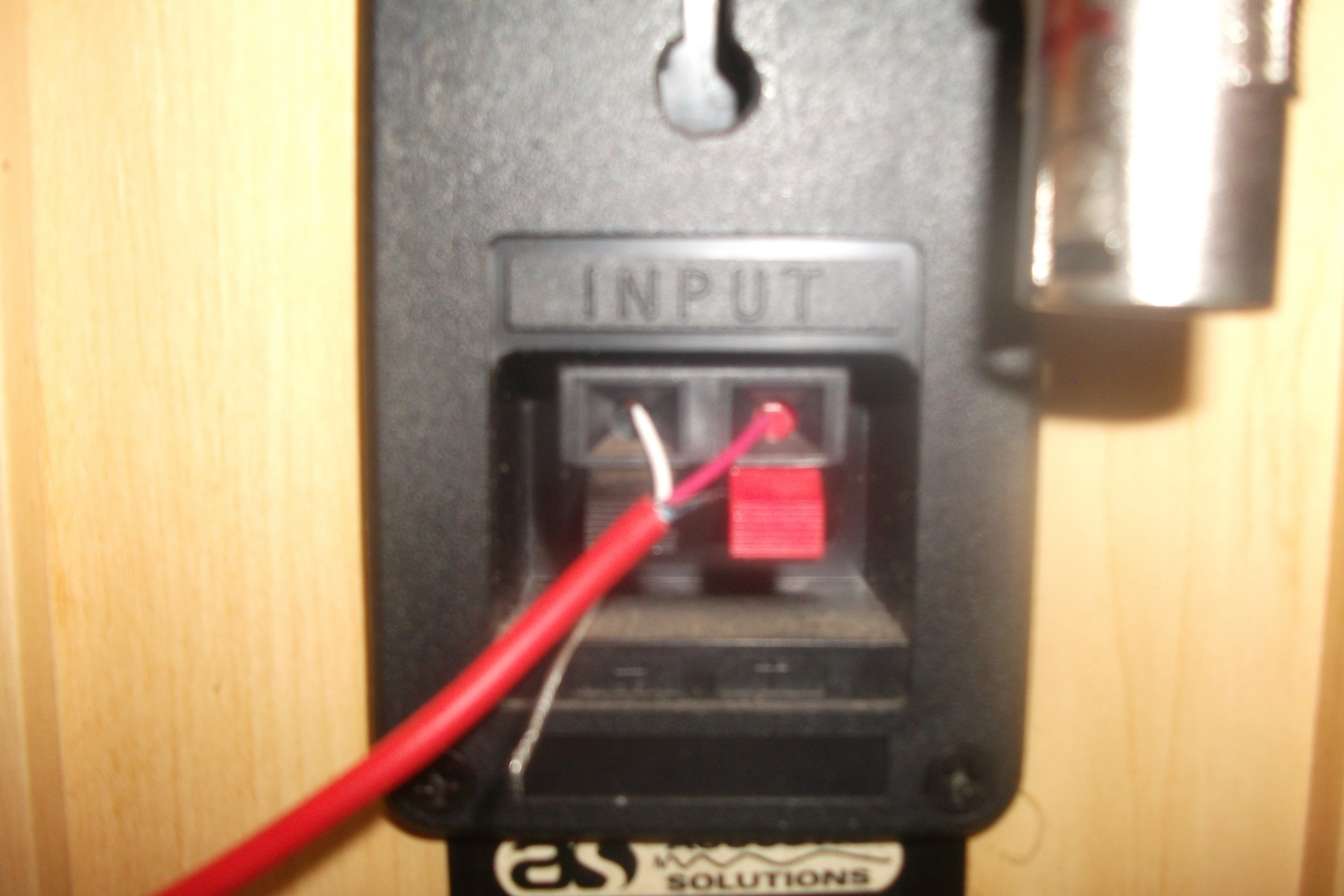

Just get a gash 'hi fi' speaker and connect the two cores from an XLR cable to it (Ideally screen goes to speaker chassis but probably does not matter much) If THAT does not pickup the LF then I think you need to take more water with it!

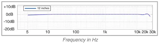

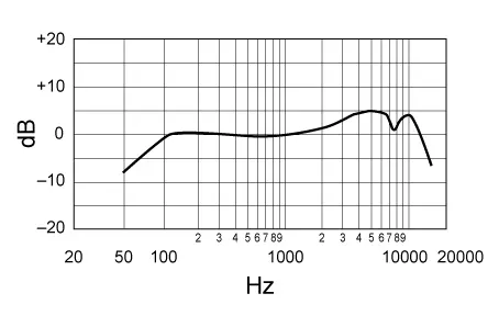

You're not going to pick up much below about 50Hz with most conventional microphones. If you look at the response curves of the majority of commercial microphones, you see a serious roll off, usually in the 10-20dB/octave range below that point. You can't necessarily go by the claimed "20-20kHz" spec on most microphones, because they NEVER state the deviation from 1kHz, which is the way most electronic equipment is measured, like interfaces and amplifiers. Mics will have deviations of +/-10 or 20dB which is HUGE!

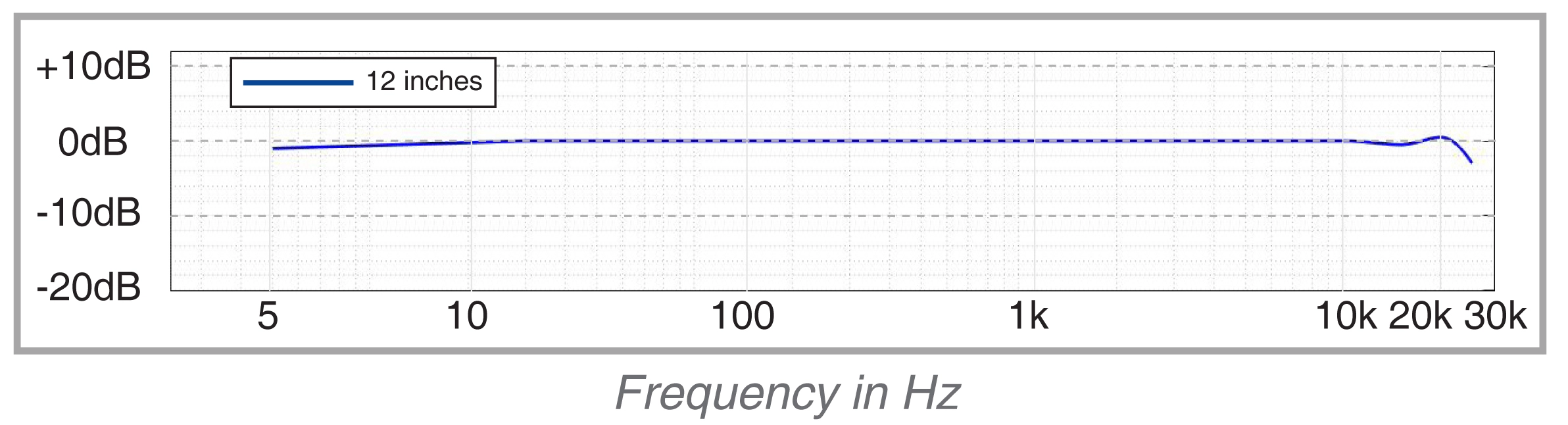

If you need to record sounds in the 10-30Hz range, you need to be looking at an omnidirectional measurement mic, such as the Earthworks M23, or the Audix TM1. The Earthworks has a response down to about 5-9Hz, which is subsonic. If you can't record it with that, then you really don't have a problem.

If your microphone can hear it, the DAW should record it.
FWIW, this is the response curve of the M23.
This is the response curve of the SM58.
See the difference?
Attached is a rather blurred shot of the back of a small speakers with an XLR 'tail' connected.
If you cannot make up such a cable you can donate a mic lead.
Tomorrow I am going to put that speaker on my living room floor and run some LF tones through my system and record the result.
The point you asked about 'enhancing' the recordings? Don't IMHO or if you do make it abundantly clear that you have only done so for better clarity and have the original, untreated .wav available for scrutiny.

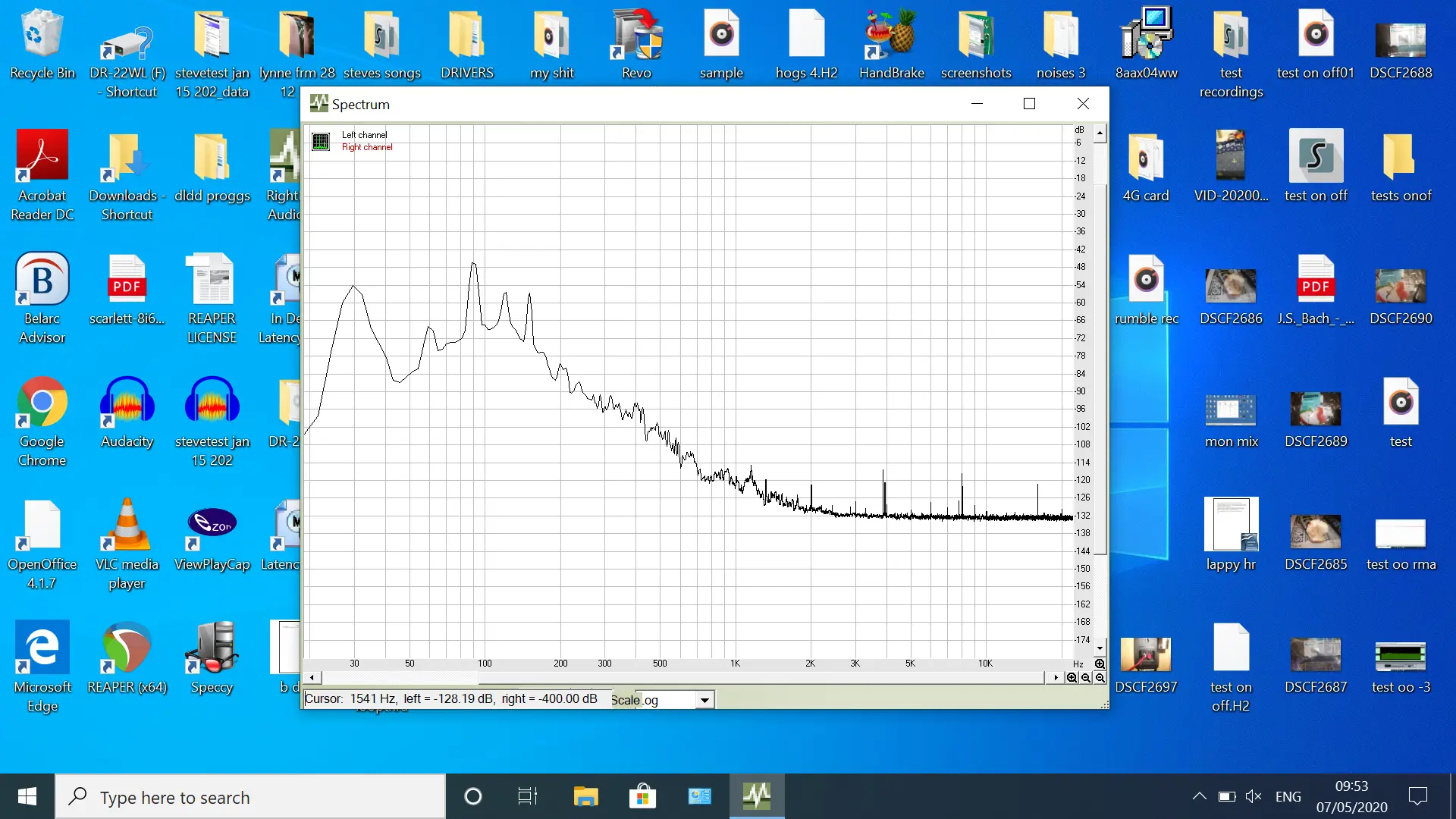

Ok, just done it. Attached is the 30Hz tone* repro'ed through my home hi fi (kept level modest but still annoyed wife!)
The analyser plot is interesting? You can easily see the 30Hz picked up by the very small speaker, 4" woofer but the third harmonic at 90Hz dominates. Whether that is my speakers distorting or the wee one acting as a microphone I cannot say, bit O both I would guess.
Still, the principle works and you can use a relatively small speaker to record very low frequencies.
The speaker BTW was plugged into my NI KA6 and the mic gain whacked to max.
Hope this helps.
* I tried to record a 20-100 sweep sine but that did not turn out well.
