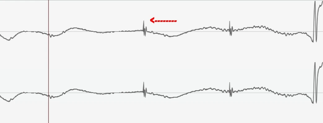

You've got a gremlin in the works. The waveform has lots of nasty little miscoding in it - the ones that line up with starts of notes are just more obvious - but they seem to be random bits of noise, or VERY steep jumps in the levels - and speakers cannot cope with these nor the electronics so the little clicks are the harmonics from the very sharp almost square wave start.
Cause wise? probably not levels, because those clips were modest in amplitude - so probably either a dodgy driver, which could always be removed or updated as a start, or a proper hardware fault - but that would be rare, I think. If you plug the DI output into some other device that would either click or not click. Not clicking points again to the AD process but if it did click, then if it's an active DI - could that be the problem? I don't think it's static, despite sounding like it - but the waveform suggests something else. If both pickups do it, discount the bass, and look for electronics.

The thing that leads me to doubt static is the fact that most clicks are aligned with notes. Static would be random - there are a few random impulses, but most happen on the transition of no sound, to sound. Touching the strings can be a discharge point, but it's hard to not have a ground path with your left or right hands. Like when we have a buzzy guitar with no hands touching - your left or right hand easily initiates grounding. My view of the waveform suggests a big jump in digitised levels from silent to loud when the notes are 'twanged'. mis-sampling errors. Digital values taking a huge sudden hike.

Like Rob, I looked at the waveforms but it's really tough to find those really small crackles in the middle of the wave. But it was easy to see a couple before the first note was even picked, which I would think is something induced. I'm assuming that these are the clicks I am hearing. At that point, the waveform is nowhere close to a condition that one would expect missampling. It's not close to clipping.

Hey Talisman. Thanks for looking into the wav. So by "induced" what are you getting at? Your point about not being close to missampling. Interesting. And no, the recorded track was well under clipping. I think it may have been -18dbfs or something. Don't quote me on the figures but when I recorded the examples I was well under clipping. Not even close.

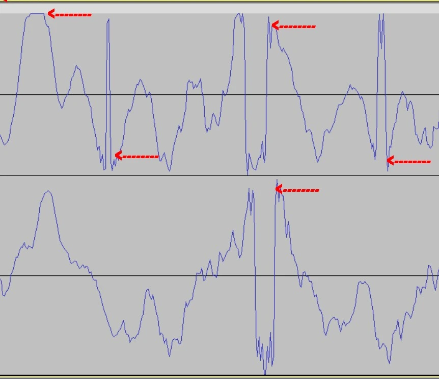

I've had crackles due to excessive level, and the waveforms look nothing like what you have. In the middle of the wave, the wave can "invert" with some AD converters, so it looks like the signal suddenly goes from 100% to -100%. It looked like this:
digital-clipping-jpg.134591
Your spikes don't look like this, and the level is miniscule compared to what I got with severe clipping. So when I say "induced" it refers to things like static, not anything in the AD/DA process. Now, the fact that it shows up with two different computers (and assuming you've used different cables) seems to rule out anything AFTER the output of the interface. Could it be something internal to the RME. Unless your computer was incredibly slow, I don't see it as being a buffer issue, and you can eliminate that by cranking up to 256 just for a test.
