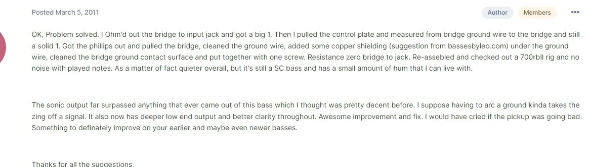

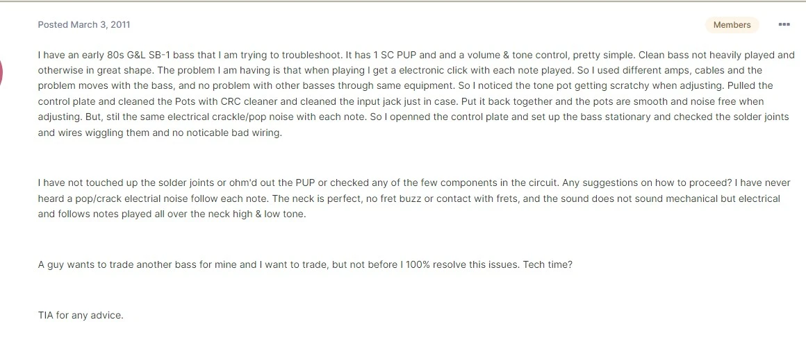

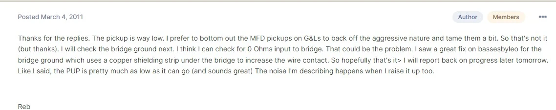

So here's a brief discussion from 2011 that is similar to my issue:
So, I might have to go get some meters and what not. I don't know anything about measuring ohms and all that. But this guy seems to have corrected the shielding basically and he had success. If anyone can kind of interpret what this guy did and add to it here, then thanks a lot.

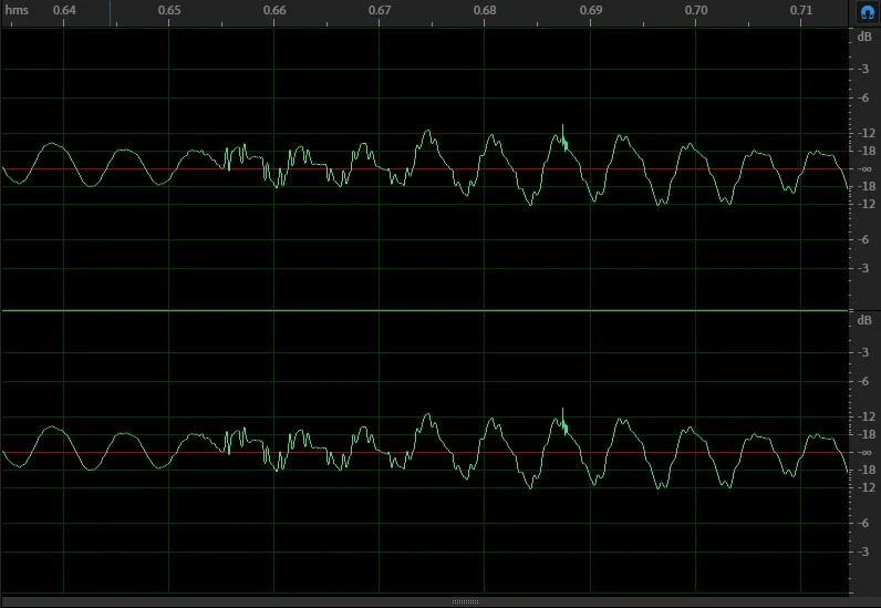

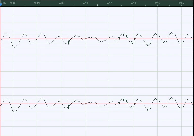

You've got a gremlin in the works. The waveform has lots of nasty little miscoding in it - the ones that line up with starts of notes are just more obvious - but they seem to be random bits of noise, or VERY steep jumps in the levels - and speakers cannot cope with these nor the electronics so the little clicks are the harmonics from the very sharp almost square wave start.
Cause wise? probably not levels, because those clips were modest in amplitude - so probably either a dodgy driver, which could always be removed or updated as a start, or a proper hardware fault - but that would be rare, I think. If you plug the DI output into some other device that would either click or not click. Not clicking points again to the AD process but if it did click, then if it's an active DI - could that be the problem? I don't think it's static, despite sounding like it - but the waveform suggests something else. If both pickups do it, discount the bass, and look for electronics.
