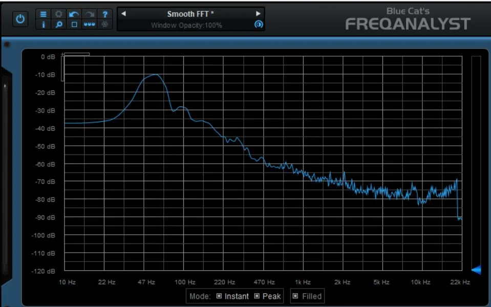

Ok, just done it. Attached is the 30Hz tone* repro'ed through my home hi fi (kept level modest but still annoyed wife!)
The analyser plot is interesting? You can easily see the 30Hz picked up by the very small speaker, 4" woofer but the third harmonic at 90Hz dominates. Whether that is my speakers distorting or the wee one acting as a microphone I cannot say, bit O both I would guess.
Still, the principle works and you can use a relatively small speaker to record very low frequencies.
The speaker BTW was plugged into my NI KA6 and the mic gain whacked to max.

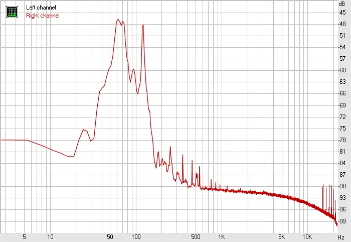

I think you've captured the sound. I looked at it both in Rightmark and in Reaper and you have large peaks at about 25hz, 60 to 70Hz, and another at about 120Hz. I could boost the rumble very easily with EQ.
It didn't seem to be modulating like a bass instrument or drum. It sounds more like a rumble from an HVAC unit. It was pretty much continuous.
Hope this is helpful.

Im nearly crying, its been a long time trying to capture something decent. I will buy way bigger speakers now to get it better. thank you for the analysis. i wont need to fork out a fortune for an Earthworks now

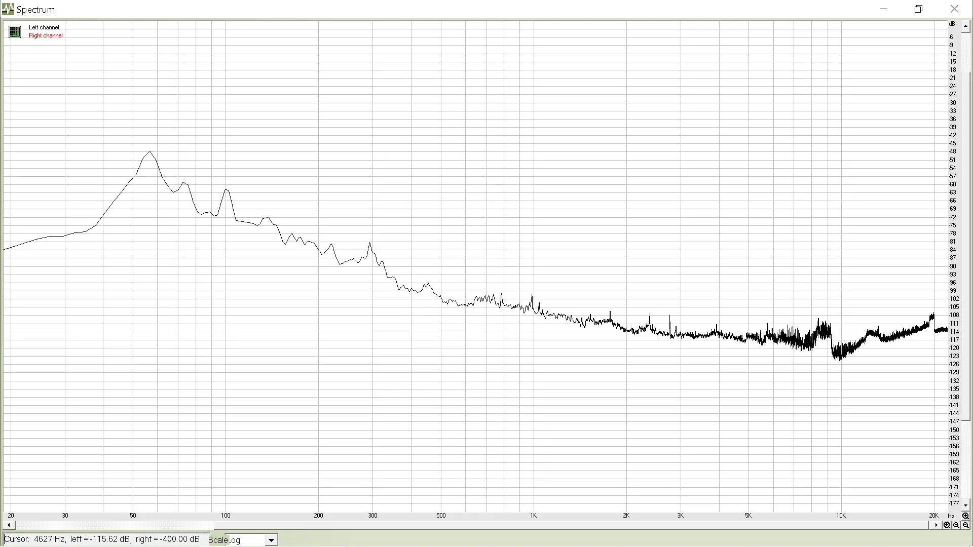

Hi Mr T, could you help me analyze mine too? I have a persisting bass noise problem from a neighbor two floors above me.
Recorded to my phone using my Sony WF-C500 wireless earphones, when I listened to the playback, the bass is very prominent.
No surrounding noise as it is a suburban apartment building and only captured the bass by placing my wireless earbud against the shared wall.
Is M4A file alright? I have no editing software to change the file type.
That is actually quite disturbing! To get an idea of the actual sound level you would need a 'c' weighted sound meter, there are several quite good ones for smart phones.
The noise seems centred on around 58Hz and is all the more annoying because it is pulsing. The lower peak at 100Hz is equipment ripple and shows you to be in 230 volt land.
What you can do about it I do not know. Nuisance noise needs to be referred to local enforcers...IF there are any!

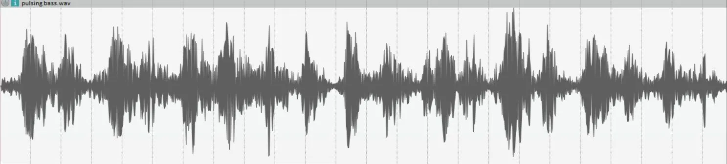

Demilios,
Here is the sound amplified, plus visual of the sound. I agree with Dave, the sound is around 50Hz, it sounds a lot like what I often hear from cars with the big subwoofers. You hear the boom... boom... boom sound hundreds of meters away.
