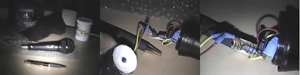

I just Finnished makeing My Second Mic today but this Time I did a few Things differently....
This time I made a Small Circuit Board to Hold the Caps and resistors and I also added a Small .0001 PF Mica Cap after the 10UF Cap so to try to reduce distortion at high Frequencies...
I also put in a Small On/Off Switch to turn off the Mic and I used a Better quality XLR Connector than the One that came with the Cheapo $3 Mic i use as a Body.....
I have It powered useing 3 x 1.5v Watch batteries which last quite a Long time and I get 10 watch Batteries for $1....
This Time I mounted the element in a Bed of Silicone to make it less sensitive to Vibrations and handling Noise and it Should make the mic a Bit more Directional as the sound comeing from the Sides and Bottom is Muffled by the Silicone......
I haven"t had a Chance to use it more than checking to see if it works which it does and it seems to have a better sound than the First mic i made as the element I am useing is a Better quality one (Panasonic WM-61B) and it is Ballanced which is cool.....

Here are some Pics of my Latest Mic:
Cheers
Here are some Pics:
I assume you mean .0001uF, which is 100pF. That's too small. It will only pass very high frequencies (something like 1mHz) and thus have no effect on audio. You want to use something in the .01uF - .1uF range.
Very good about the vibration. However that is not the way omni capsules work re: directionality. To get a directional pattern, a capsule has to let sound strike the back of the capsule to cancel out sound hitting the front. Since the Panasonic capsule isn't designed that way, it's gonna be omni pretty much no matter how it's mounted.
If you want a cardioid mic, Panasonic makes cardioid capsules.

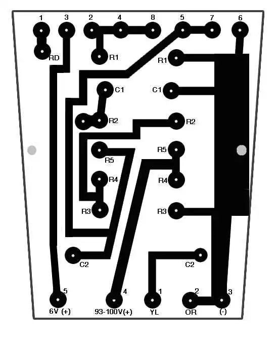

Here's my PCB layout for the Royer circuit.
