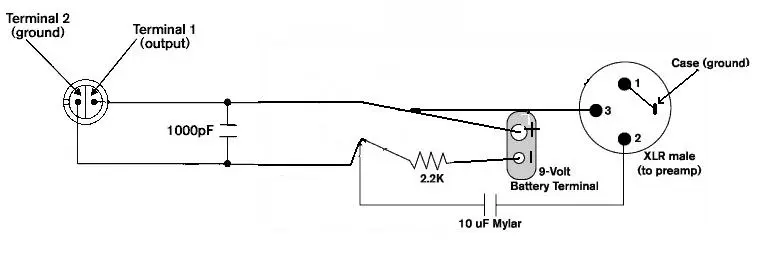

This is the Wireing that I use that deleivers a Ballanced Signal Via XLR...

Minion said:
The 10uF Caps are Pretty Small, they are about 3/4cm Tall, I"m useing Metal 10uF caps (I think aluminum) and they seem to work Fine.....
Aluminum is electrolytic. Does it look like the one in rory's pic?
Mylar is metallized poly film, the smallest one I can find in 10uF is just a little smaller than a 9V battery. In an external power supply, like the mic you built, that fits fine. Electros will absolutely work too, it's just that polys are commonly thought to have better audio response.
Anyway, I was referring to the schemo I linked, which is driven by phantom power. That cap is too big to fit in a small omni mic body, especially if using an XLR connector for the body! So I think electro is the only possible choice there.

You could also use a mica or tantalium. The only problem is that electrolytic, mica and tantalium are all inferior for audio. I think I used tants in my tape op mics and they're not tooooo bad. You'd be better off with a good large body and using mylar or film.
PhilGood said:
No, wait a minute! I remember that the 1000pF goes into the mic body, but the 10uF mylar sits in the power box, which is connected via an XLR cable to the mic. Unless you want to have them all in the same housing.
*sigh*
Yes, that works for the tape op mic. I am talking about a mod to use phantom power. Then the caps (plural, there must be at least two of them, if you don't use power supply filter caps) have to fit in the mic housing. Ain't much room inside an XLR connector, about 15mm L x 12mm D, and that would include the necessary resistors.
While it's true polys are superior, the reality of using a mic that is made from $10 in parts is that it's probably going into a preamp that has electros and plenty of 'em, and they probably aren't bypassed with small polys, etc.

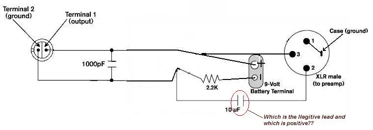

Hi, I was wondering if you of you guys could help me with a small problem I am haveing wireing up a Mic....
The problem is my Schematic doesn"t tell me which is the Negitive and the Positive lead when wireing the the 10uf Capacitor as electrolytics are Polarized and must be wired one way.....
I"m pretty new to wireing and electronix so I am still learning ....
I was thinking that since the Cap is comeing off of the Negitive lead from the Battery that i would put the negitive lead of the Cap on the left closest to the Negitive current from the battery but I don"t know if my reasoning is correct....
Can someone help me with this ??
ThanX

mshilarious said:

Right! What I'm saying is that the box for the battery in the tape op article has PLENTY room for the rest of the circuit. You just build it in there and then connect it to the capsule the same way.
Hey, PhilGood ,Do you happen to know the answer the the Question I posted above as you seem to know more about electronix than me and i"m sure it is a simple question it is the Answer I am haveing problems with??..LOL
ThanX
Positive lead of the cap should be wired to pin 2 from the mic.
Umm...Sorry But I don"t understand what you mean as it relates to the Schematic above....
Looking at the Schematic above is the Positive lead on the Left or the Right??
(That way i will understand as it relates to the schematic)
ThanX
PS:Sorry for sounding stupid!! :(
To the left. Remember the stripe is on the drain (negative) side of the cap!
OK..Great, I"m glad I asked Cuz I though it was the other way arround because the wire that the cap goes on to is connected to the Negitive lead from the Battery so I though that the Negitive lead from the Cap should be closest to the Negitive Power lead from the Battery but I guess my Reasoning is flawed...I really appriciate the Help.... ;)
